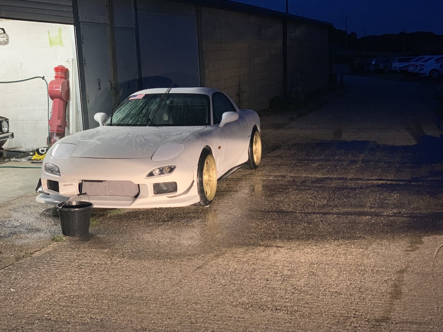

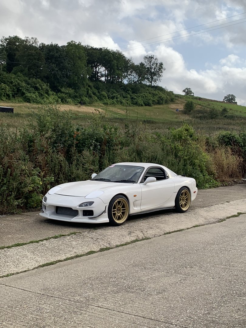

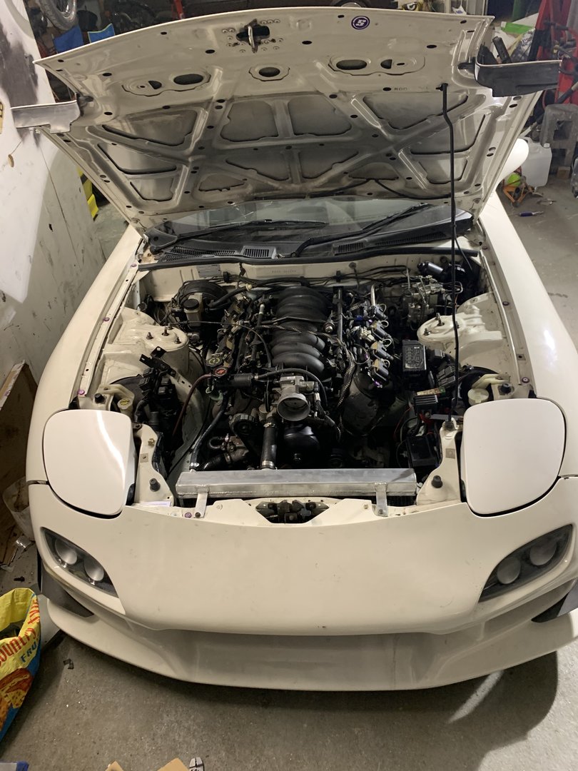

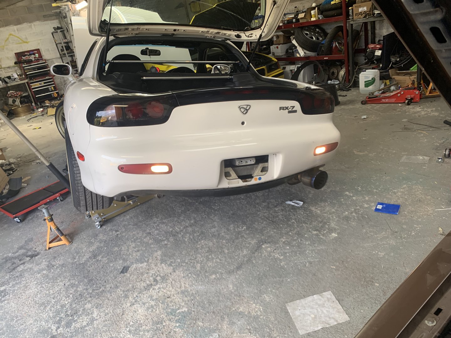

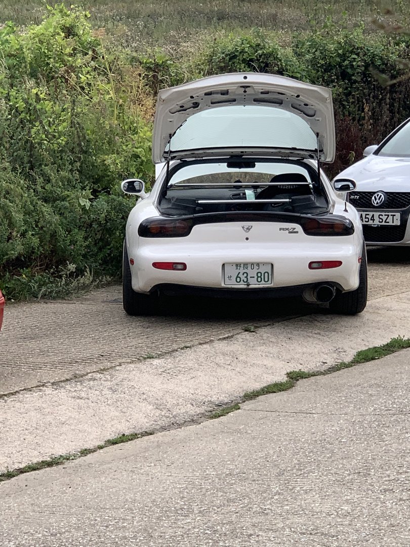

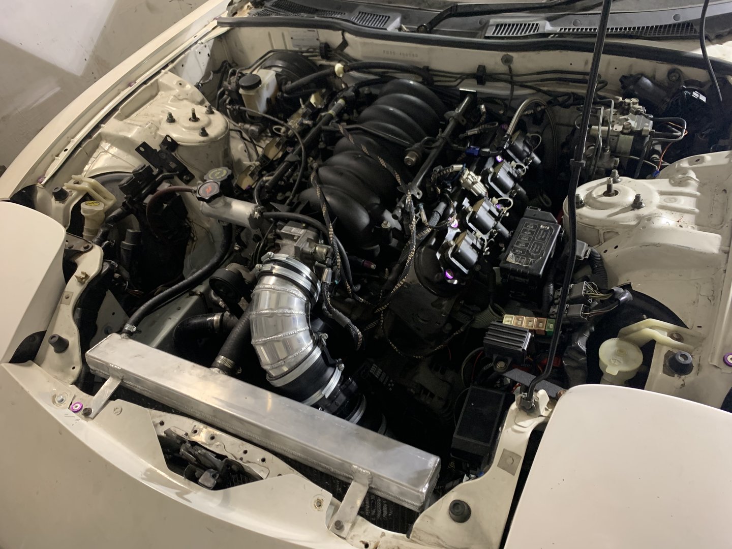

So today I got to drive my dream for the first time

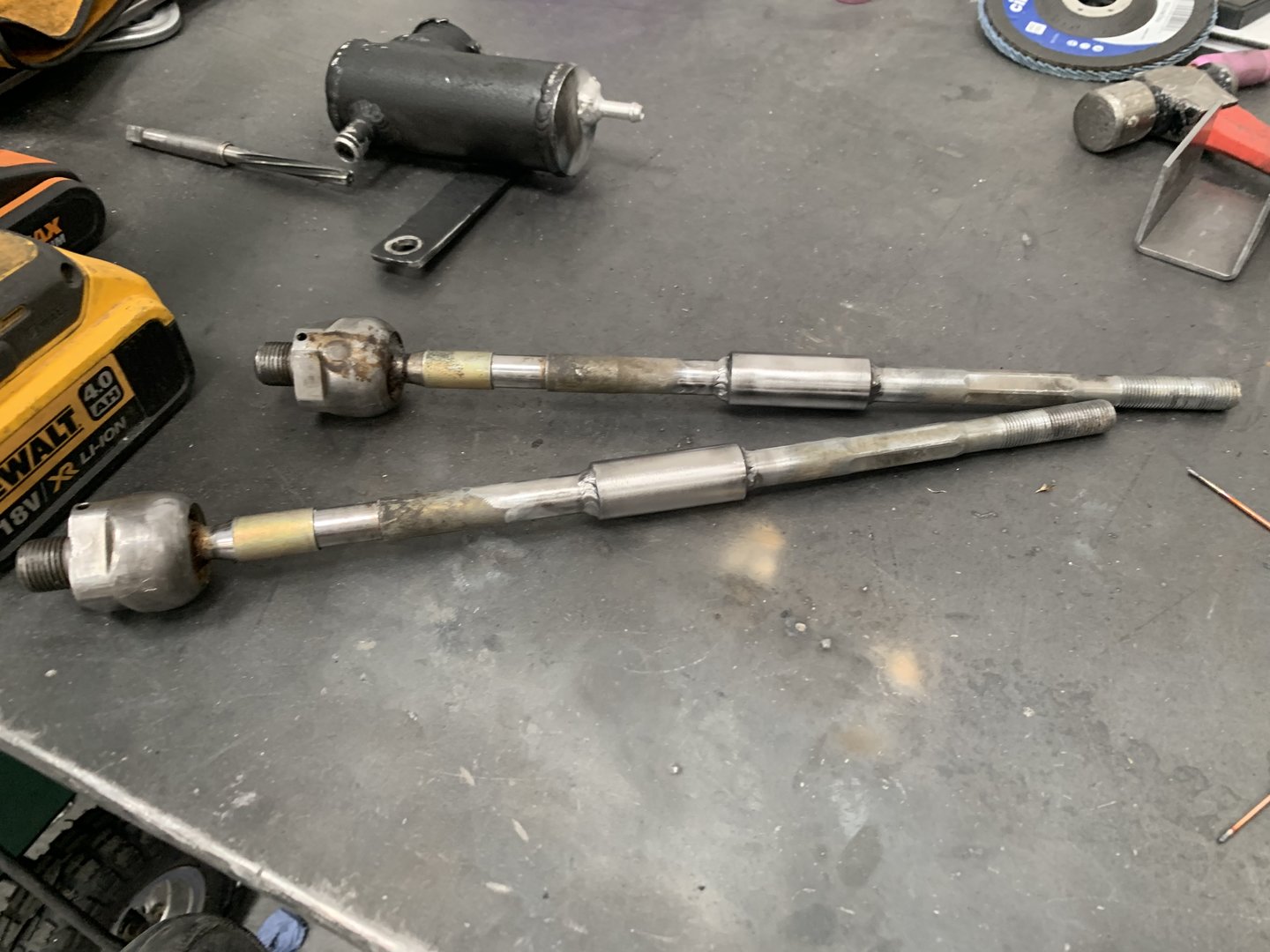

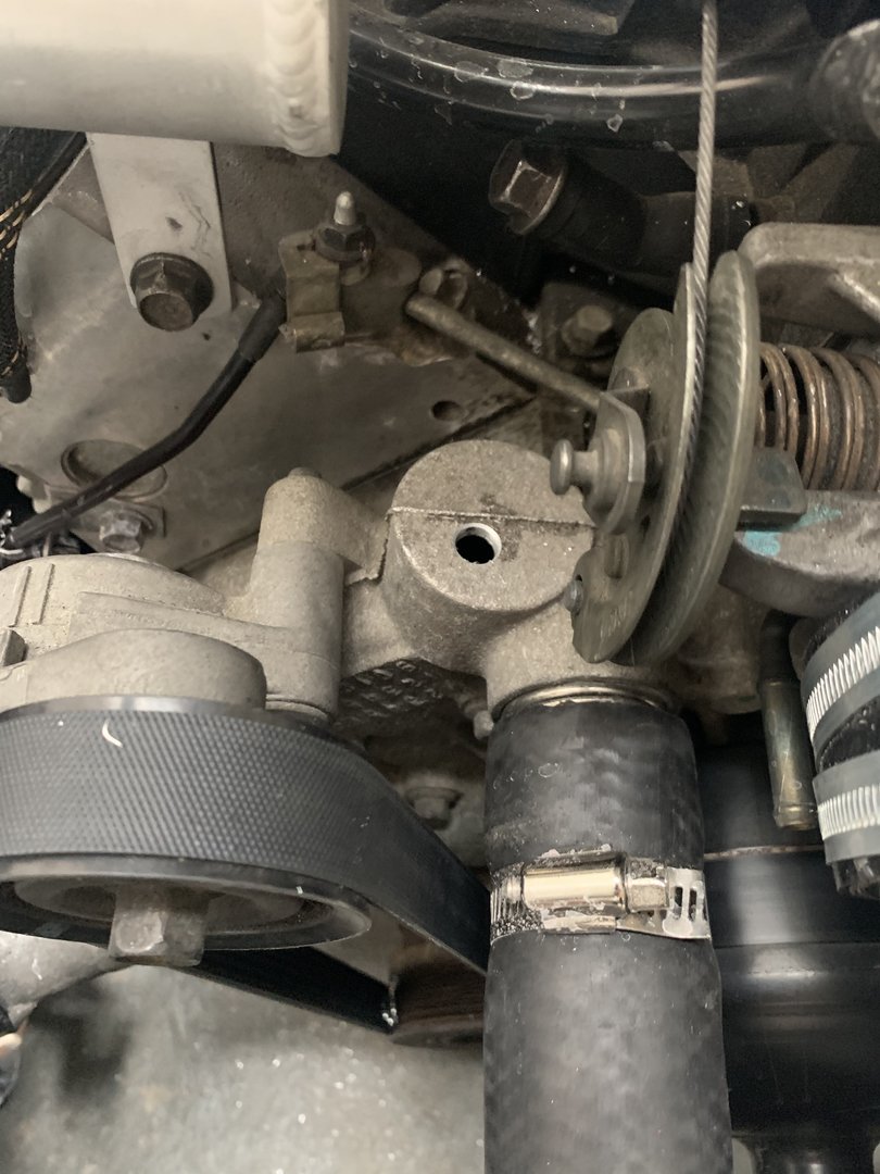

Spent the morning extending the tie rods and adding a steam vent to the header tank

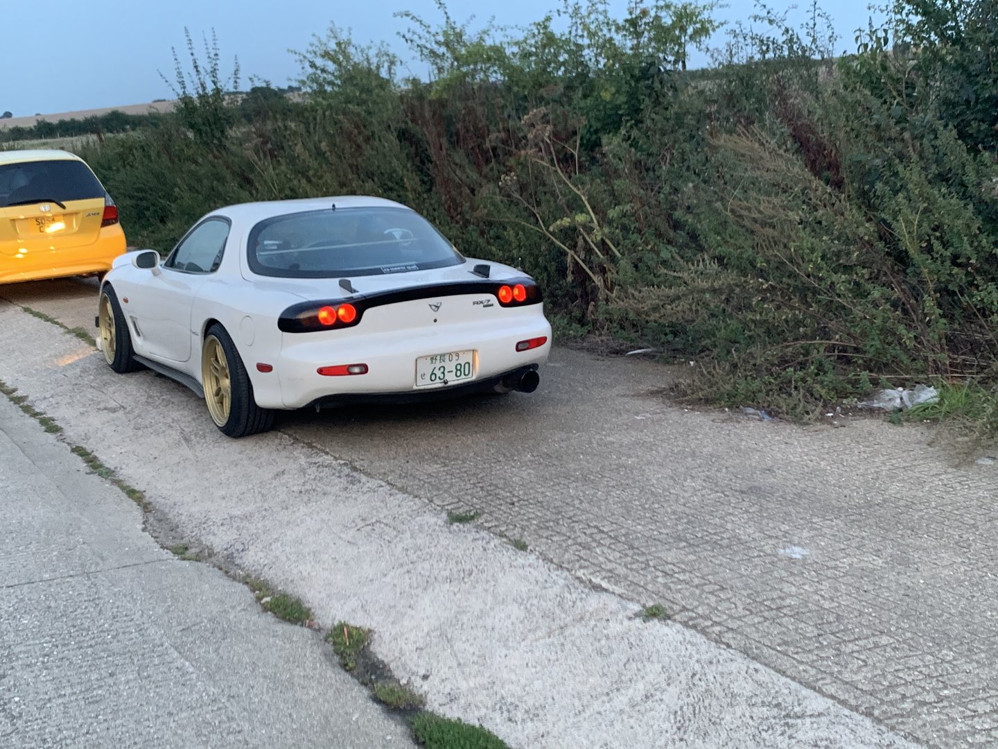

Drove up and down the farm that my workshop is on, over the moon that it actually works

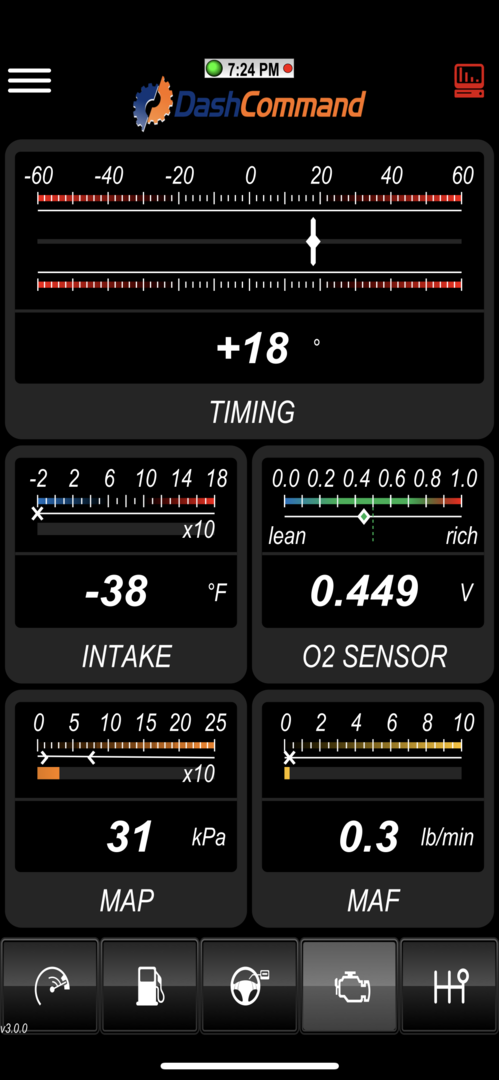

No maf on currently so it doesn’t like revving over 3k ish but it really has some torque down low
Also had it cut out because in my wisdom I put a 5amp fuse in for the coil packs and it blew
Still loads to do but the main milestone has been reached
