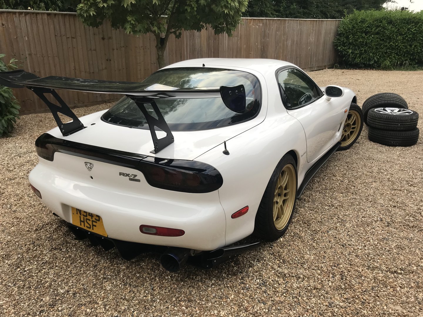

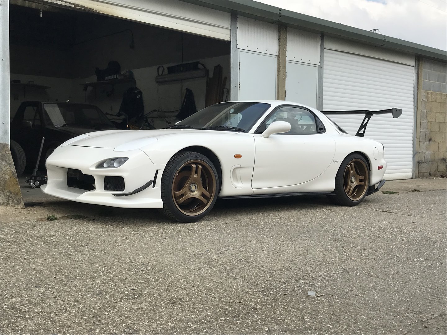

This is my '96 Fds3 type r
After dreaming about owning an rx7 for years i finally managed to find one recently up near standstead
The car has only done 29k kilometres and was imported last year
Unfortunatly the previous owner blew the motor and couldn’t afford to fix it so sold the engine and box (hence the flinstone title)
Once it was delivered I put my favourite wheels on, the super Advan Sa3r Also I’ve removed the wing
Plans are to get the holes in the boot closed up and re painted

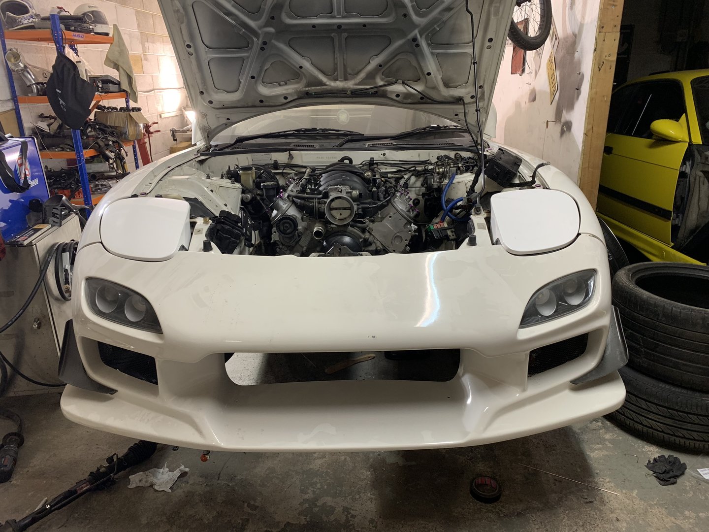

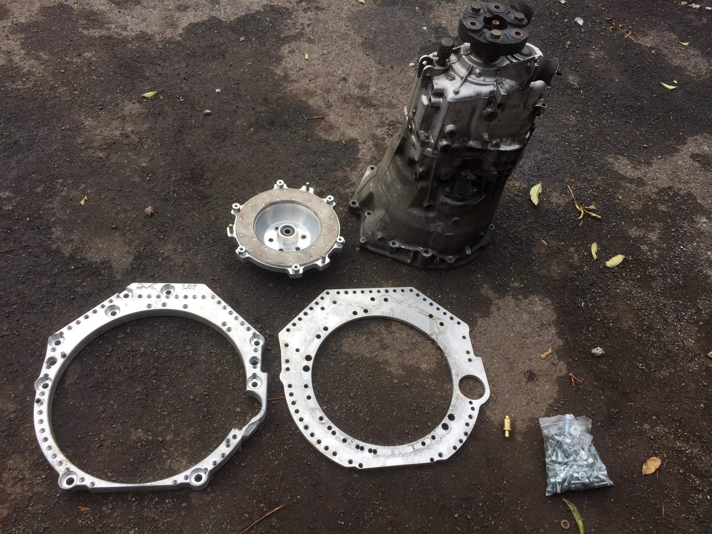

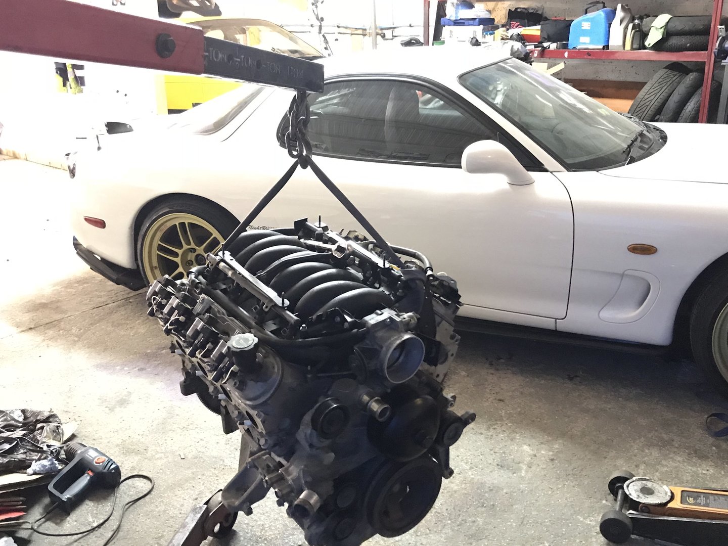

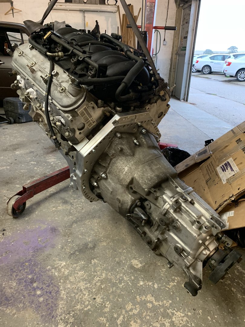

After a few months of weighing up options I came across a 5.7 ls1 on Facebook marketplace for a decent price so went for it
On first trial fit absolutely nothing fitted
But I’ve been whittling away at it

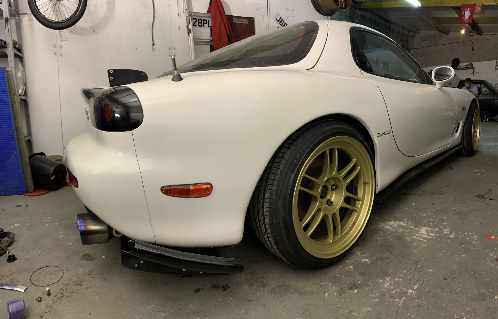

Managed to find a set of 18x9.5 et15 enkei rpf1’s on eBay for a bargain so replaced the Advans with those

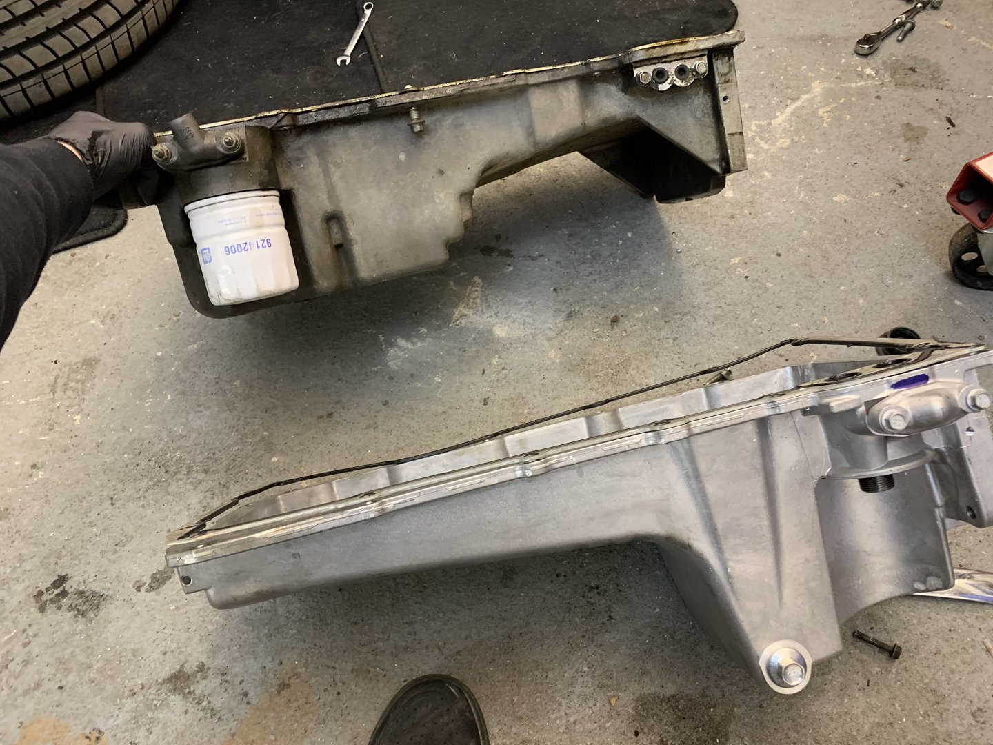

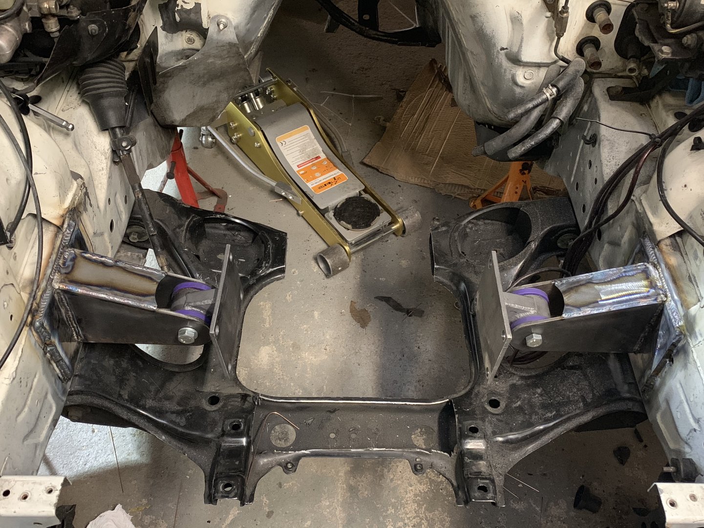

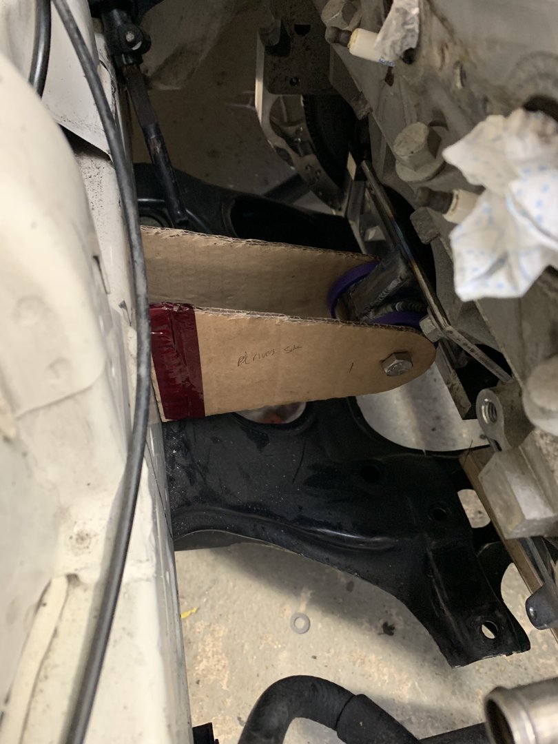

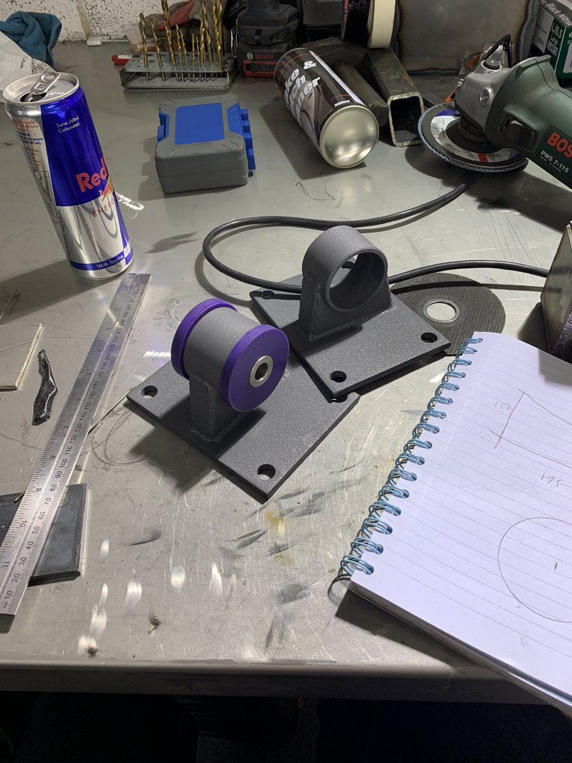

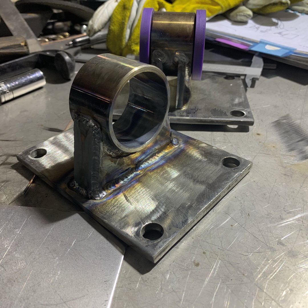

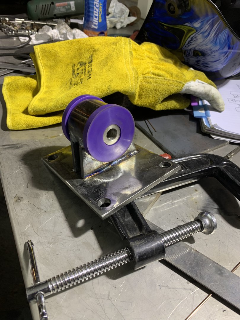

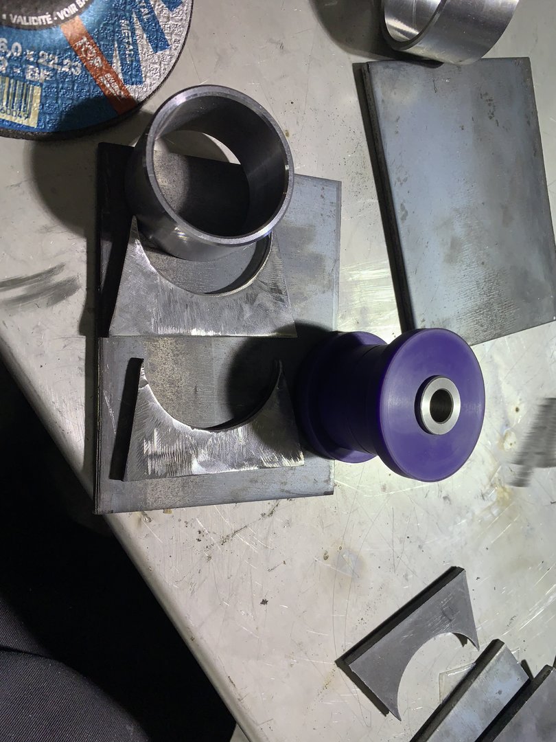

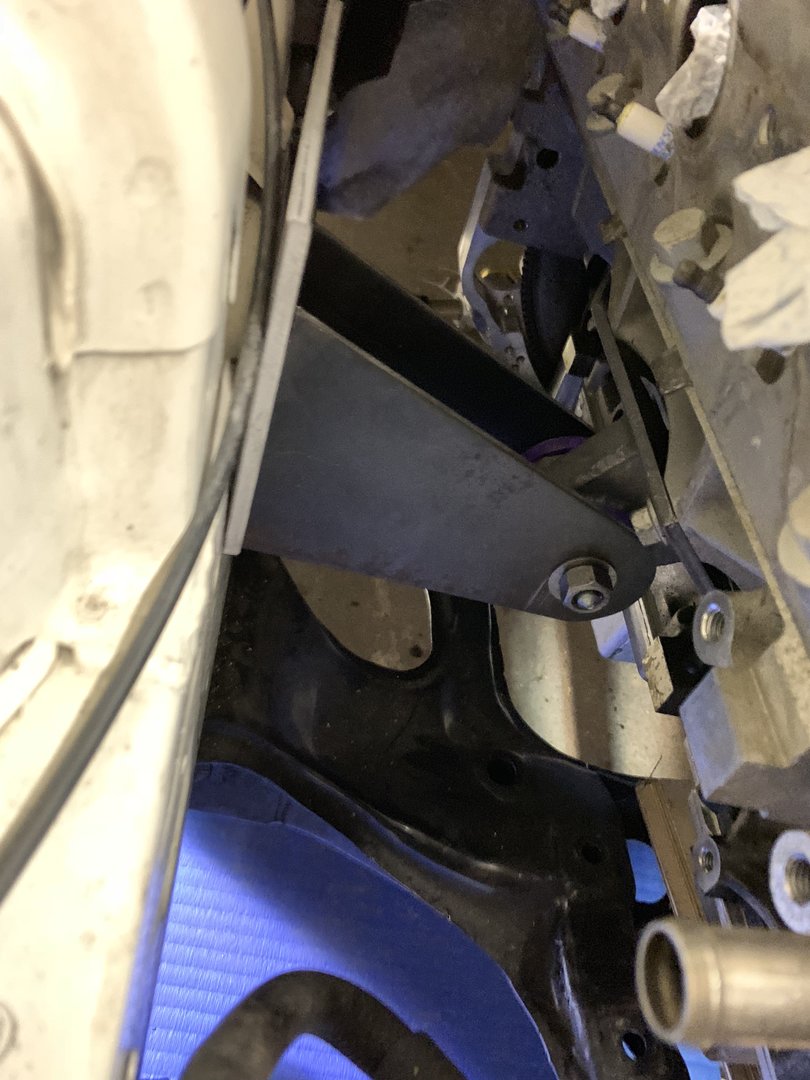

I didn’t fancy spending 2k+ on an swap subframe kit so made up some mounts using bmw e28 powerflex bushes and mounted to the chassis rail to help further down the line
The new sump clears the subframe but the steering rack is a rather large issue, having the engine mounted to the rails will allow me to make up a new subframe lowering the rack with some bump steer correction tie rod ends
But state of play now is the engines mounted gearbox mounts in the works and most importantly the bonnet closes
