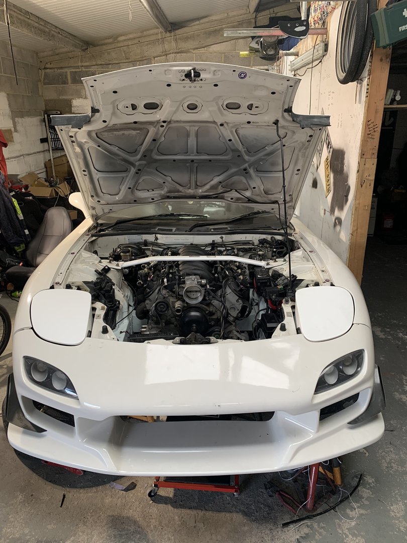

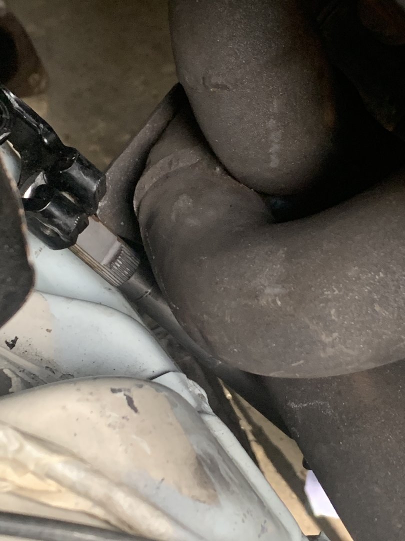

Tried the y pipe on today and really happy with the fit the header flange is hitting my steering Uj so that will need addressing
Flipped the top uj and now the steering intermediate shaft clears the headers :D

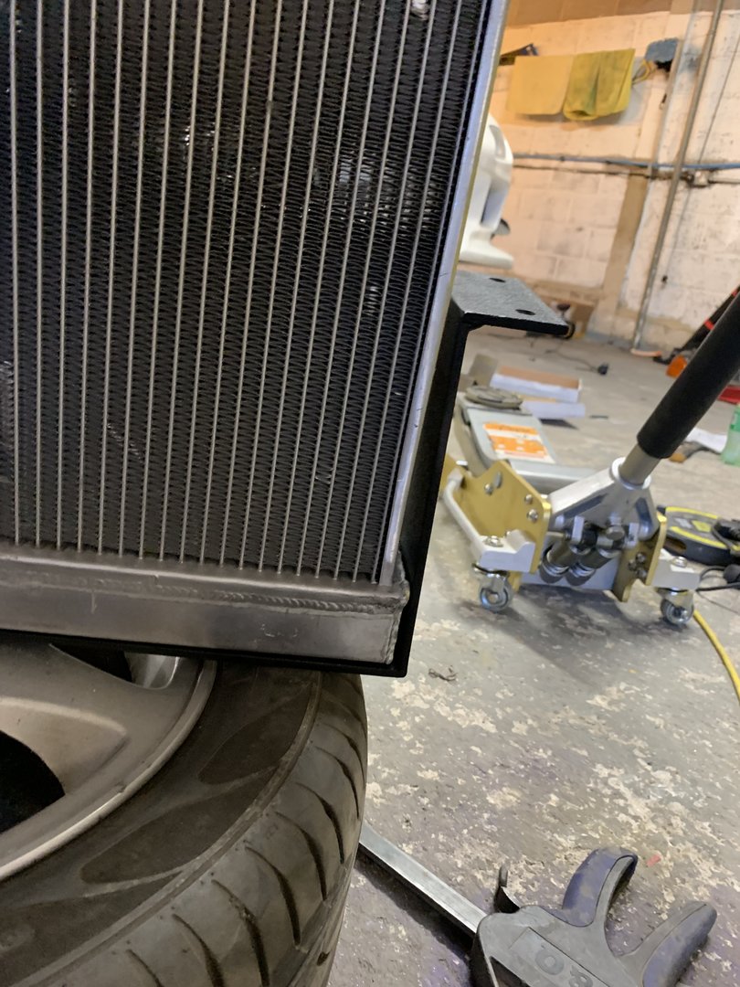

I’m using a Japspeed 3” core rad off my old supra

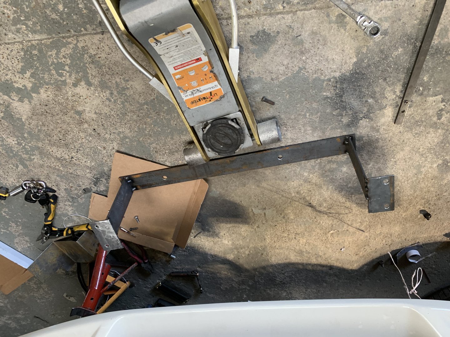

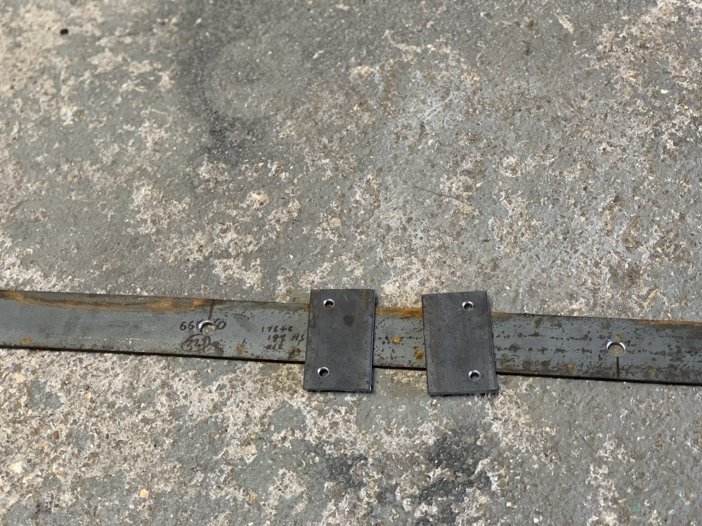

Mocked up one side mount for the bottom of the rad and will make the other tomorrow I’m thinking of just having a bit of flat steel for the radiator to sit on with bends either side to mount to the chassis rail

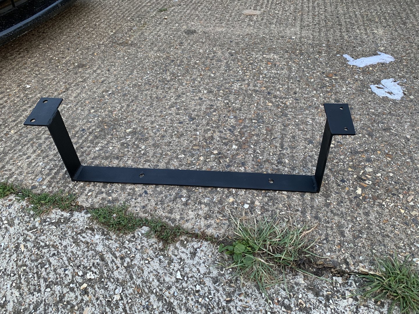

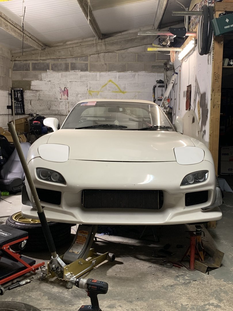

Spent the very hot evening working on the radiator mounting
Happy with how it turned out mounted to the chassis rail which strangely had m6 threaded holes passenger side and m10 drivers side
Need to sort some mounts for the top to hold it in place

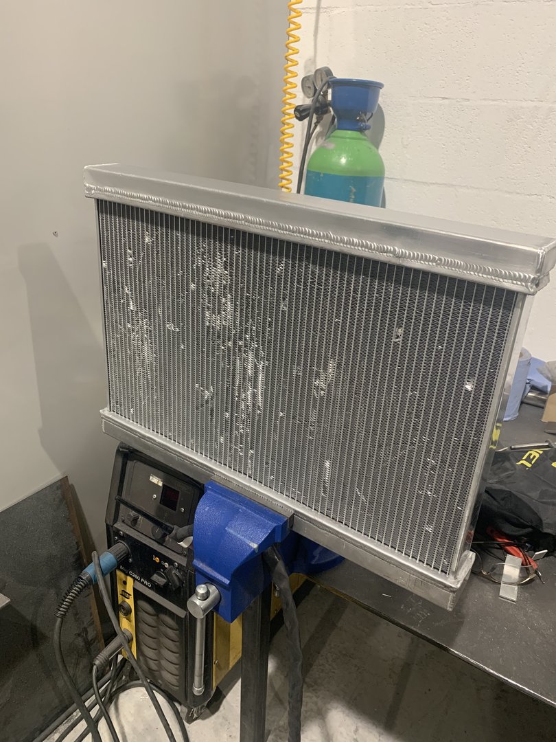

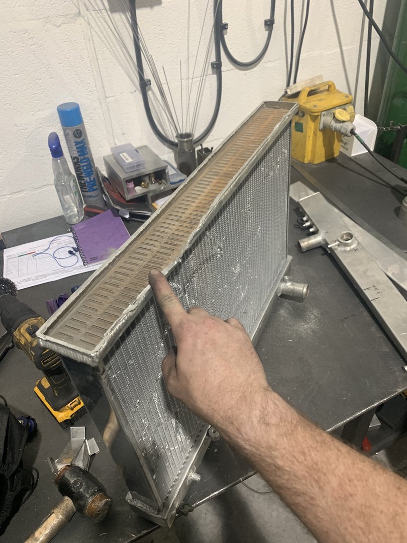

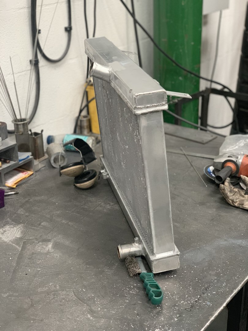

Started on the rad this evening

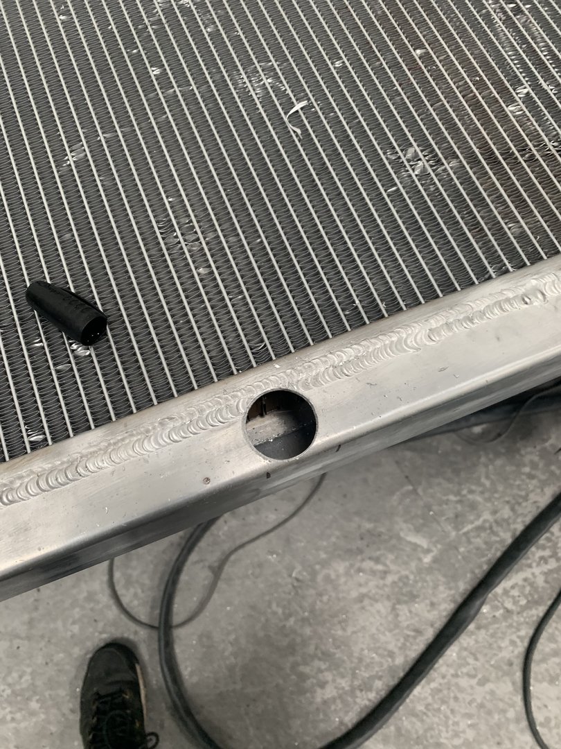

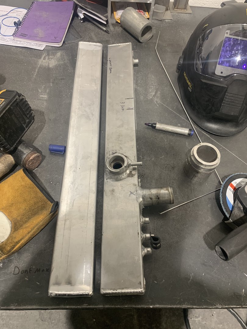

Made a new top tank to delete the old ports and got it welded on need to add the 33mm tube for the coolant still but happy with the results
I never get a chance to ally weld so it’s not amazing but learned a lot doing it

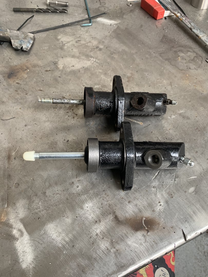

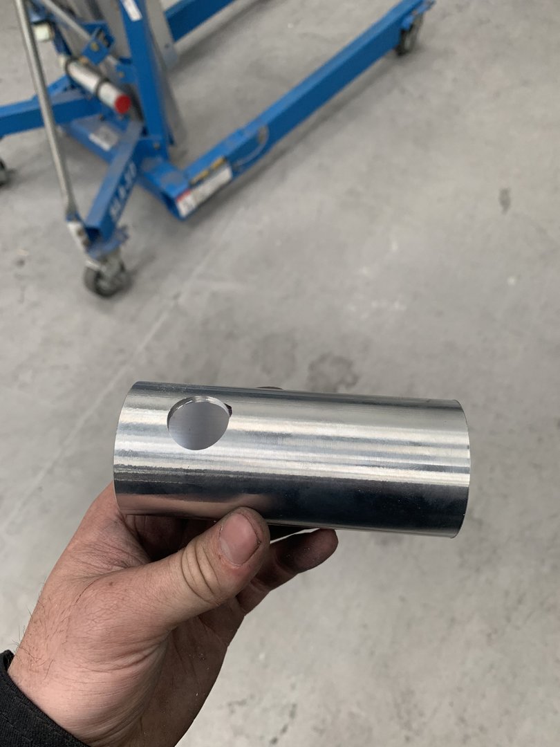

Also got to the bottom of my clutch issue today
I couldn’t get a decent pedal even with lots of bleeding, I was worried it was that the clutch master couldn’t move enough fluid for the bmw slave cylinder but replaced the slave today and that didn’t help so I turned up a 30mm extention for the slave cylinder rod and that done the trick now it dis-engages

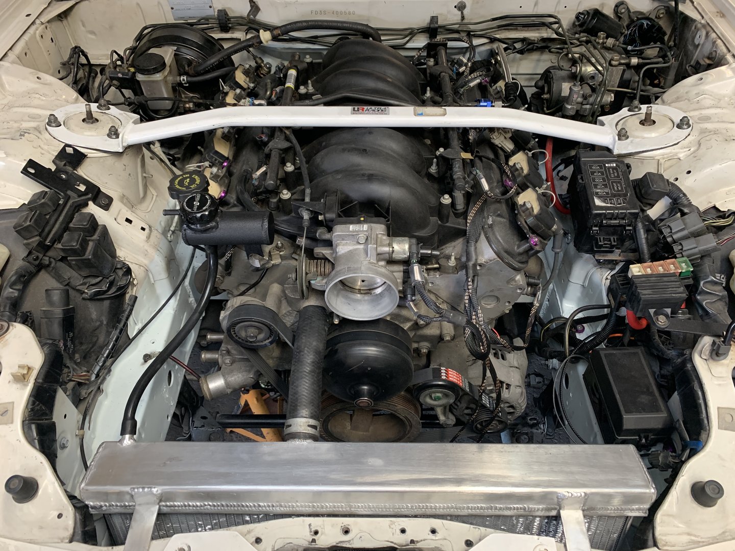

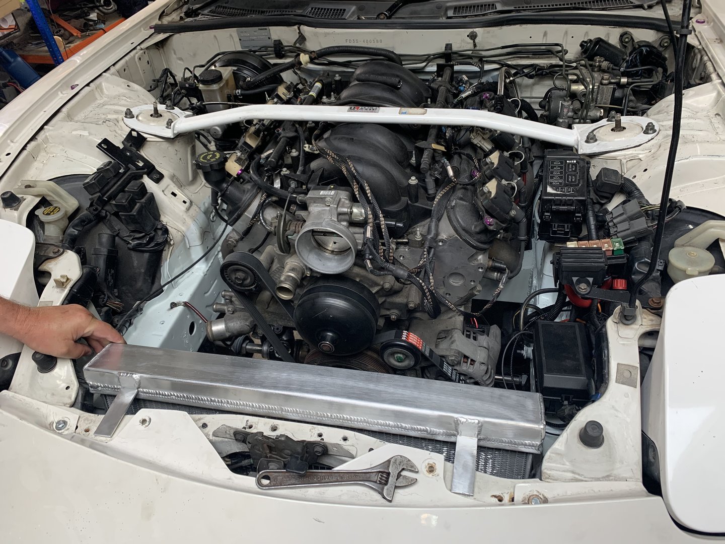

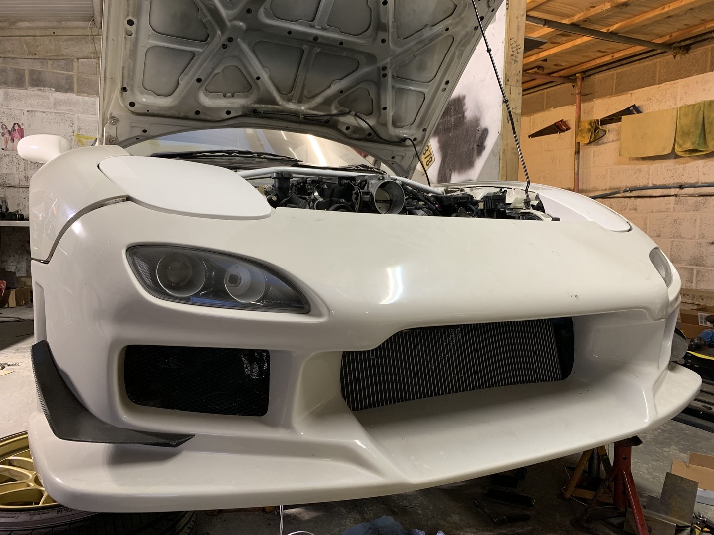

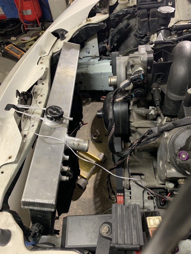

Offered up the radiator quickly this morning and looks like it’s gonna sit lovely
Looks a lot cleaner without the filling cap

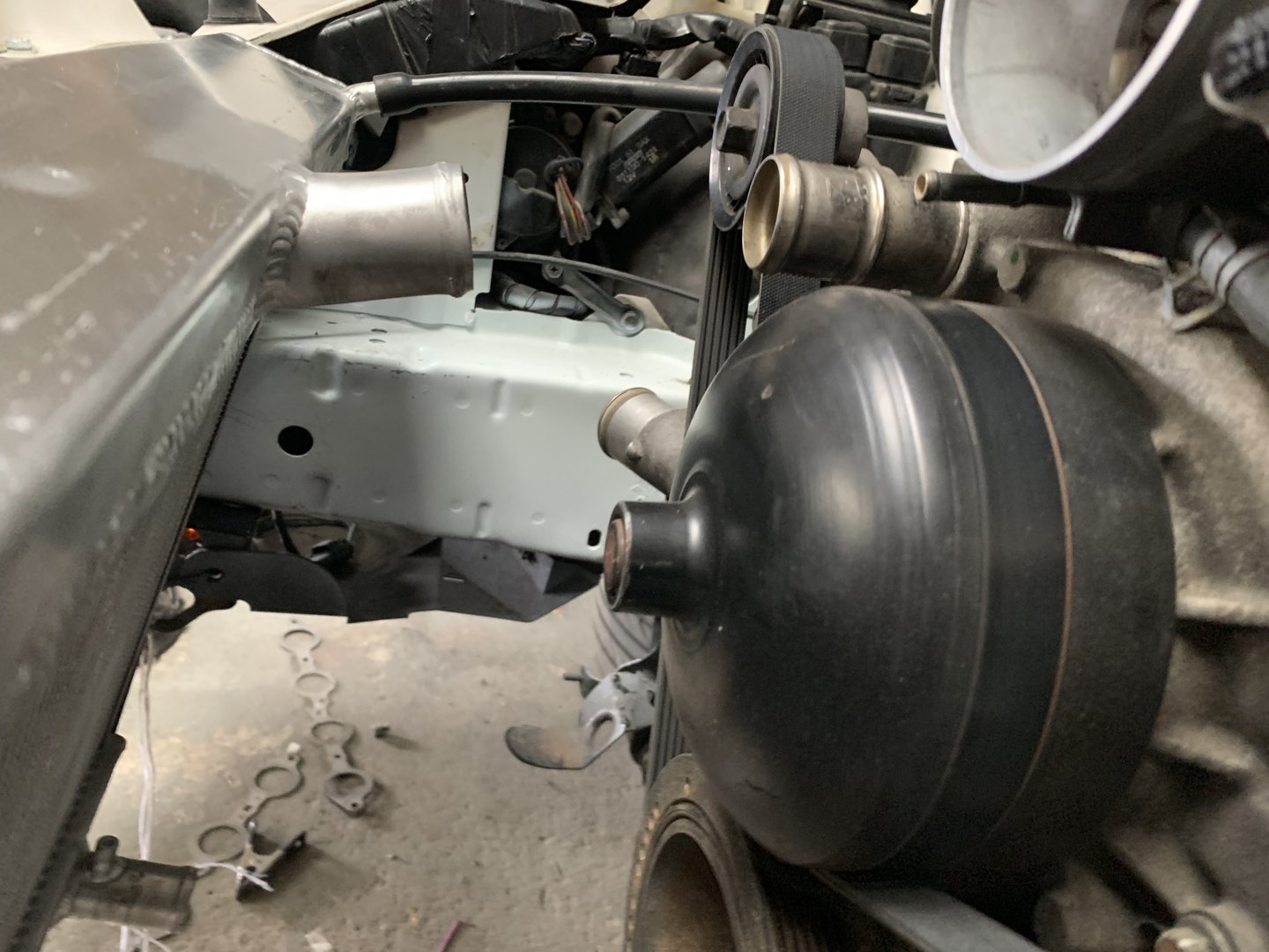

Still need to weld a port in for the coolant return

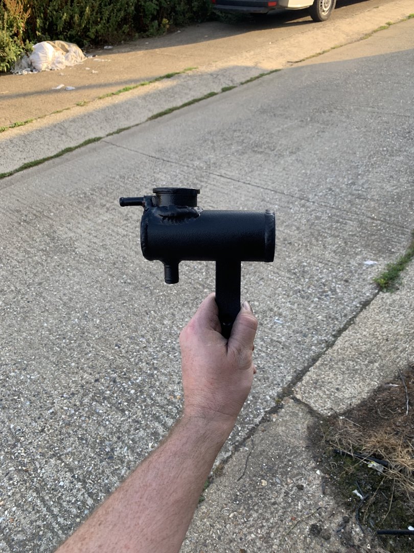

But got some time to finish off the radiator today
Welded on the top return and a port for a header tank
Took inspiration from the Samberg header tank and recycled the fill point that was on the radiator to begin with
All bolted in and gave the header tank a lick of paint, happy with the results
