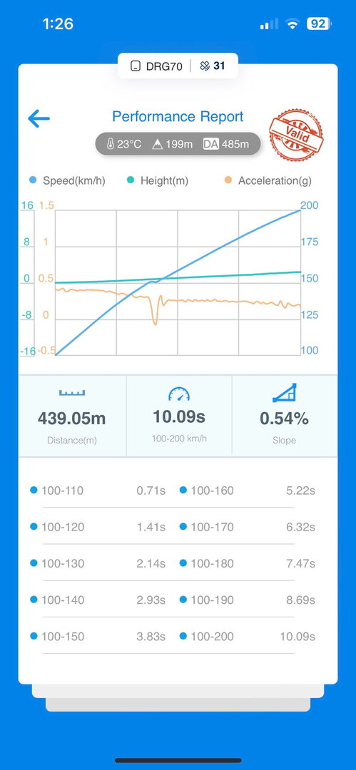

Great to see you got on the 100-200 kph runs right away and stayed flat through out.
Had to be done... I wanted to see where the car was at and you can't beat dragy for that. I know there are a couple in the US with similar setups and decent power, but I haven't seen any dragy results to confirm!
Agreed, its a cruel mistress, the draggy. You either hit the numbers you expect or you dont.
For e.g. your 11.10s run was faster than my E92 M3 V8 by a few tenths! Goes to show even the stock setup is good enough if overall reliability wasn't an issue.

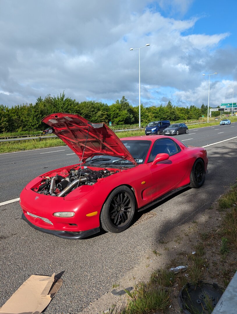

The FD blew up...
TL;DR going for a rebuild, maybe modern ECU, maybe bigger turbo if the kitty allows.
The long story:

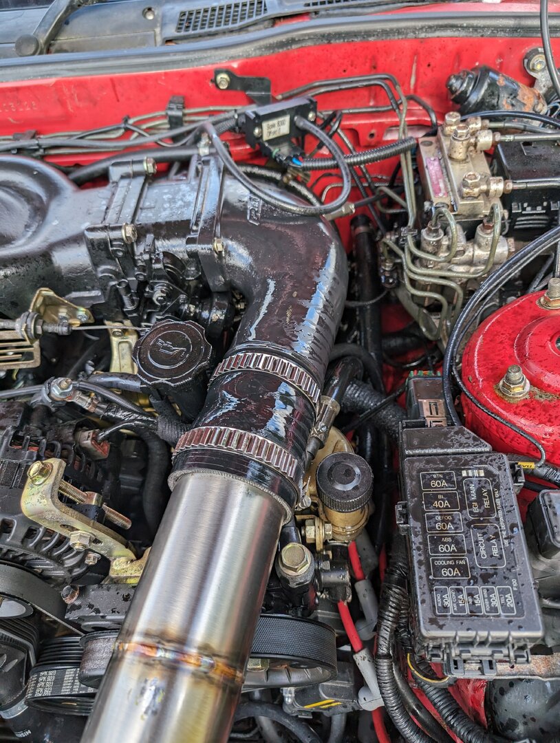

I hadn't driven the FD a huge amount after summer last year, and just as winter came I started having strange boost problems... I saw/ heard a boost warning from the controller and noticed a peak of 1.4 bar... I reset the peak and kept an eye on it, but noticed every time I attempted to build some boost, it pretty much wacked straight up to the boost warning of 1.2 bar. It did this the second the turbo started to spool whilst I was testing in 1st, 2nd & 3rd (backed off straight after hearing the warning). Changed to low boost and it essentially behaved like it used to in high boost, however the spiking got progressively worse until the point where I ran it with the controller off/ at spring pressure (no issues here from testing before).
We had run a boost leak test previously (no leaks) and I put a new boost solenoid on - thinking it might have gone, but it still played up... I gave Marco a message and he suggested dropping the duty, I dropped high and low by 10% each which seemed to have cured the issue. Although after driving the car more often, I noticed the same thing happening again in high boost, at which point I drove around in low boost (1.05 bar peak here). I decided to take the FD on the motorway to work, as I broke my other 2 cars... Filled it up the night before, gave it a little boost in 2nd and all was well. I remember climbing a hill in 2nd, probably about 1/4 throttle and the car had an odd hesitation - thought nothing of it as it drove absolutely fine home from then. Got to the motorway the morning after, poodling fine until I gave it a pull in 3rd, after which the car started running a little rough (felt like the plugs were fouled). I revved it out a touch and it didn't get any better, drove a few more miles and it got worse. My clever self gave it a limiter bash at this point, where 1 rotor cleary failed, oil everywhere and exhaust noises were coming from unexpected places :ROFLMAO:.

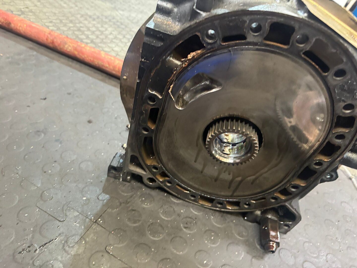

Since then it has gone over to Josh and the guys at TPS, the front rotor is dead as it shat a corner seal (part of it actually lodged my wastegate open which is where the noises were coming from). Damaged rotor of course, and potentially turbo damage... I've decided to go for a rebuild, I'm also tempted to go for a modern ECU with some failsafes and possibly stepping up turbo size - TBC. Looking at the plugs it has detonated, and we know what has let go, but I would love to know why! Time will tell hopefully :)

The error leading to failure is likely not a single event, but a series of issues that culminated in engine failure. Here's what i got from your story:
  • Boost Spiking: The car was experiencing uncontrollable boost spikes, exceeding the safe limit even with a new boost solenoid.
  • To compensate for the spiking, you switched to low boost mode and reduced duty cycle, which initially seemed to resolve the issue but the issues came back meaning the real boost spike issue was never identified.
  • Hesitation and Rough Running: Later, the engine hesitated and ran rough, potentially due to fouled plugs but more likely due to detonation because of boost spikes. This was a Major red flag and should have meant no more boost and a deeper dive to trouble shoot the issues. Perhaps new plugs, drop the oil and inspect or even a compression test.
  • Limiter Bash: In an attempt to clear the issue, you used the boost and WOT to bounce off the rev limiter which likely put excessive stress on the already compromised engine and was the final nail in the coffin.

Yes that is a fair summary! The boost spiking issue was never truly rectified and ultimately the cause. I suppose in hindsight I should have stopped driving quicker when it started running rough on the motorway, and I know the limiter bash wasn't a great idea lol.
I don't know if the engine was studded or balanced when built, I did try to get some info from Stu a few years ago when I bought the car but didn't hear back at the time. Will be going through the new build with Josh/ TPS in the next few days.

The first few months after rebuilding I kept chasing this boost control problem. I threw everything I knew at it with the ECU, changing settings and remapping, but nothing worked. Seriously frustrating! Turned out, it was a stupid kinked boost line coming off the waste-gate. Such a small thing caused such a big headache. I later changed all boost lines to reinforced silicone hoses instead of the crappy soft silicone hoses i had on prior.
Seriously thought don't underestimate the little stuff. Also, dyno tunes can be deceiving. If your AITs (air intake temperatures) are climbing crazy high on the dyno (over 40 degrees), there's a good chance your boost control is set up for those hot conditions. Out on the road, with no heat soak from the dyno, your AITs will be way cooler, closer to ambient temperature. That can lead to major overboosting issues If you don't have a closed-loop system. With modern ECU's life is easier as you can log and review what is going on in real time. Allowing you to diagnose the problems with surgical precision. I bet you have no actual ECU data to know what was really going on?

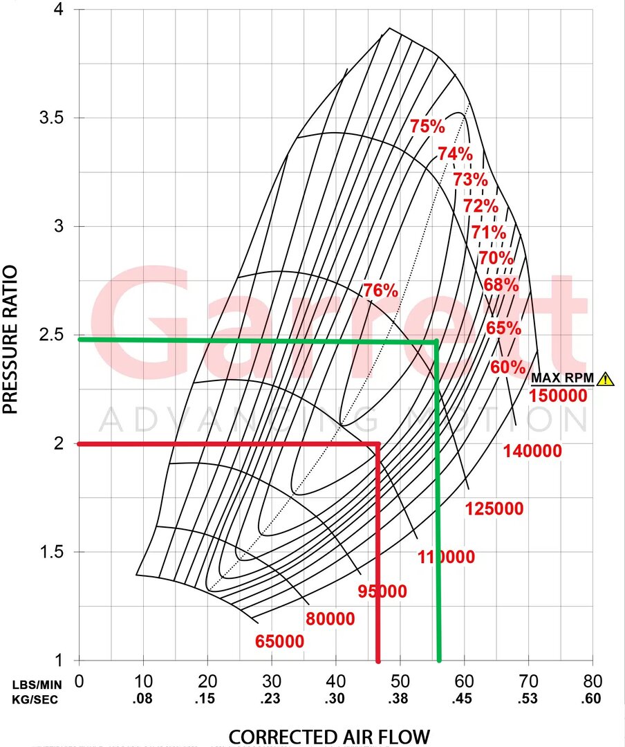

Way out of my depth here, but pinching some data from some of the US guys, with some calculation help from ChatGPT and other limiting factors aside, 1.4 bar boost should have got me somewhere near 500 hp. The red line is approximately what it delivered before:

Yes def get those sensors connected to the ECU.
Collette's S15 13b streetport with a G35 900 made 522hp at 1.9bar on E85. The G-series turbos more efficient at higher boost, so you might have to crank it up to 1.7bar to see what the baby G30-770 can really do on the 13b. If like before you are limited to only 1bar than you know the turbo is too small or perhaps still have an unresolved boost issue.
I just watched that video - impressive!
Heard back from Midland Turbos... My G30-770 is the same size externally as the G35-900 - the only difference is the machining internally. They are able to source the the G35 compressor wheel, turbine wheel and machine to fit. I'm likely going to go ahead with that!

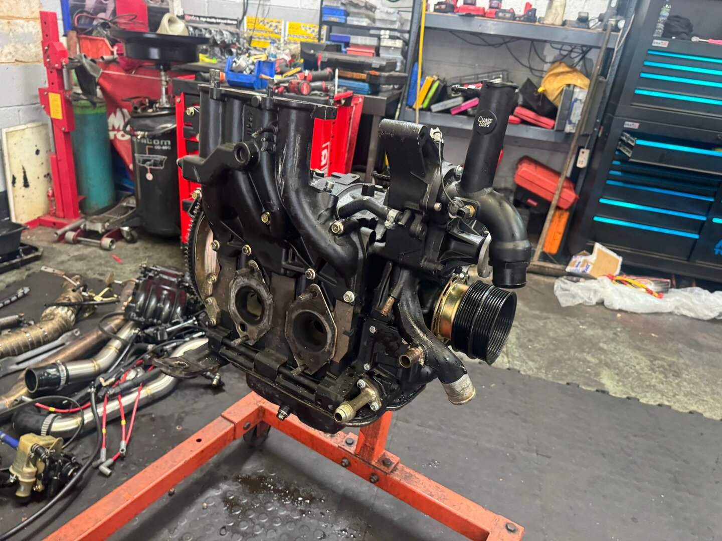

So over the last few weeks the engine came out and got stripped. Everything has been sent off for machining and I also went for balancing and a stud kit. Injectors have been sent off for flow testing and the turbo is currently with Midland Turbos for a rebuild + G35 conversion.
The ECU has also been ordered... Went for the Haltech Elite 1500 and will be adding a boost solenoid, CAN lambda kit with NTK sensor, then a couple of dual function pressure/ temp sensors for fuel and oil. Planning to utilise direct fire on the Haltech too. Still need to do a bit more reading up, but I think I'll be able to ditch the factory O2 sensor and fuel temp sensor.
I really liked the PFC commander, and have been searching high and low for neat, low-lag display options. I found BTI gauges (over CAN), and got curious about their boost control feature over analogue outputs. We exchanged a few messages and it turns out they are releasing a firmware update in a few weeks to their 3.5" display, that will enable their device to emulate Haltech CAN devices (4 configurable outputs over Haltech CAN). Which will allow me to change boost levels and I'd like to eventually use it for arming rolling-launch. Leaving 2 spare for enabling data-logging or flat shift perhaps. Drakelore do a column pod for the display too!
The car is back with me now, I'll be getting rid of the PFC, 3x AEM gauges and my boost controller at some point - these will be for sale soon!
Slow progress but we're getting there...
Over the last few months we've had the turbo back from Midland, engine bits back from Colum (additionally went for clearanced rotors), ECU bits and the new gauge setup. I didn't wait until Black Friday for the ECU bits as I thought I'd be waiting less time for everything to be back - so the savings I could have had are making me heave, but it is what it is :ROFLMAO:
The block should be assembled by the end of the month, and hopefully the car back together by the end of Jan. Umming and ahing about porting though, 75% sure on large street but I am being tempted by a set of half-bridged lapped irons that have become available. Realistically it's not needed at all for my power goal, but braps?????
