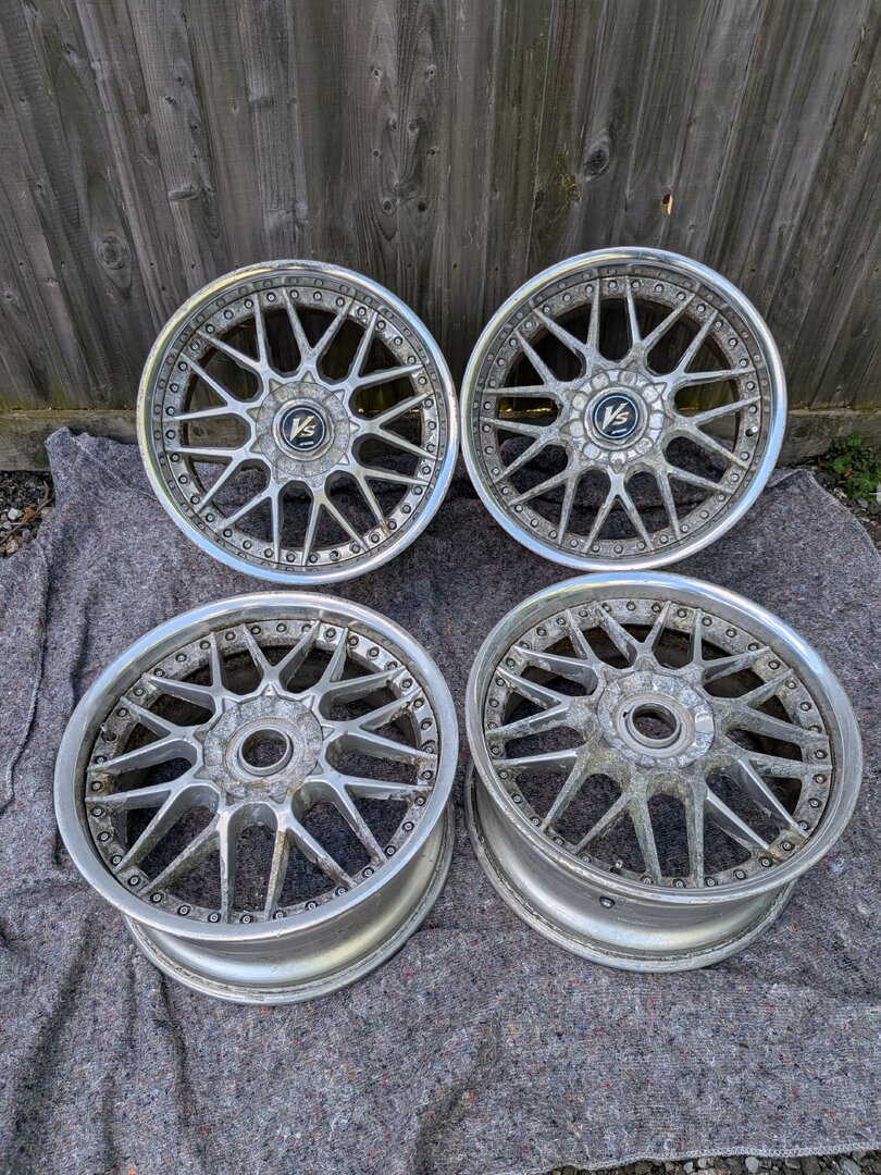

I've never really liked the wheels that came on the car... Picked up a set of wheels the other day!

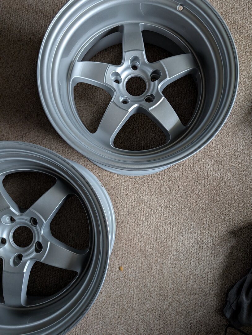

I can't afford to drop 3k on the wheels I want, so "reps" will do for now. Another set of 7Twenty wheels, the car is currently on Style 14 18x9.5 +22 and these are Style 49 18x9.5 +15. The rears should be perfect on a 255 tyre, the fronts might be interesting to fit!
You won't fit those on a standard arch
9.5 + 30 is a tight fit with a minor flare id prefer +35
Your +15 are sticking out another 15mm
Will need either (or a combination)
Aggressive flare
Crazy camber
Stretch tyres
New bigger arches
I'll give it a go! My arches are rolled flat - current fronts are 9.5 +22 on a 225, know someone running 9.5 +10 also on a 225. My rears are 9.5 +22 on a 255, I have a good finger width space which should take up the 7mm difference nicely. So we'll see! If not we'll make them fit, or they'll be up for sale :ROFLMAO:

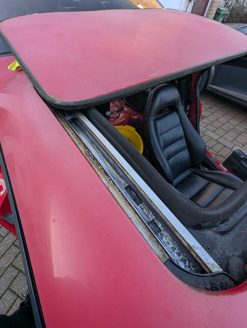

Sunroof

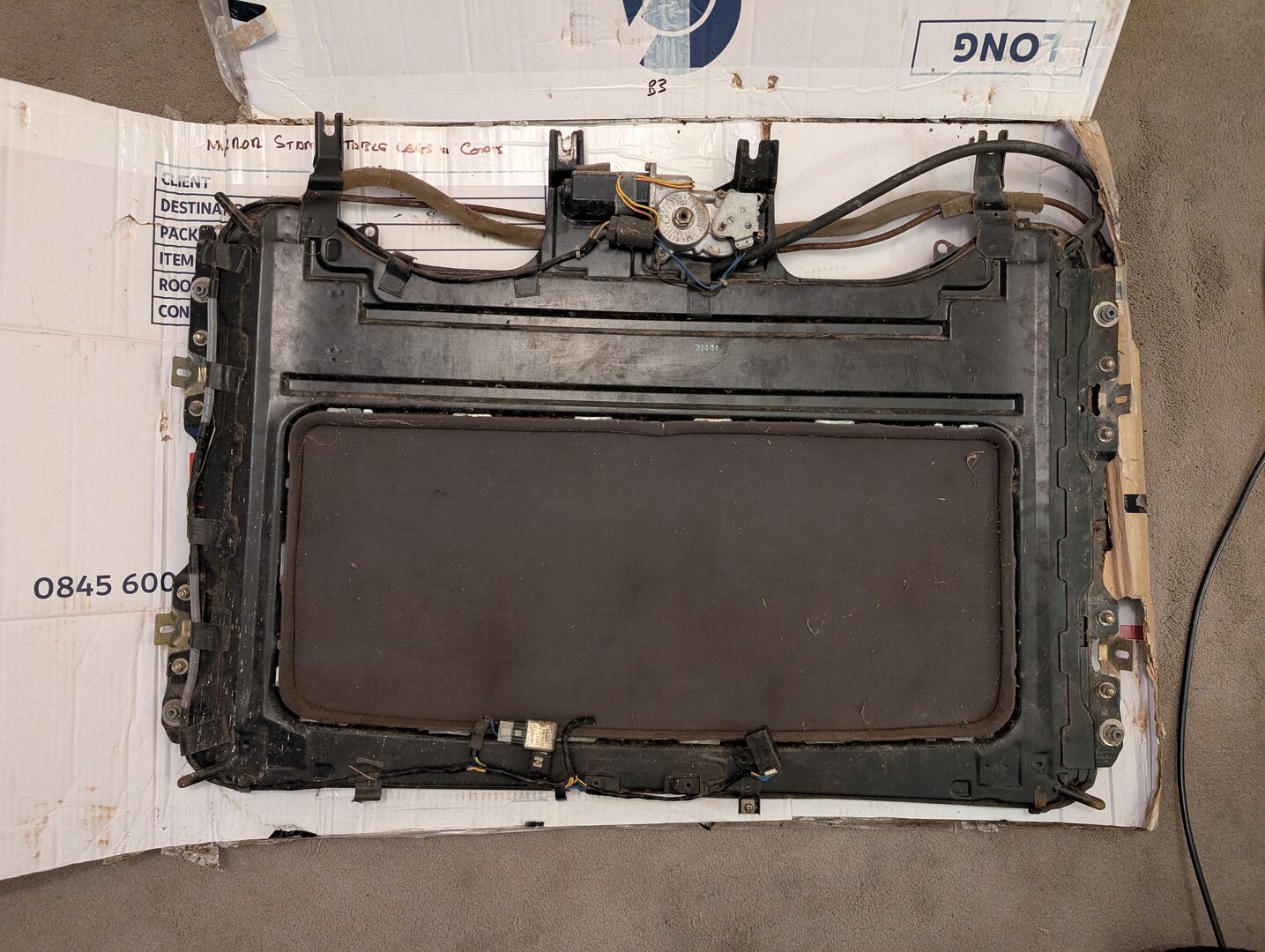

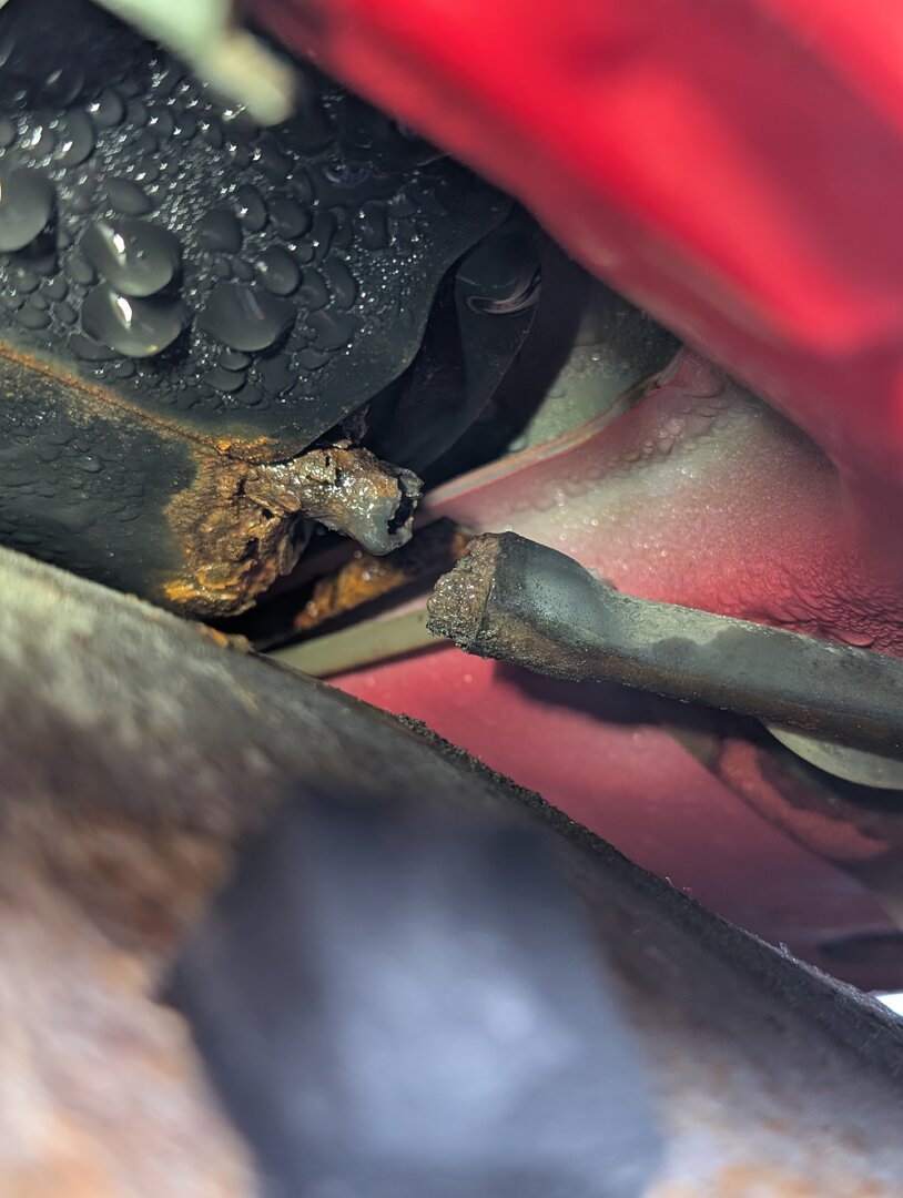

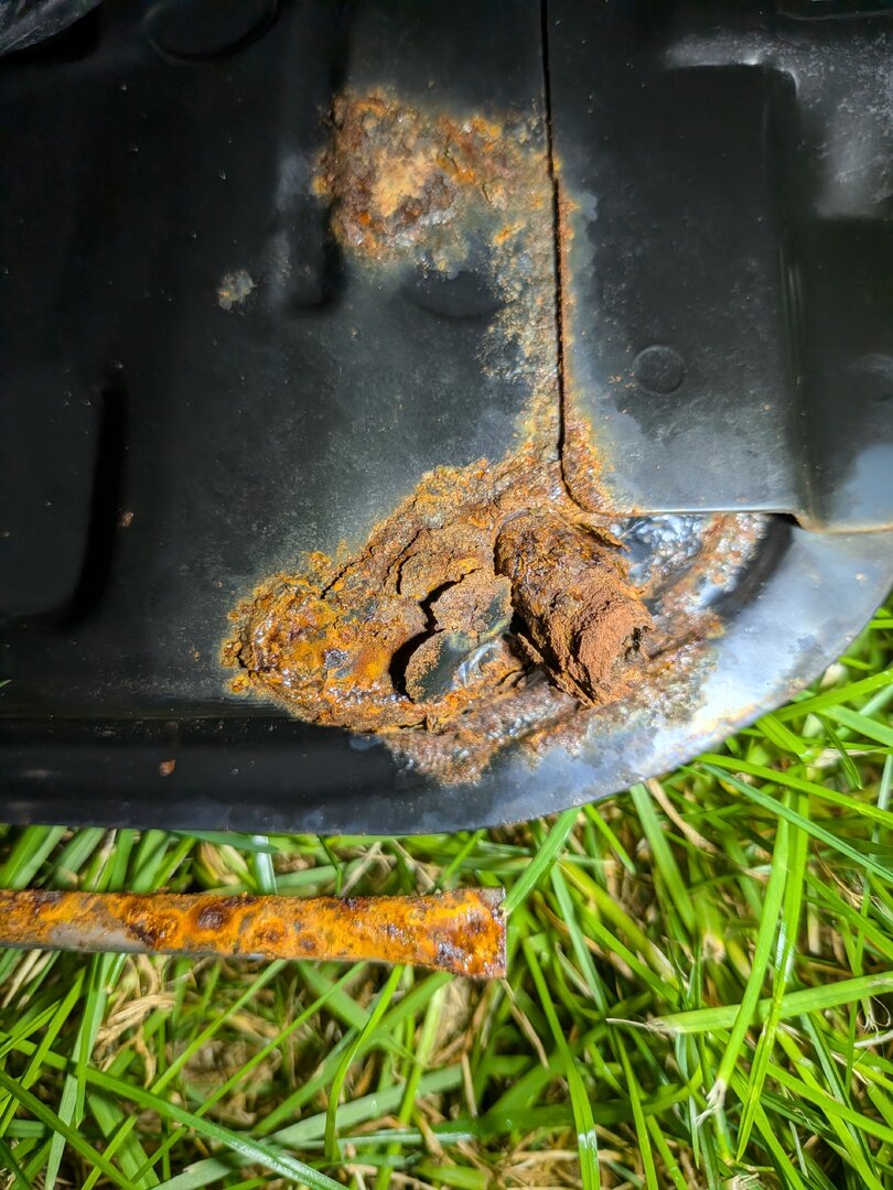

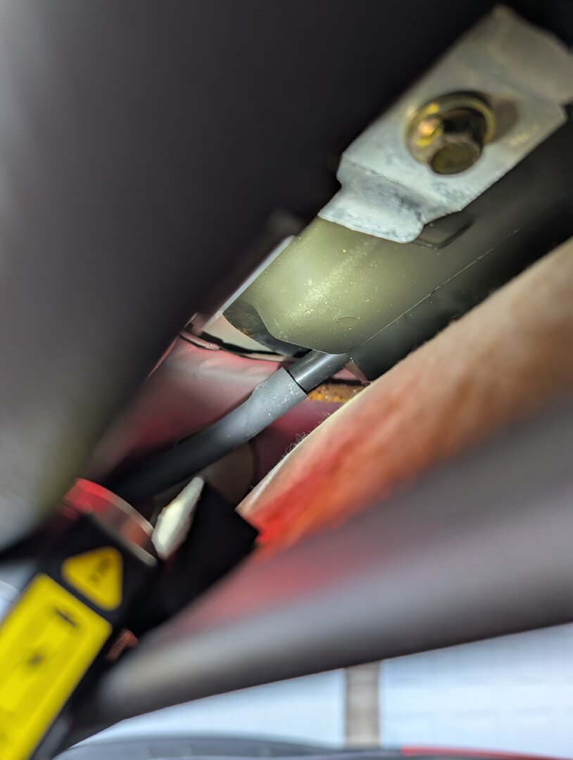

I still have water getting in and found the issue. Replaced the sunroof seal as it was knackered and upon doing a bit more digging, found the drain bucket thing is very knackered. I've probably got no chance finding an affordable replacement, so I think I'll have to get the unit out for repair at some point - for now it's dry days only!
Not fussed about leaving the car under a cover, it needs paint anyway, and it’s better than water coming in. In a sick way, I quite like patina.
Rusty rear drain, and non-rusty rear drain for comparison:

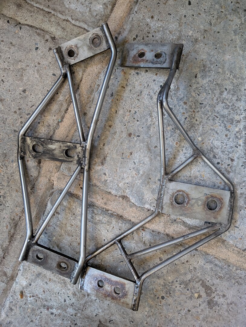

Picked up a trans and diff brace set from a chap fairly local to me, won't be putting these on yet though as I want to do bushes all around first.

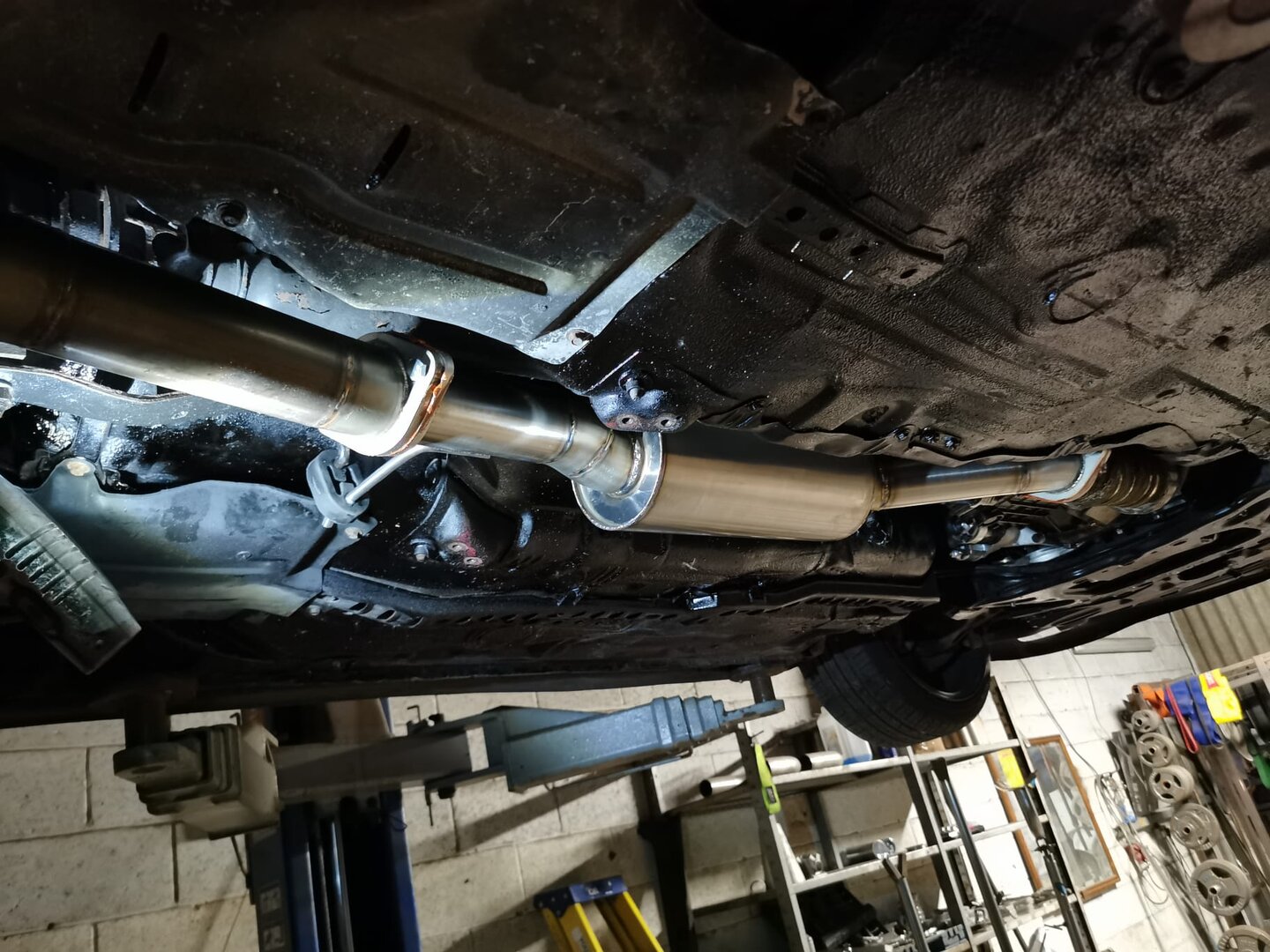

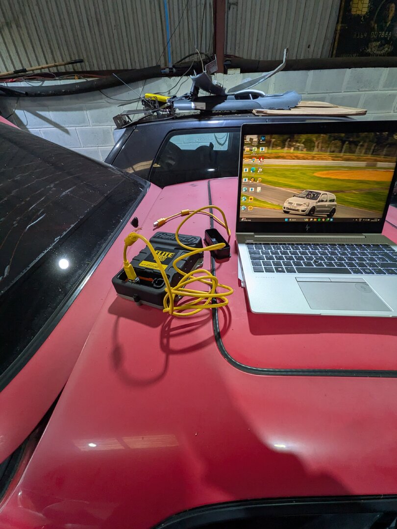

The 7 is booked to go to TPS in a couple of weeks, so I'm hoping we'll be able to get it running in Feb. Spoken to Marco who has said to use the Haltech single turbo base map for start up and running in with a 4k limit. Also spoken to SAS and he'll be putting a 6" box in my mid pipe for quietness, as I really don't want an obnoxious idle!

Sunroof
RX7 people are so nice, a chap on Facebook offered out his sunroof before he chucked it away, and ended up posting it to me which will cure my leak! The lid is pretty finished, but the bucket itself is more than usable, so I'll clean up and swap my lid + motor over when I have the car back. Thank you Martin!

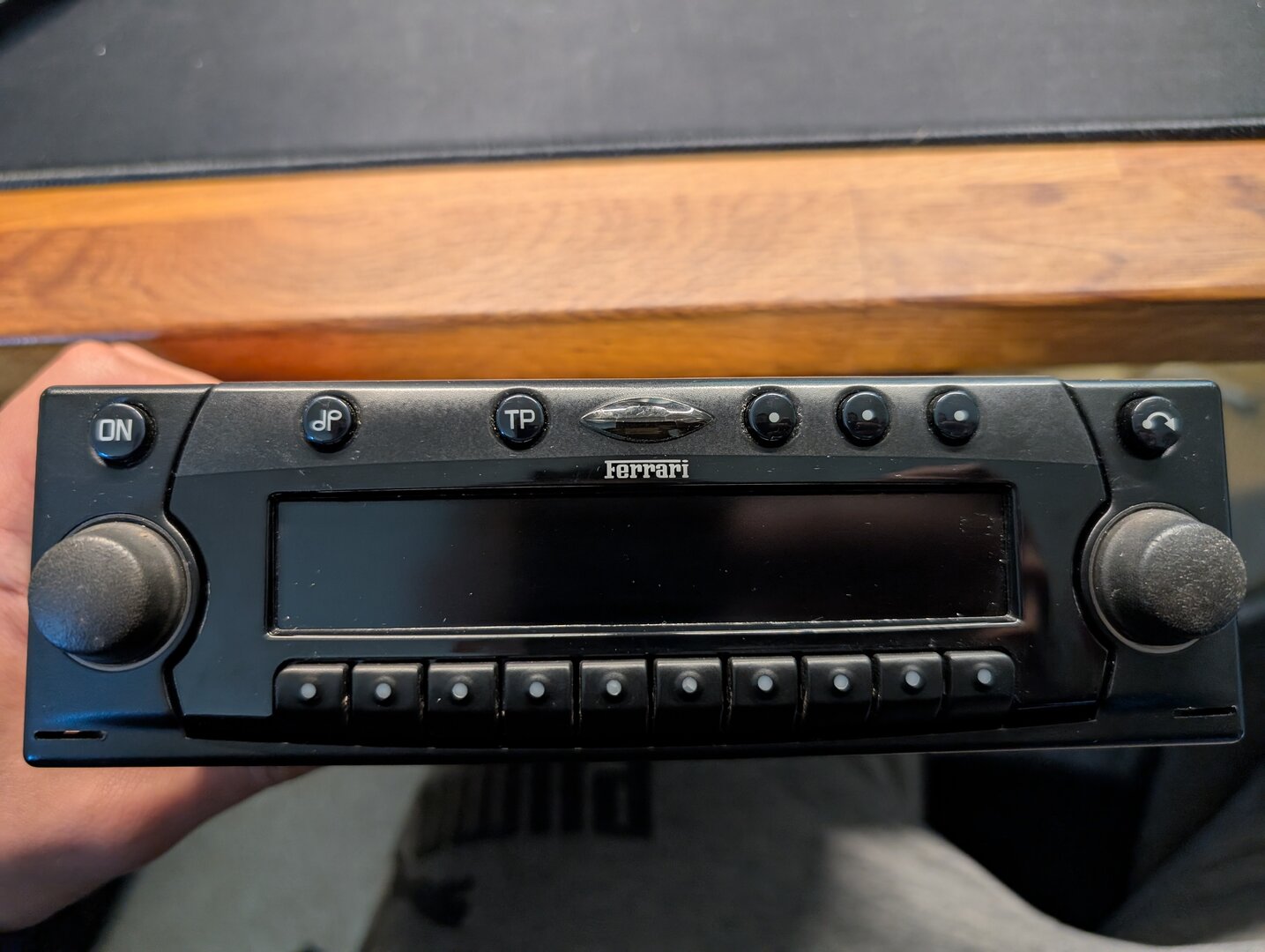

With the new column display setup, I needed somewhere to put my turbo speed gauge, so I bought a single din gauge holder + storage pocket thing from Draklore. Which meant I needed a single din stereo to replace my double din. I dug out my old Ferrari Becker unit and plan to run that, get a mini amp and put my speakers back in the front with new wiring. Unfortunately I didn't own a Ferrari - it came in my first car, isn't exactly period correct but I think it's cool haha. It will suit the 7 much better than an old mini with straight cut gears!

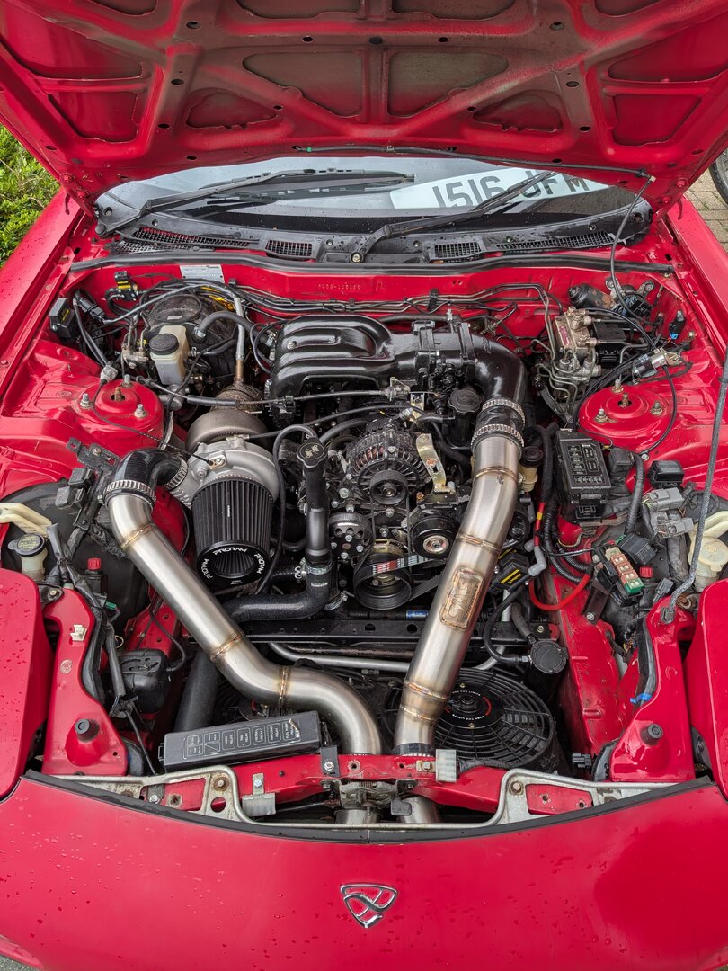

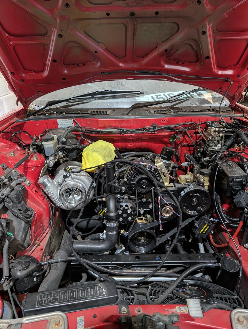

The car went to Josh in March 2025, and due to various reasons the engine didn't go in until May - I haven't got the build pics just yet but I went all black everythannggg just like before. Engine wise just as a recap, along with your standard rebuild kit - 2nd hand rotor, reground housings, new pumps, RA Super Seals and then from Colum, stud kit, balancing & rotors clearanced. Josh on the porting and assembly. I paid for injector flow testing for peace of mind, didn't actually get the results looking back but my positivity would like to think someone would have said if there was a problem!

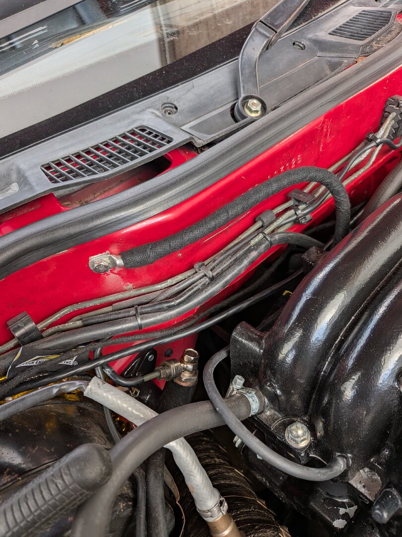

May 2025: I had written out a little termination plan for the ECU wiring - Tom at Advocult was very helpful at running his eyes over it for me! I decided to start doing bits myself on the car to speed things up, dash out for removing what I no longer needed etc. Got some nice spec44 wire for the additional sensors (fuel pressure/temp, oil pressure/temp, boost solenoid). I'd also spoken to Stu here re finishing the car once the time came (it would have been in-car wiring and then start up/ tune).

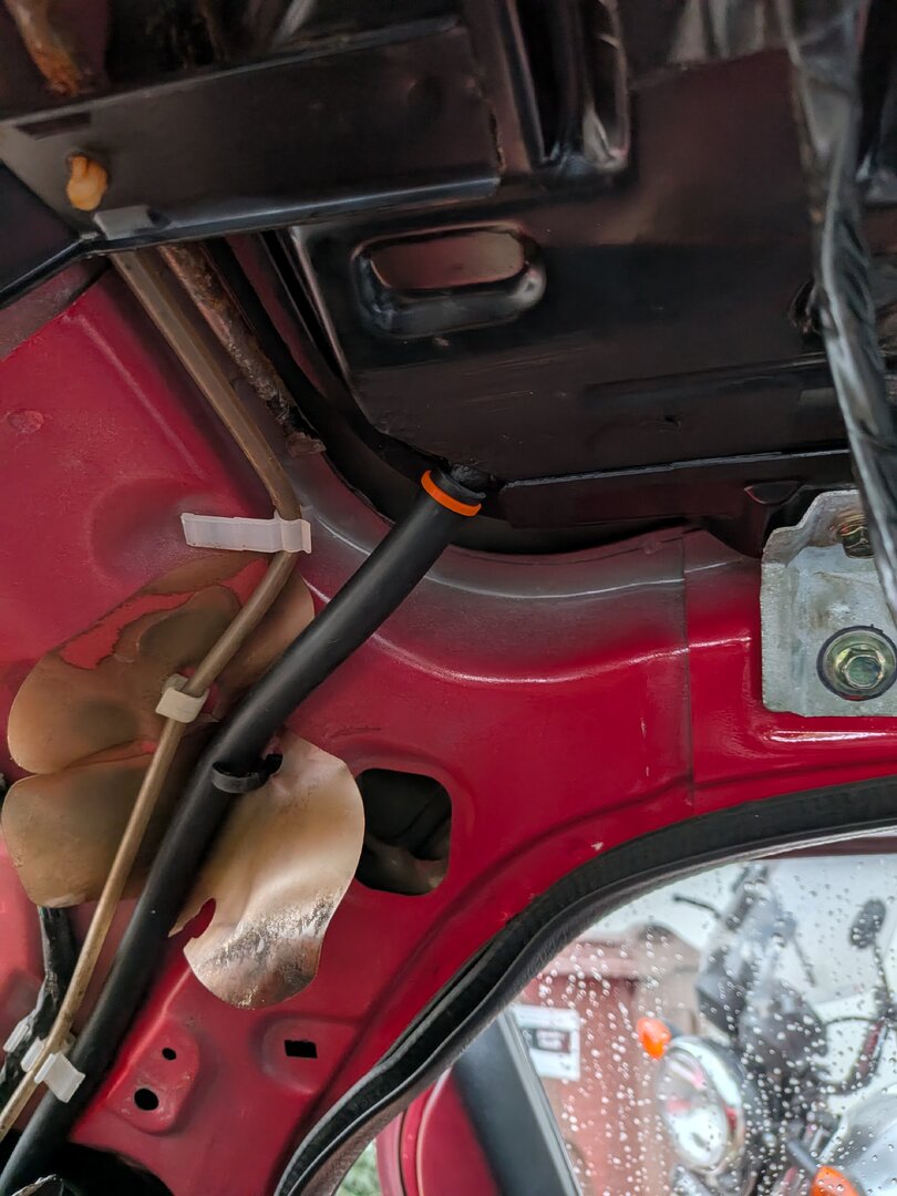

May 2026: prep for Stu... I could finally sort my sunroof, which actually wasn't as bad as I thought... Ground back, kurust, paint, new drain hose and it passed the leak test. The in-car wiring didn't get done, so I labelled stuff up for Stu, emptied the crap from the car, made a ground and off she went! Was awesome sitting down with Stu and going over what needed doing - that was honeslty a massive anxiety delete :ROFLMAO:. So at this point it needs my extra sensors wired in, wastegate fitting, clutch bled, fuel, tune, start. Will we be on the road this summer?!?!
