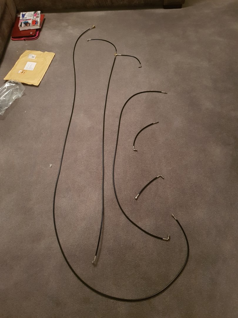

Has anyone fitted one of their kits? Looking to fit mine next weekend and just trying to get an idea of which line goes where before I start pulling th car apart. Fyi this is to also fit a bias valve also.
Nope, just a bag of brake lines
Lol. Nice.
They look a bit on the long side. It's been a while since I did mine but I imagine the tee-piece section will be the fronts, the two little ones from the master cylinder to the stock bias valve and the long one to the rears?
Well all the original lines are out and once the new ones were laid next to them it 'should' be pretty straight forward. Planning to go and Start fitting tomorrow so will let you know
Had another look today and struggling to find a routing. I have messaged proline on fb asking if they have any fitted photos from another car or fitting diagram for which length line goes where...still waiting for a response

Sorry for no reply bash, only just decided to take one last look again today, still cant find a happy routing and no replies from them too. Starting to think about sacking it of and just making some hardlines up so I'm happy with the routing.

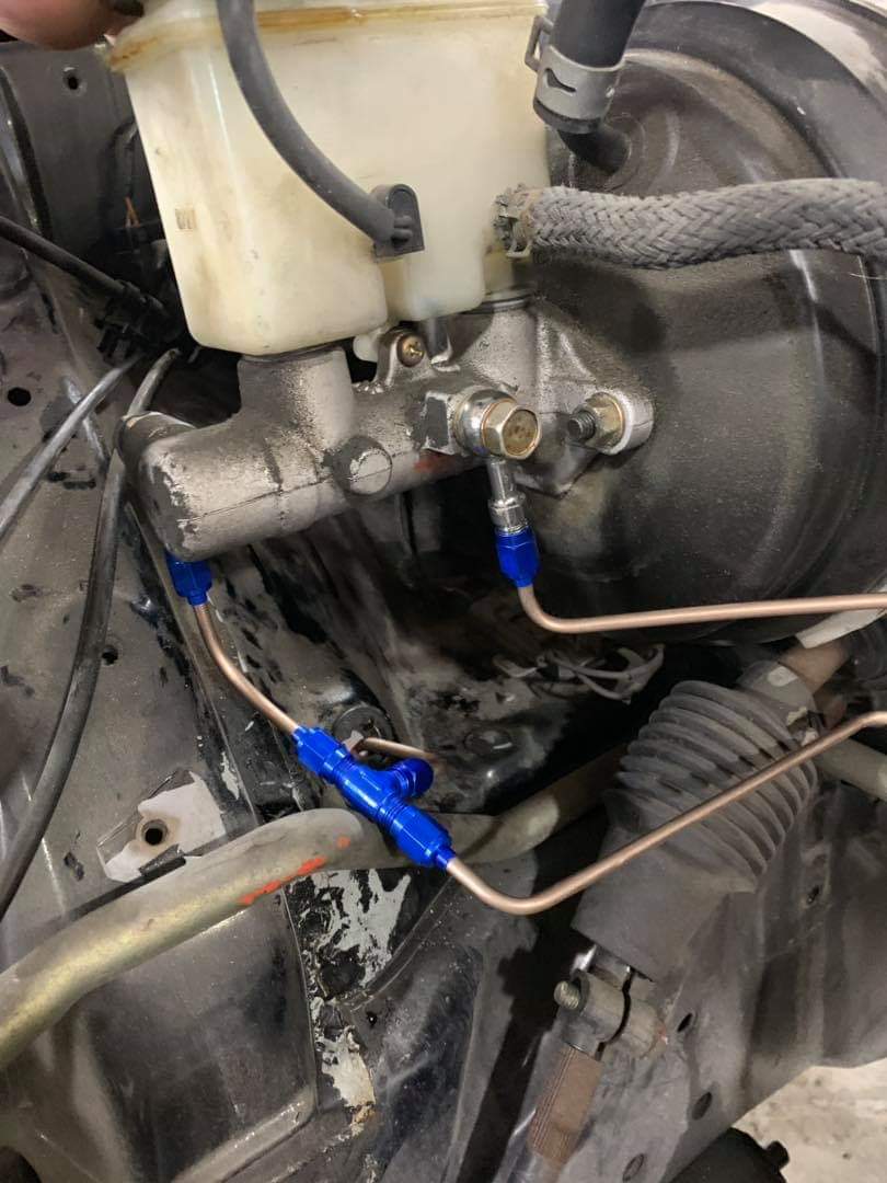

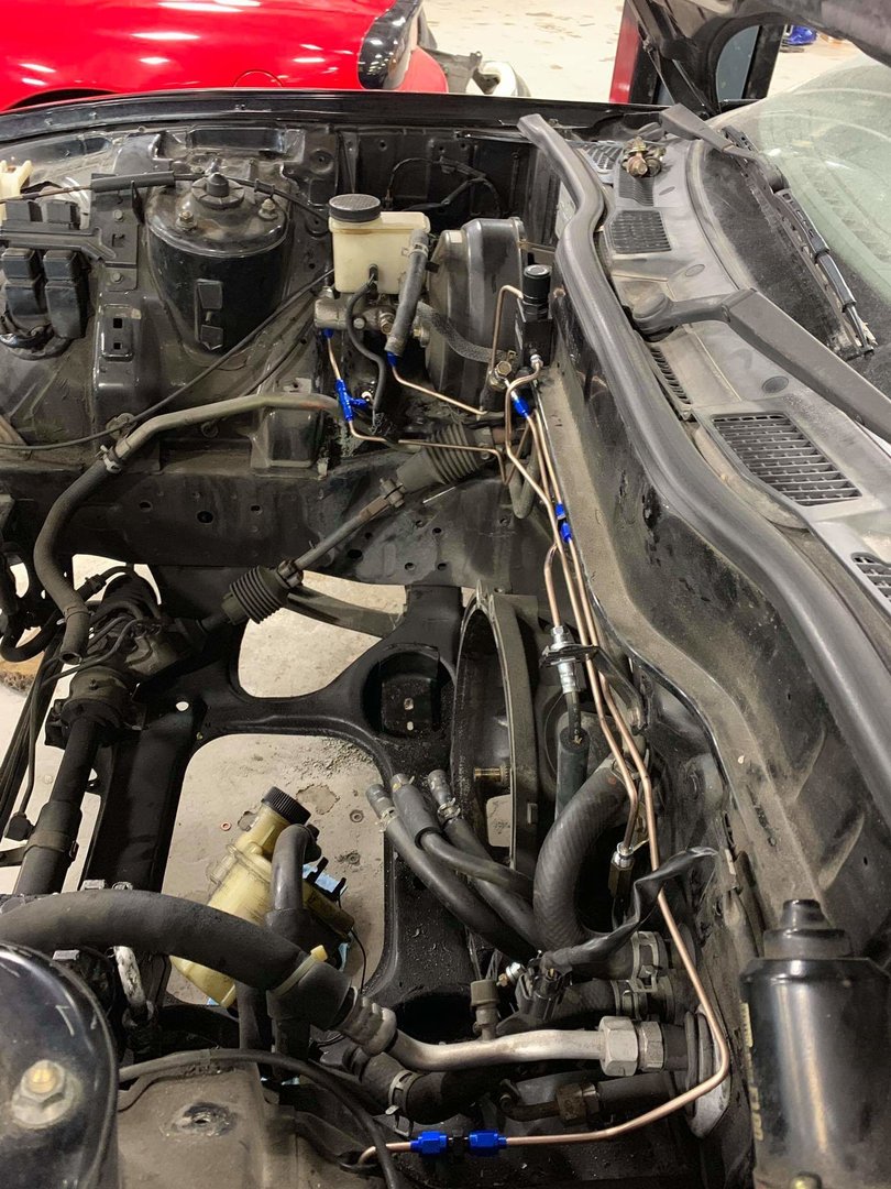

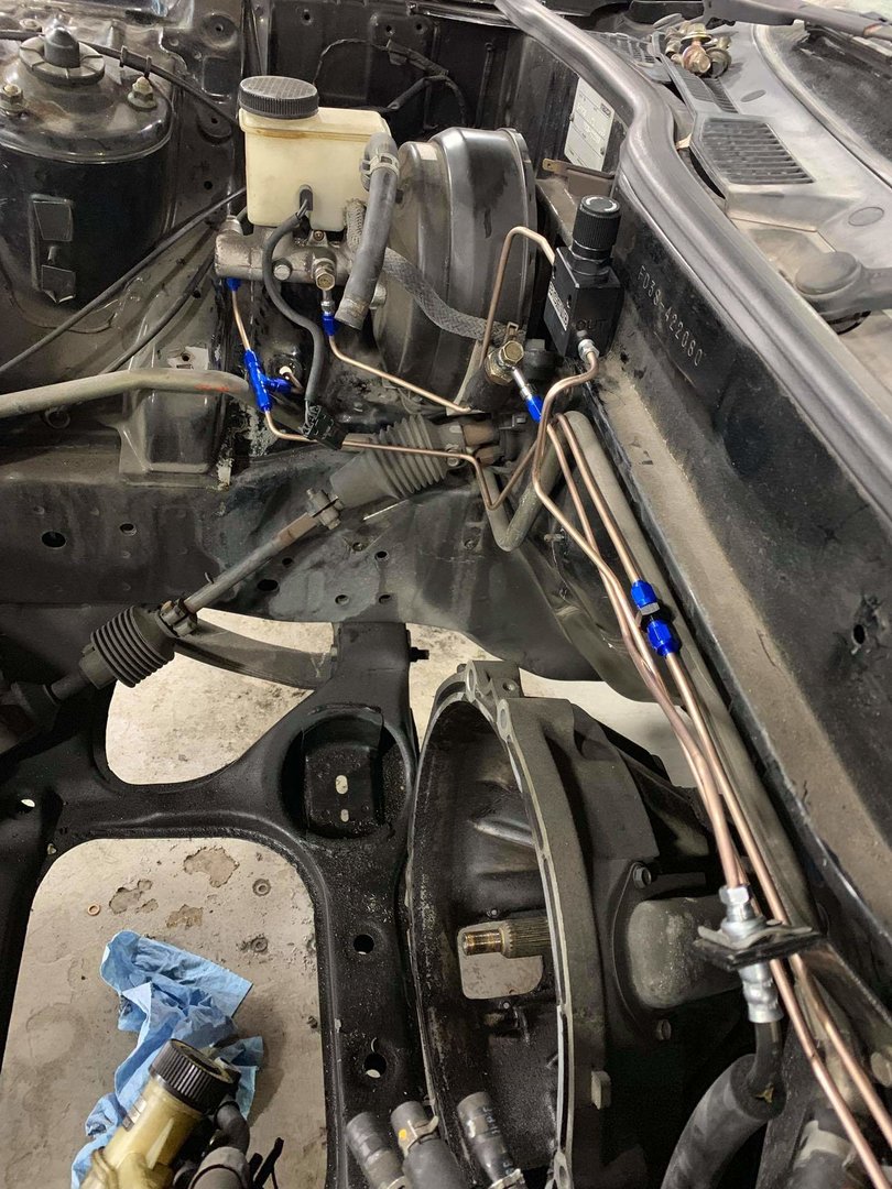

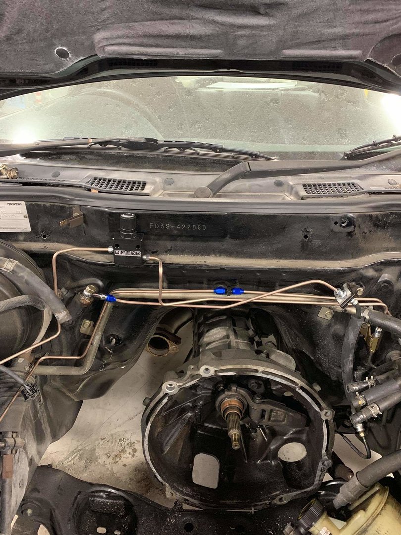

I've done this job a couple of times now it's actually pretty easy
Thanks for this Liam. This is why im gonna use braided though. The bends here are all over the place and for me will run too close to the turbo on the BMC side.
