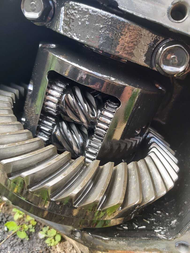

It's worth pulling the diff apart IMO to see if it is just the ring and pinion that's damaged and not the torsen (I think?) LSD. If that's the case, an alternative could be to source an early RX8 diff and swap them over. They're super cheap at usually in reasonable condition from what I've found. Plus it shortens your final drive to 4.44, so your car would feel like it has more zip to it

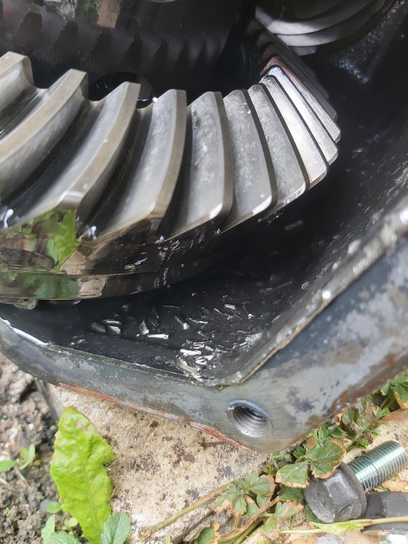

Removed the diff today and found this

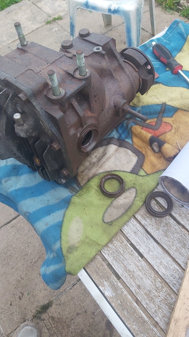

Lucky i picked a diff up from jit and fitted new seals and oil and dropped it in this morning.
Took it for a littlw test drive and everything seems to be good now 😀.
Thanks for your help guys 👍
That looks pretty mangled in there haha. Nice work buddy, glad she's back on the road (y)(y).
