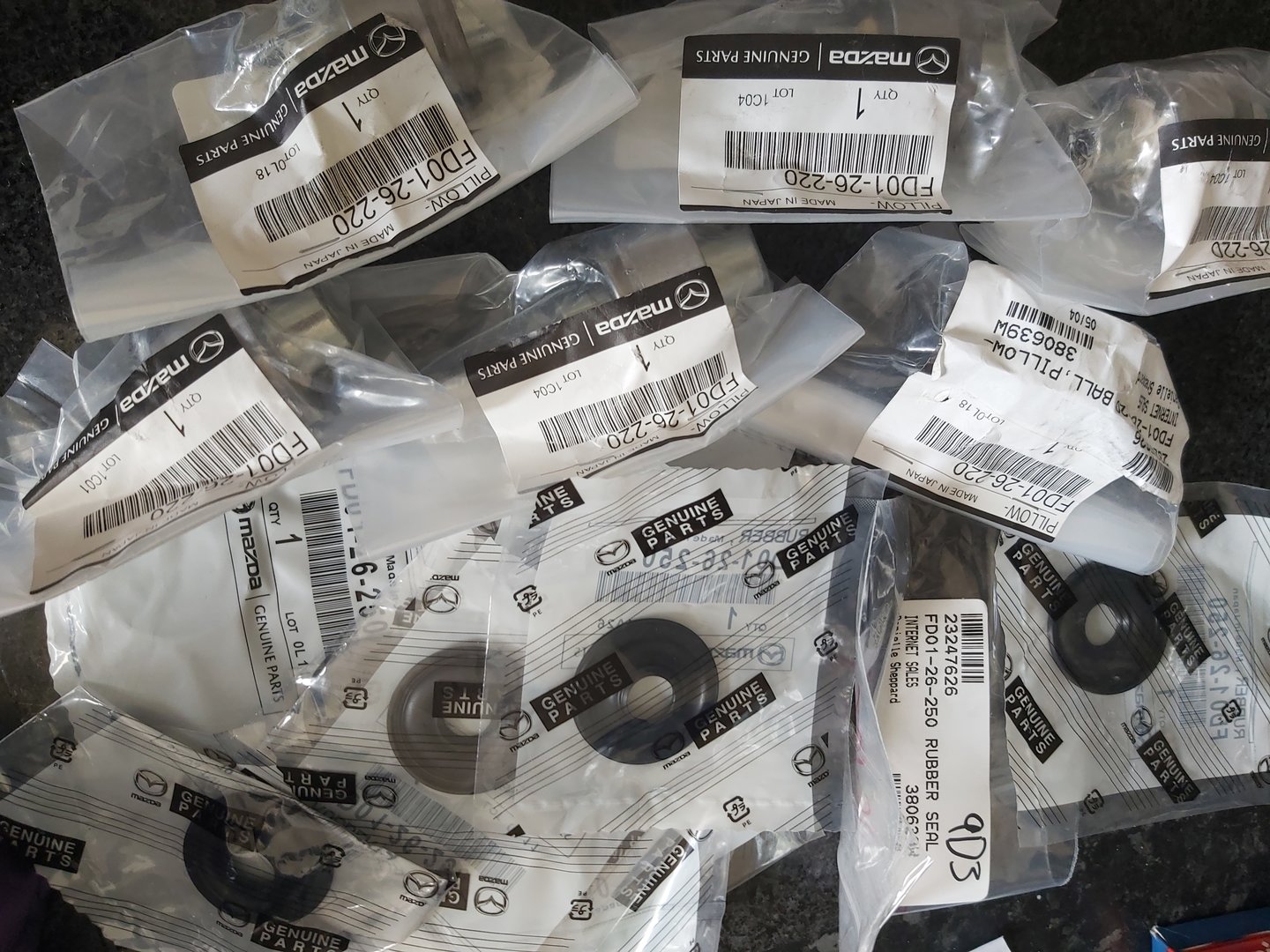

i got the oem 6 pillow balls and 12 covers from tasca which was 442 pounds.
Link:
The other bush was from ebay for 48 pounds.
Link: https://www.ebay.co.uk/itm/28286723...d=link&campid=5338477309&toolid=20001&mkevt=1
All including delivery

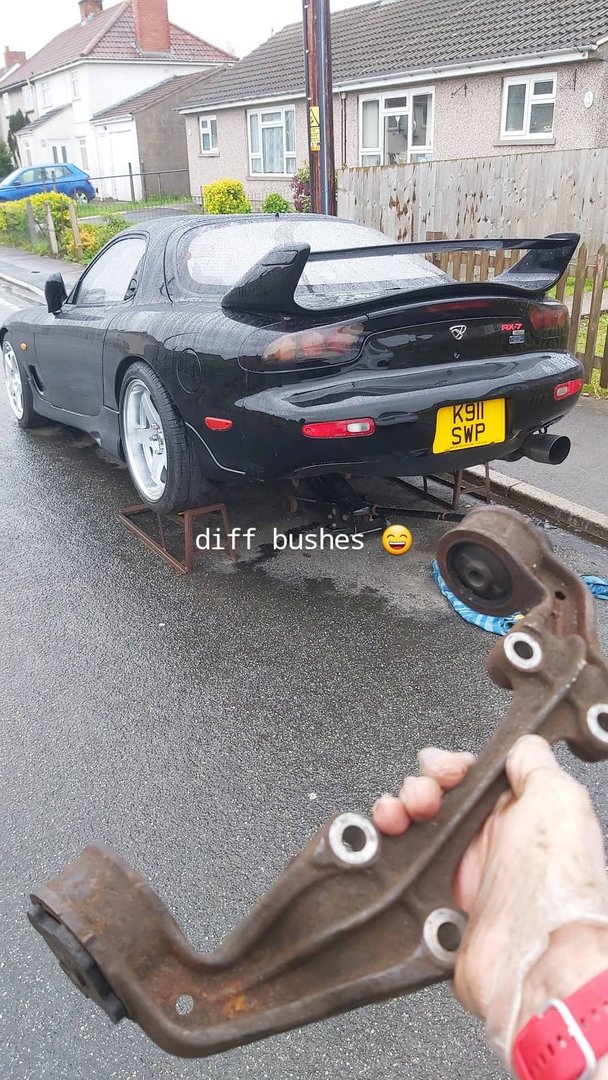

Fitted the diff mount bushes today, wasnt too bad 🙂, hardest part was putting the new bushes into the mount, but i was using a vice todo it, anyway, one job done 😂.

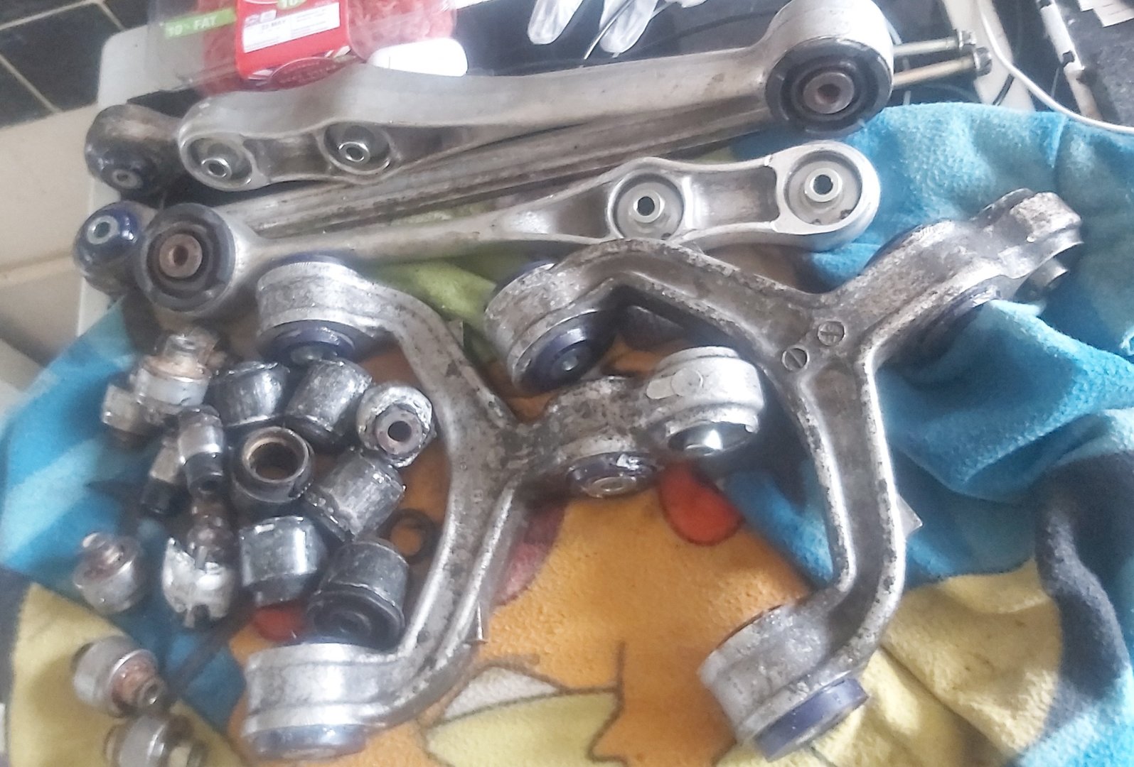

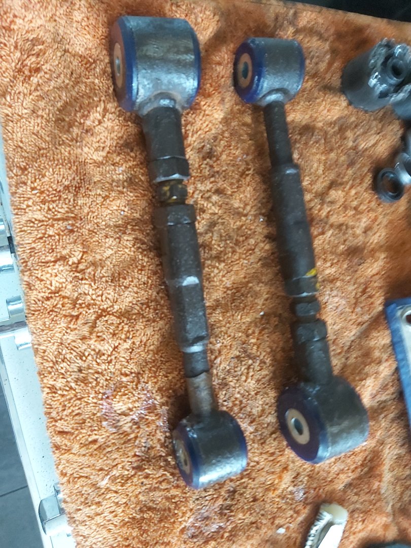

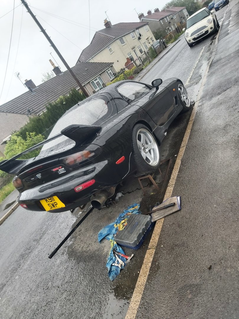

Toe links done and fitted, test drove it and the cars still knocking like crazy and all over the road but should be ok, pillowballs turn up monday and il do the rest next week. 😄
Defo not fun doing it in the rain on the side of the road but its gotta be done 🙂
Those links are the hardest ones! Knocking will only be coming from the PB's. Most of my other bushes were in good shape when I changed mine as OEM are quite hardy. The PBs are just a weak link in the system but serve an important function.

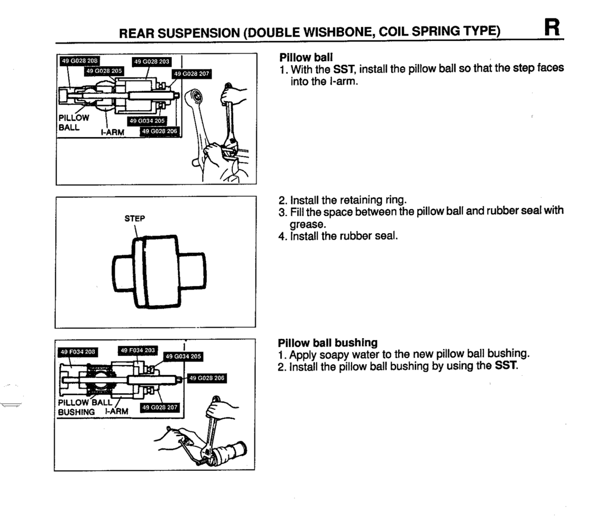

When fitting the pillowballs, do they need greasing under the dust cover area?
The ball joints look like they already are greased.
Thanks
Tj
Thanks
Tj
Yes, you fill to gap between the pillowball and the dust boot with grease as per the FSM.

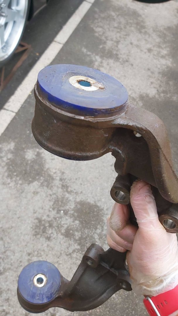

Rear end done now, new pillow balls, grease dust covers ect, the pillow balls were so easy to replace ( took the pic before grease and dust covers), the other were alot harder todo 😂.
just waiting on the track control arm bush to come, and il fit that then too as they are really worn.
Ive fitted it all back up to the car, no play in the wheels now which is pretry sweet 😀.
Fitted everything with a vice again, im pretty happy with it all
Was going to attempt to clean the arms ect but tbf i just wanted to get the car back on the ground as it was on the main road on axle stands 😂
