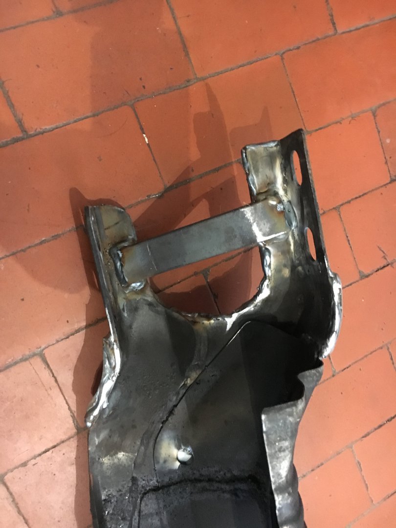

Nice, saves some dosh at least. I've had a look but can only see find home made ones or mazdaspeed.. care to name some brands?

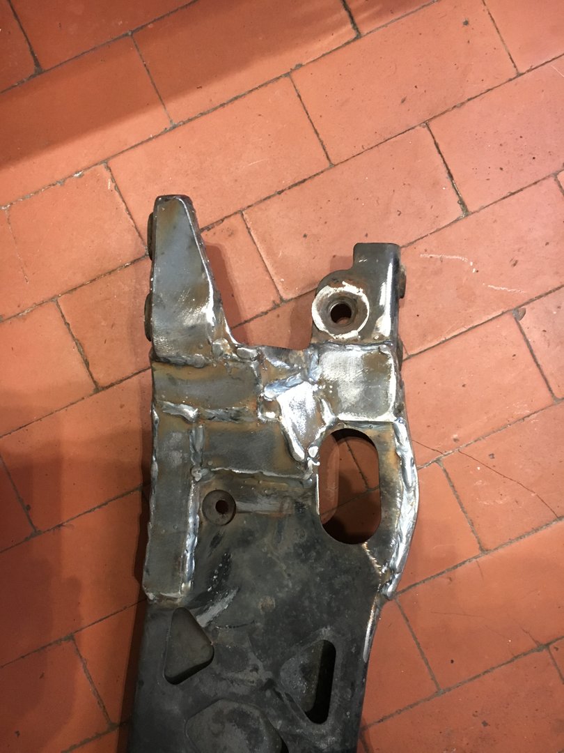

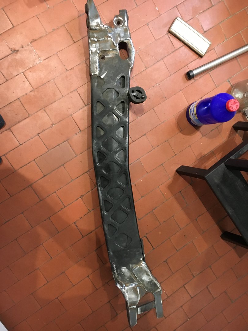

In terms of the alignment etc can I just whack it off and back in on the street with a jack and stands or will I need a ramp for it.
And I thought I was just needing a front mount doh!

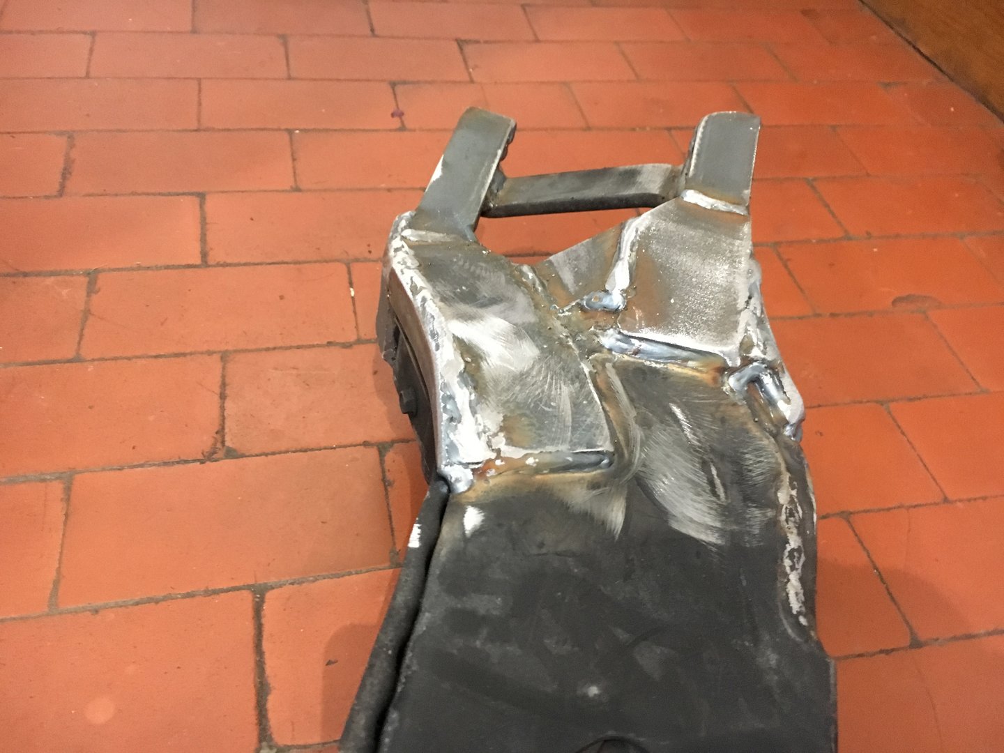

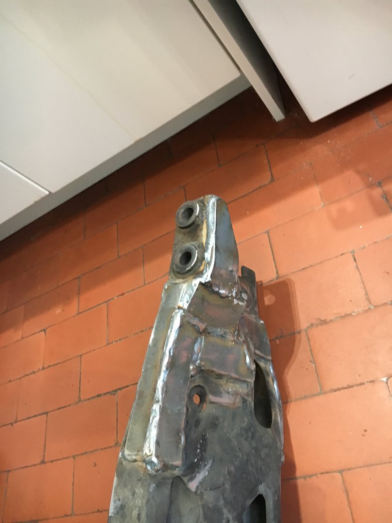

Yeah, it's just rolled steel, nothing special to weld really, just don't put silly heat into it and warp it and you'll be fine
Alignment wise, you'll be fine on axle stands, that's the way I've always done it! If you tighten it in the top-down order, rear first then do the measurement, I've always had them be in spec so far.
I'd much rather pull a PPF than a diff, cheaper too
