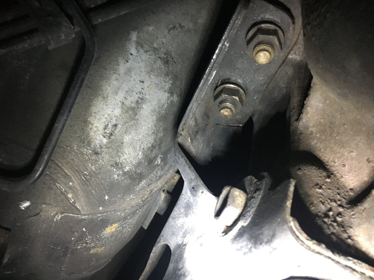

@Paulm was bang on the money.. Give that man a cigar lol....
Nice crack in the PPF...
How tho? do they just go? Id a;ways bank on a moving part going, not a solid bar....

The clunking under load after a hard pull made me think ppf. Its what broke mine :(

Mig will be fine. I'd strengthen the rest while you've got the welder out, look at the Japanese aftermarket ones for some ideas of where to seam weld and brace :).
Nice, saves some dosh at least. I've had a look but can only see find home made ones or mazdaspeed.. care to name some brands?
In terms of the alignment etc can I just whack it off and back in on the street with a jack and stands or will I need a ramp for it.
