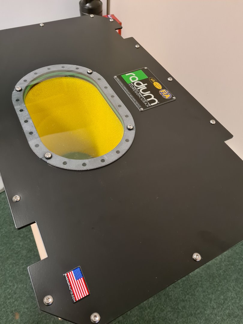

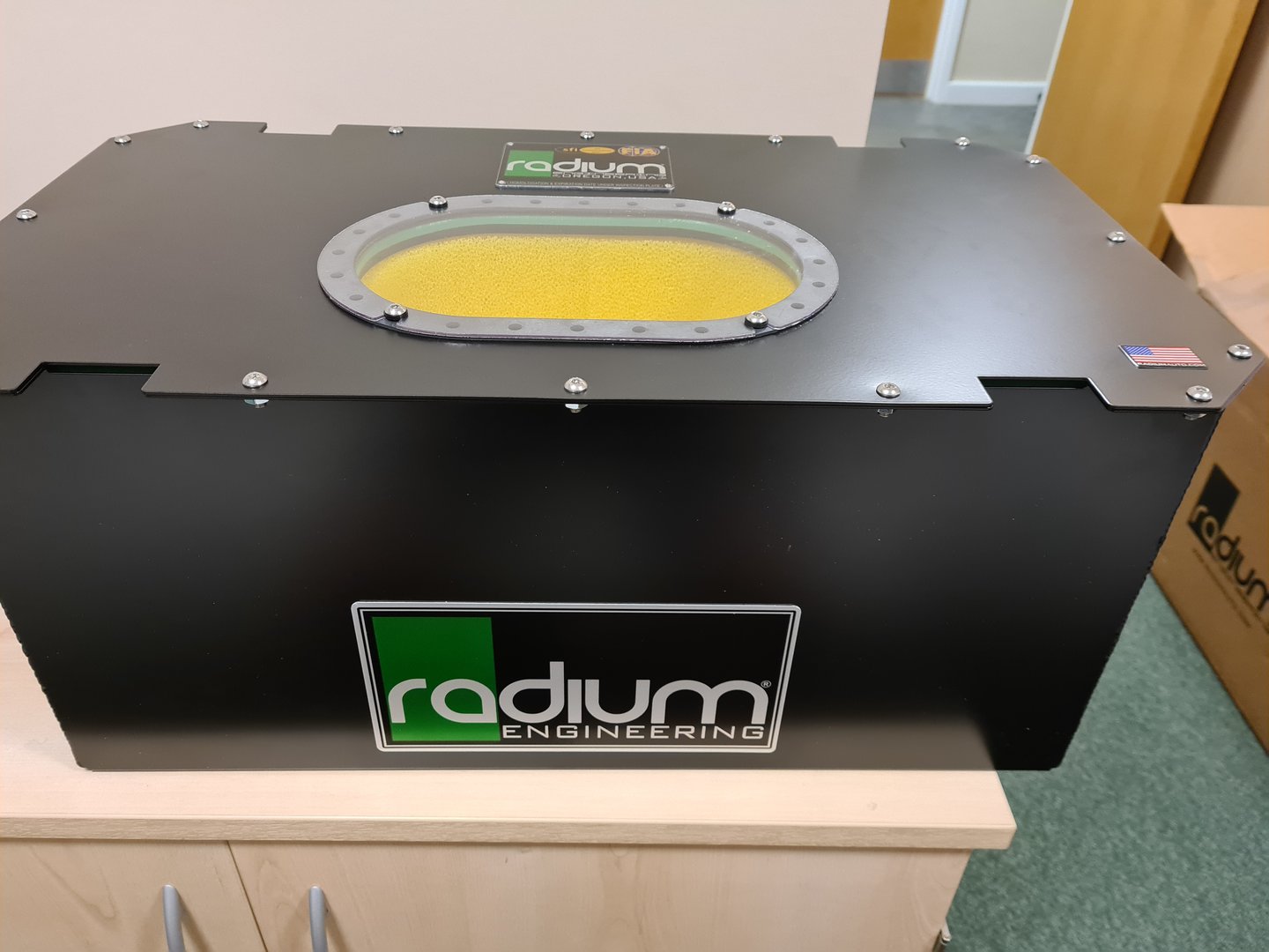

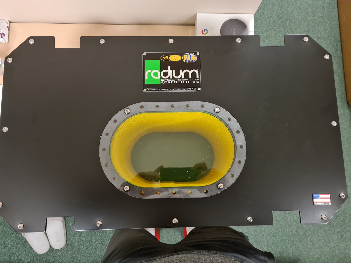

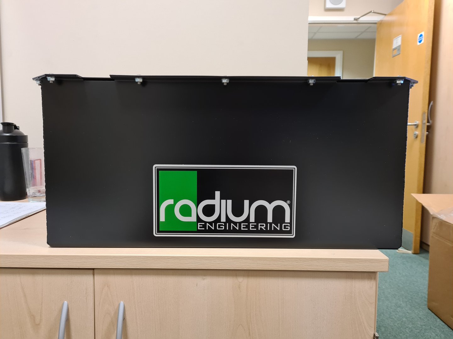

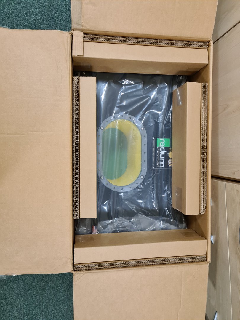

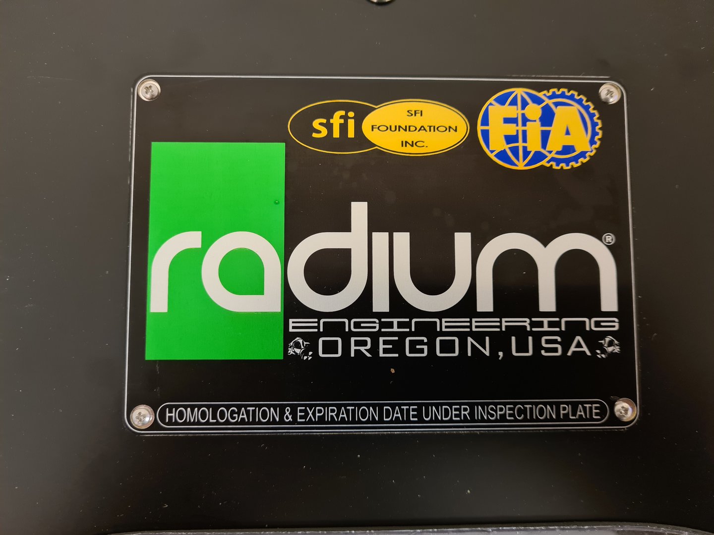

Not a huge update, but got the radium fuel cell ready for when the shell goes over to the bodyshop to get some fab work done and then hopefully fit the kit and get the whole thing re-sprayed.
The quality is awesome and I cannot wait to see this mounted in the boot! Will have the radium fuel cell surge tank when I have decided on which fuel pumps etc I want/need.
Look forward to seeing this progress. How much headroom do you have with the cage? I note you are quite tall and this is the challenge with a caged FD. Also what made you go for the fuel cell? Will you be racing? Was there a benefit over the ATL offering? Did Radium give any indication as to how often the bladder should be replaced?
It's going to be tight with headroom, I do have some low seat rails so hopefully when I can install them properly, it gives me a bit more room.
If I'm honest I do not need an FIA cell and could have easily managed with a standard fuel cell and a surge tank, however I do love the look of having a fuel cell installed in the boot area, which was initially what got me interested. Obviously the benefits of having an in tank surge system etc will be beneficial when I do come to tracking it, but no I won't be racing as such, probably just track days to start with and see how it goes from there.
With the bladder it is just a case of regular inspections and replace when required, as opposed to a set time.

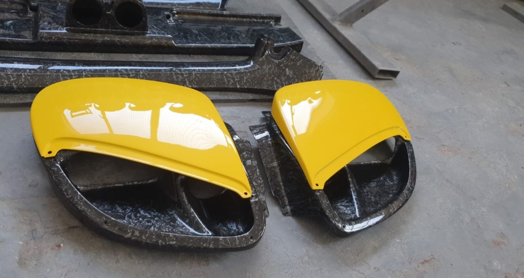

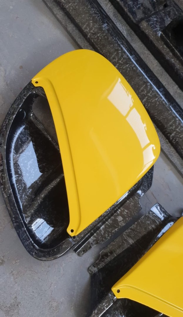

My R-Magic headlights have been sprayed to give me an idea of whether I like the yellow that is being used and the buckets got hydro dipped in crushed carbon, which was a surprise, but gives them something else as opposed to just being black.
I have only seen them in photos but so far, I love the look of them and if they look as good in person, I cannot wait to see the project fully sprayed.

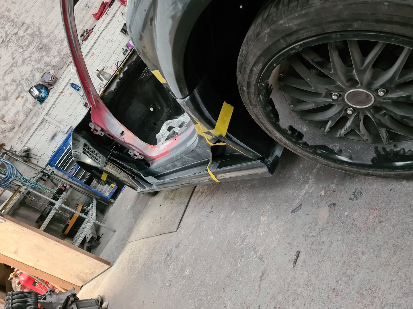

So while I wait for the middle of next month when my TCP kit will finally arrive at Southampton docks, the car is in the bodyshop getting a lot of the s**t sorted that unfortunately had been done to the shell before.
Anyway, the guys are taking their time with it (due to my request) so are only doing a day or so a week on it, until it goes to get a new roll cage sorted.
I will try and get these photos in order, but I'm sure you'll be able to tell the before/afters anyway.

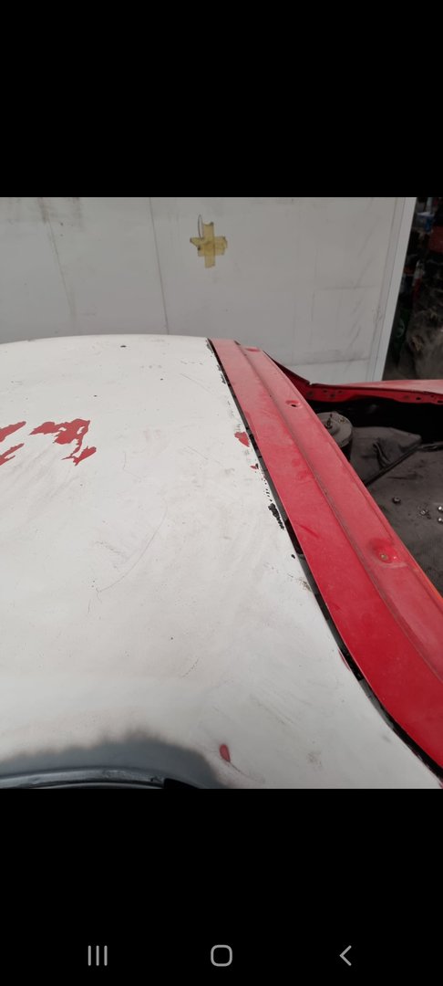

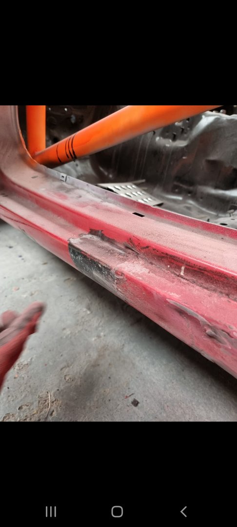

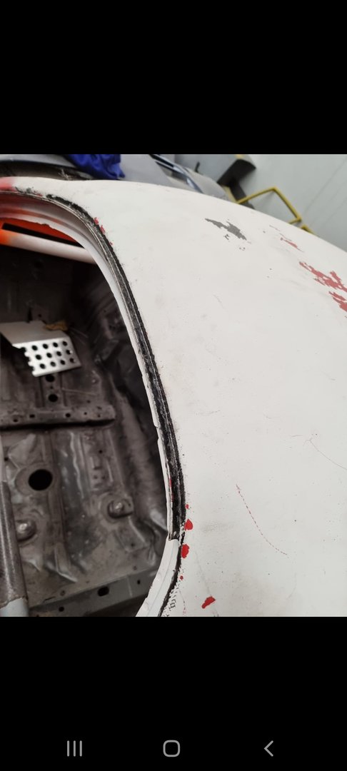

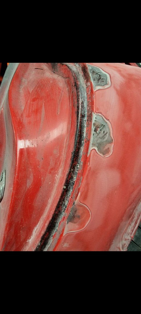

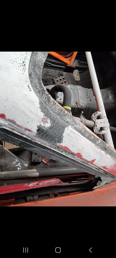

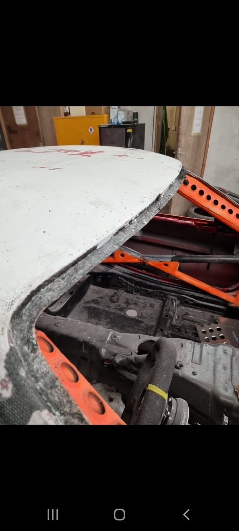

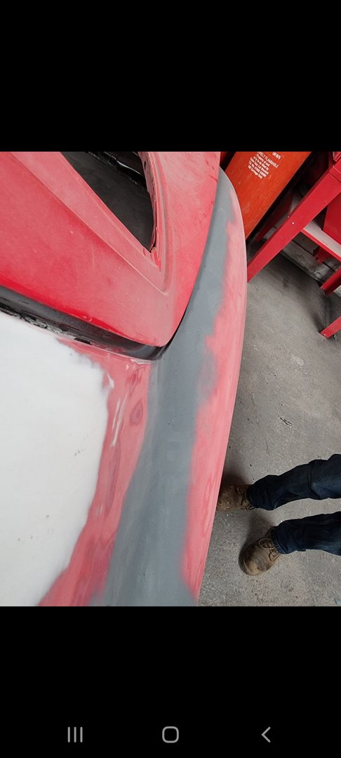

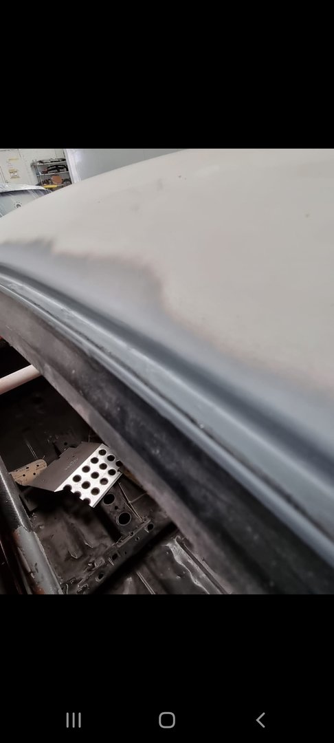

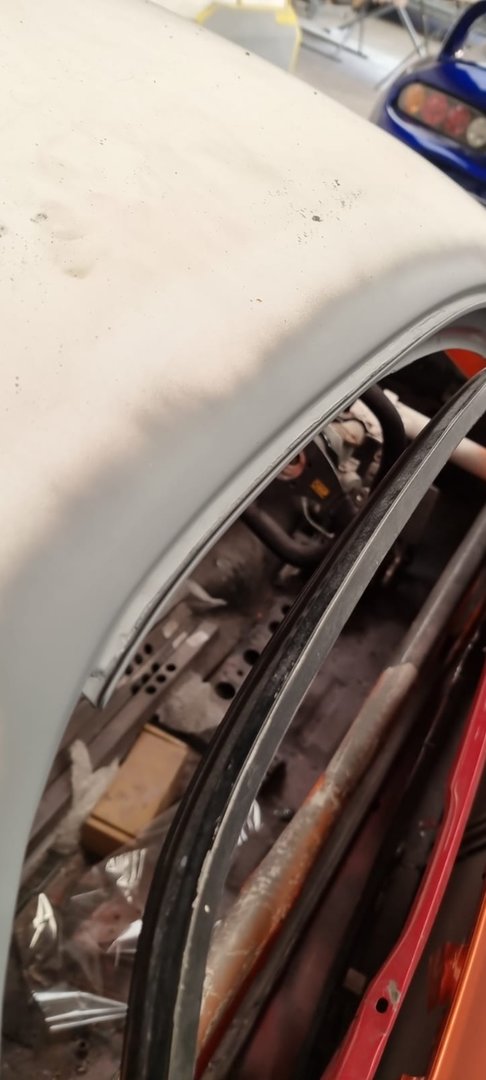

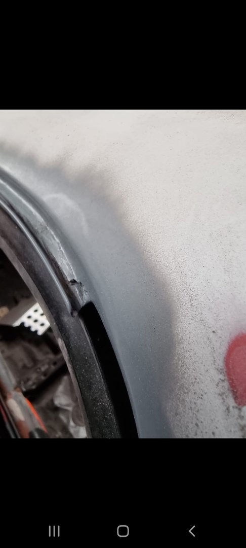

Still isn't the most attractive thing, but as you can see, a lot of the remaining carbon skin that had been fitted has been removed and the resin has been taken off and sanded then covered with a layer of primer to protect the shell.

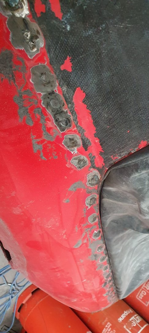

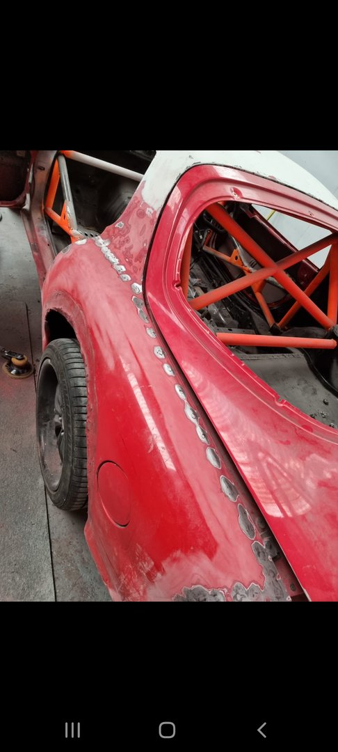

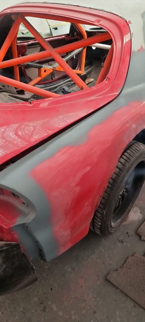

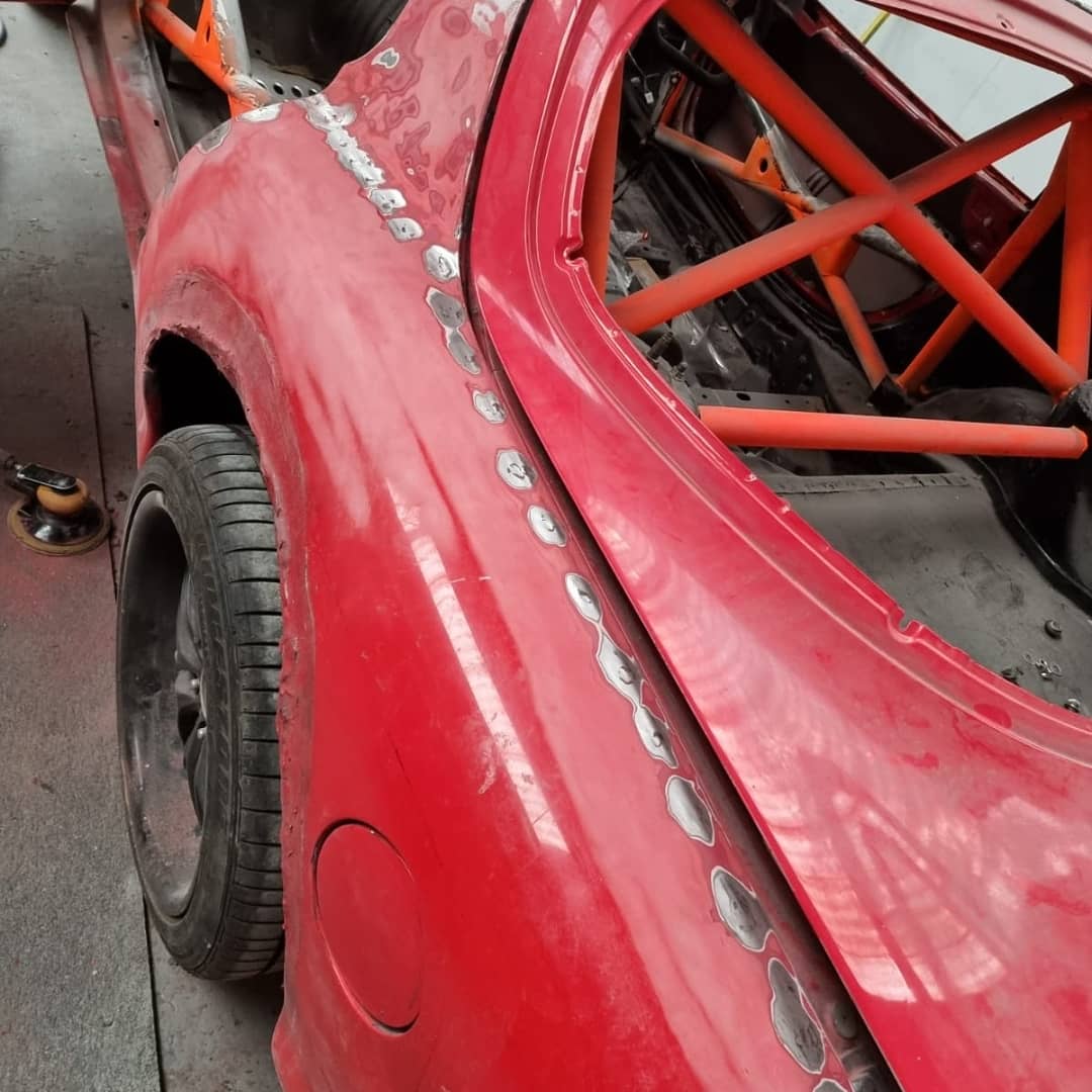

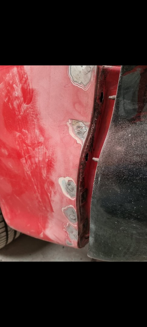

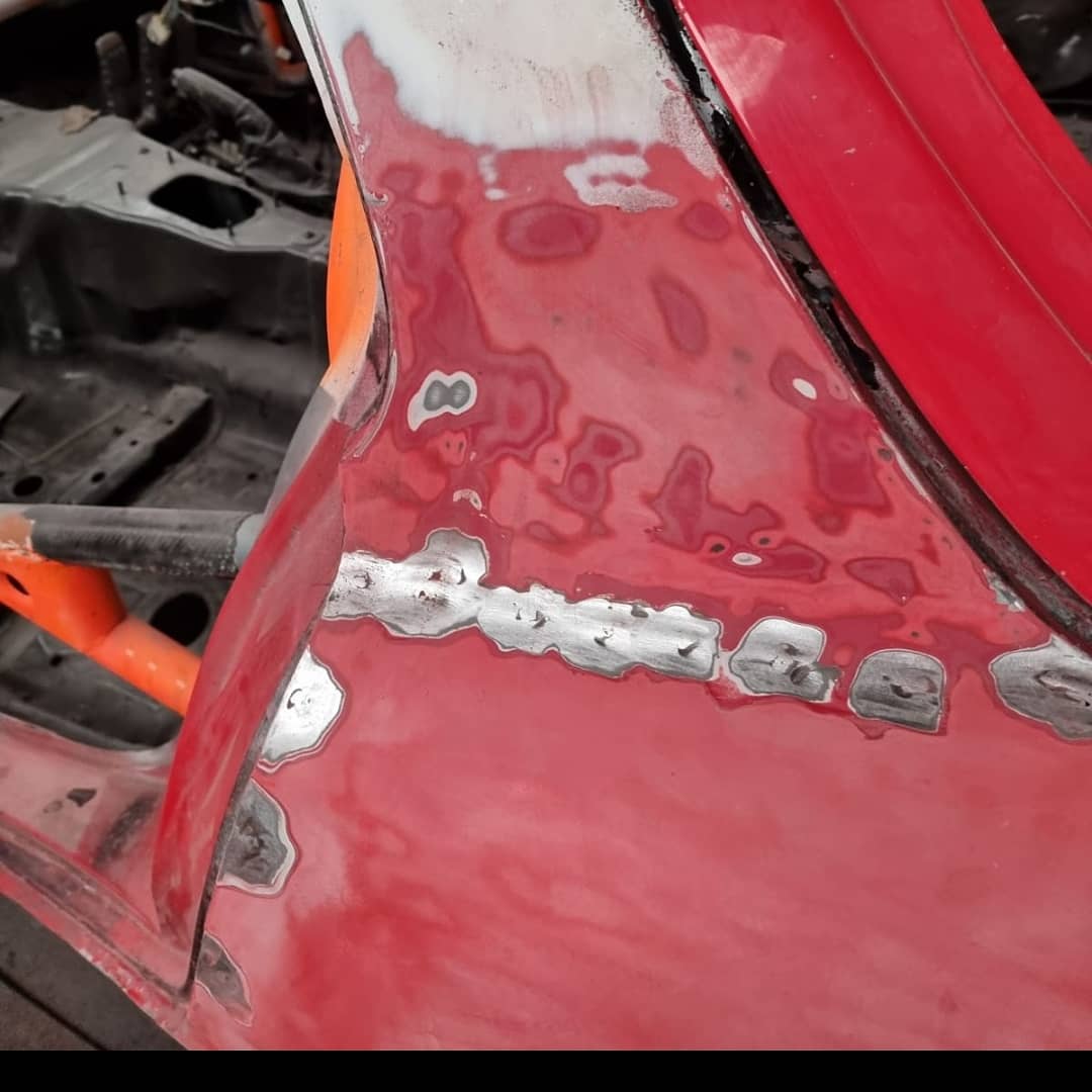

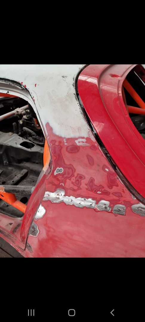

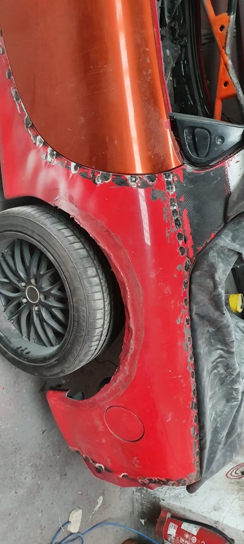

Where the previous wide arches were, the holes have been flattened down and welded and again, been primered to protect the metal.
The arches at the rear that have been cut are going to be getting some attention soon, as well as a few small dents in the roof, from when the carbon skin was pulled off.

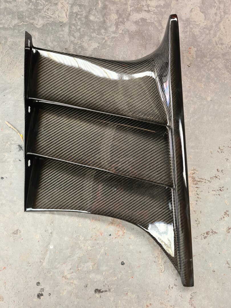

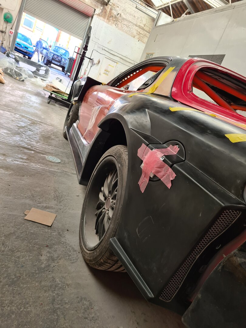

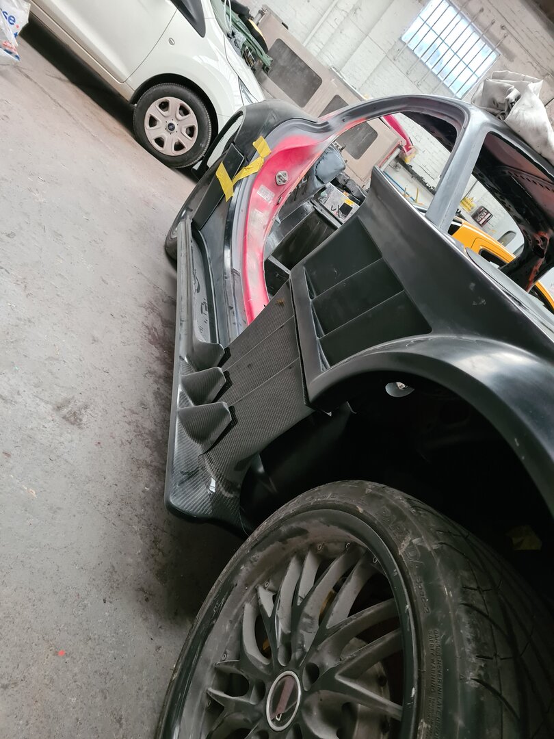

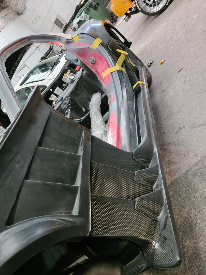

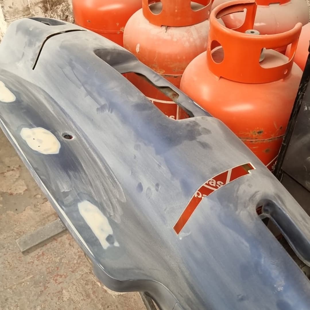

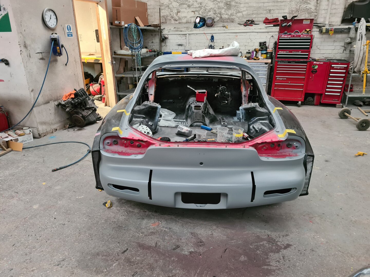

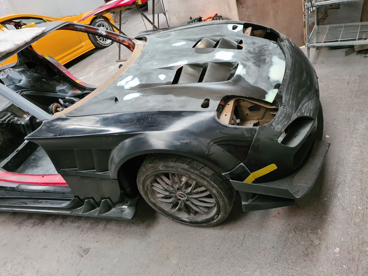

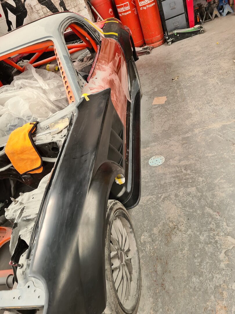

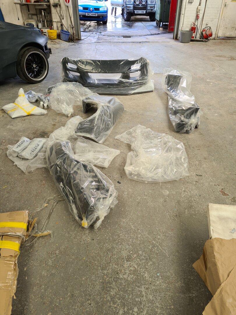

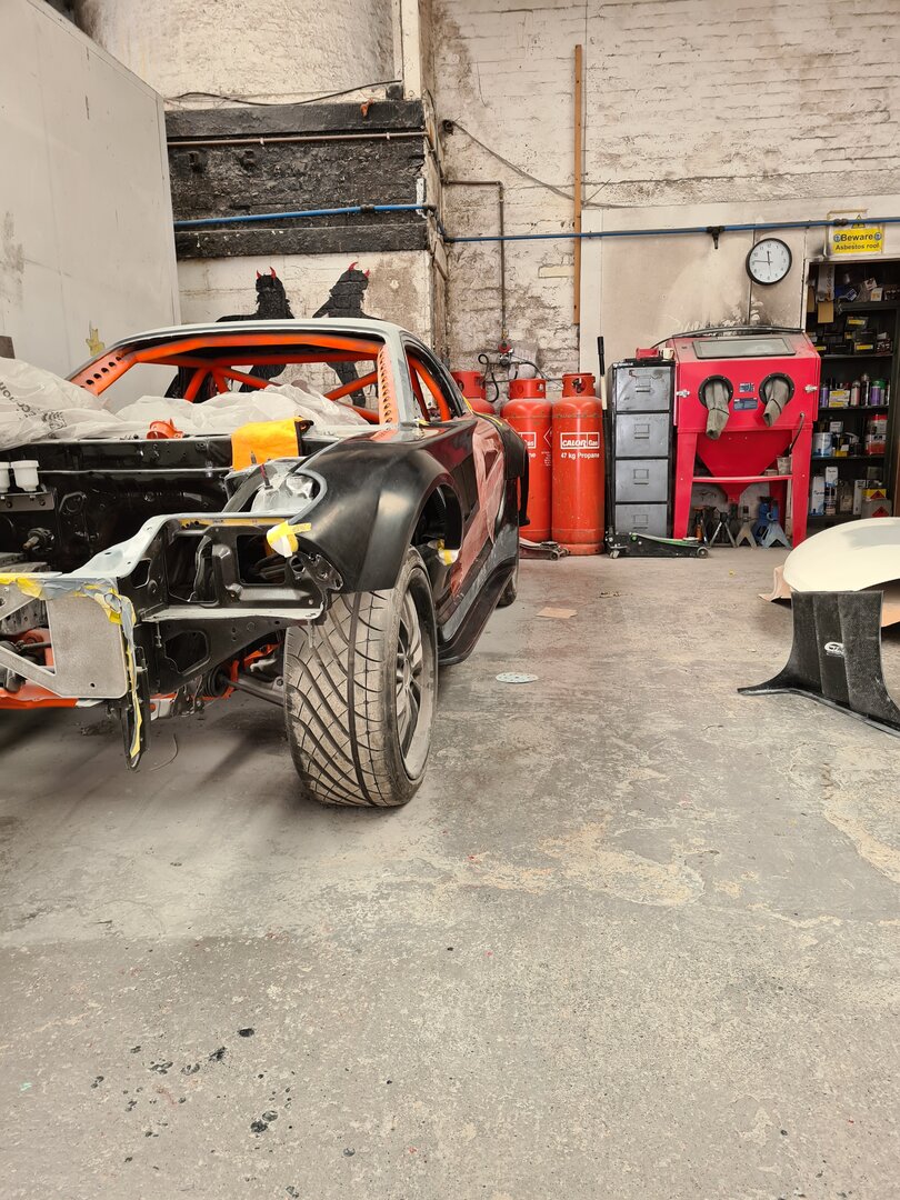

So finally have some decent updates, albeit wiyhout the best photos as I was in a rush. But finally managed to test fit some of the TCP Magic Ultimate kit and to say I'm excited is an understatement!!

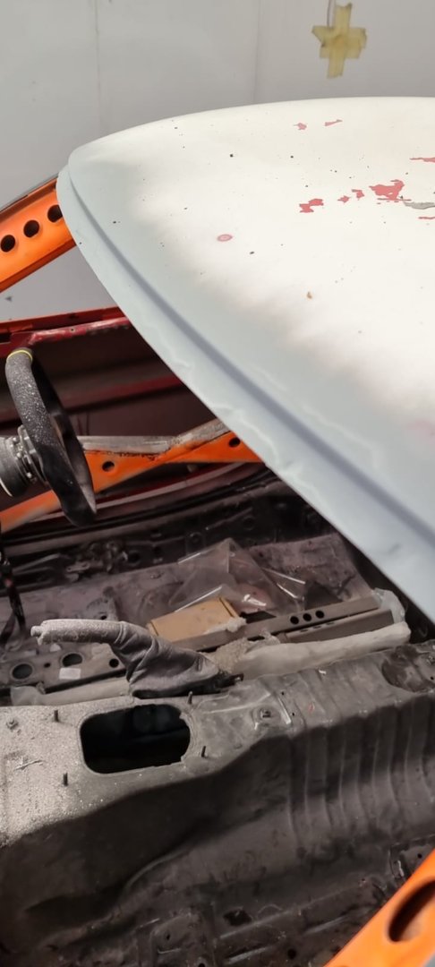

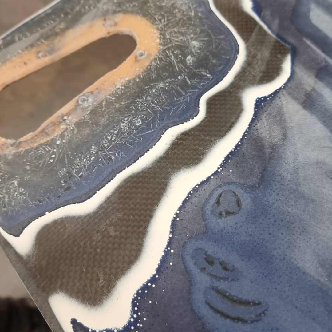

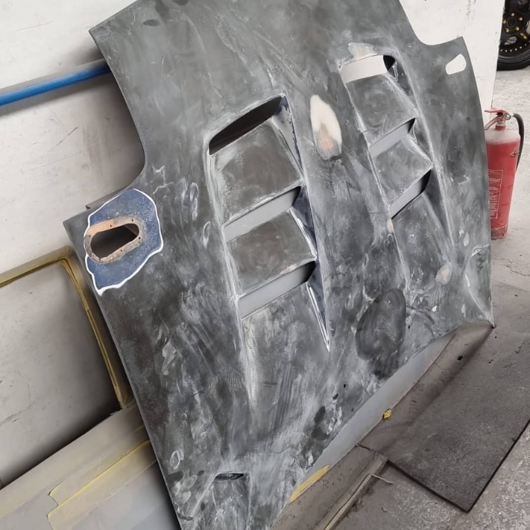

Also, the guys have sanded my bonnet due to it having blistered and discovered that apart from the repair patch, it is actually carbon fibre and not fibreglass like I was led to believe, so that was a positive!!
And finally, after my bodge job, I now have a perfectly cut rear bumper to accommodate my chassis mount wing.
Fingers crossed it won't be too long until the kit is properly fitted and sprayed.

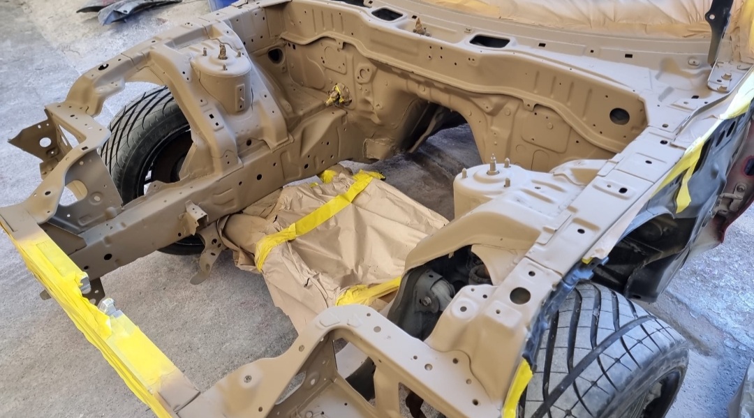

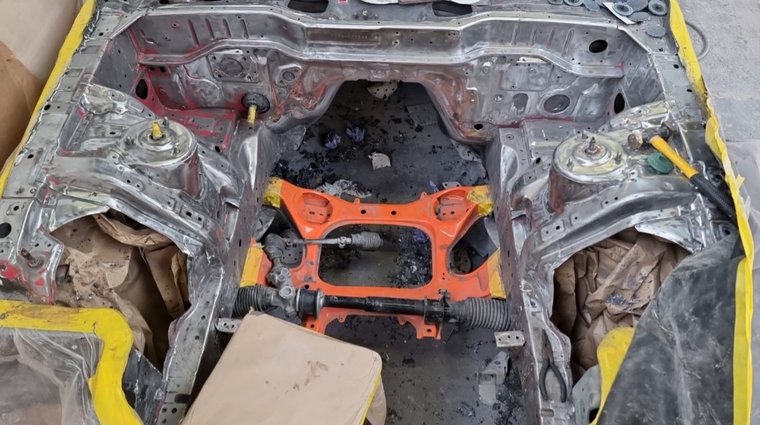

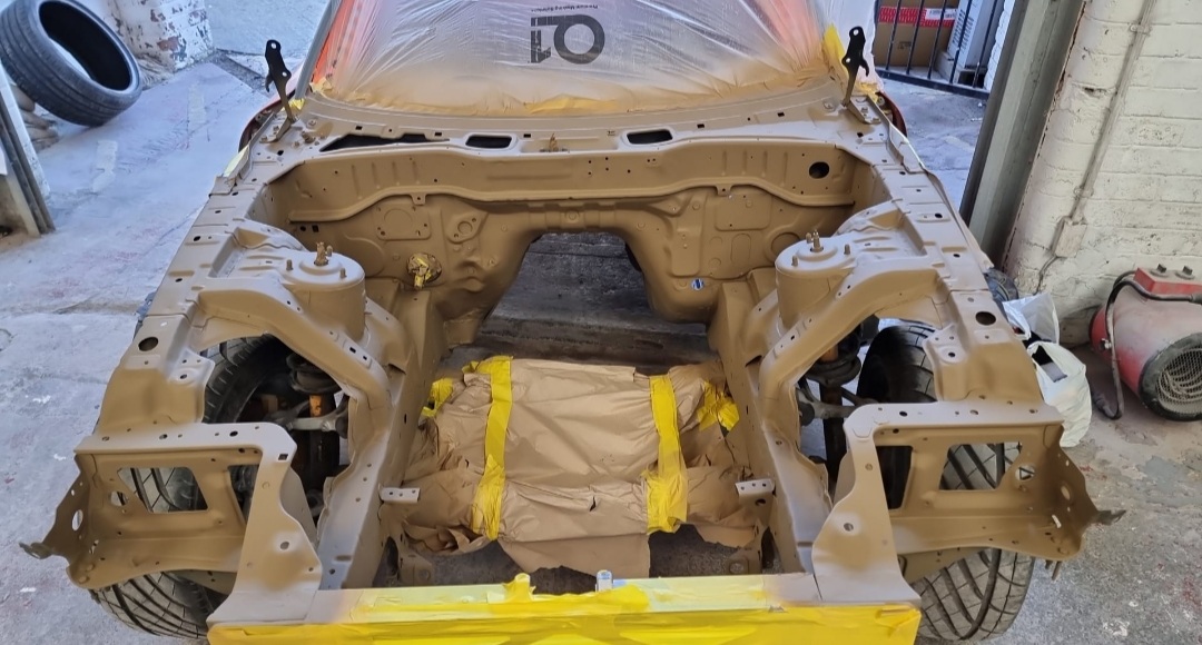

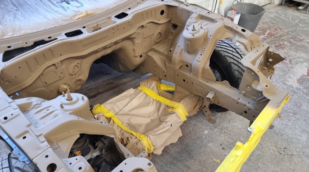

So after discovering the paint job in the engine bay was completely sh*te, we decided to take the bay back to bare metal to ensure that it doesn't cause problems later on down the line. So here are some images of it in bare metal with all paint removed and then in etch primer.
Not long now until the car should get pieced together and the body kit gets fitted and sprayed!
To say I'm excited is an understatement.

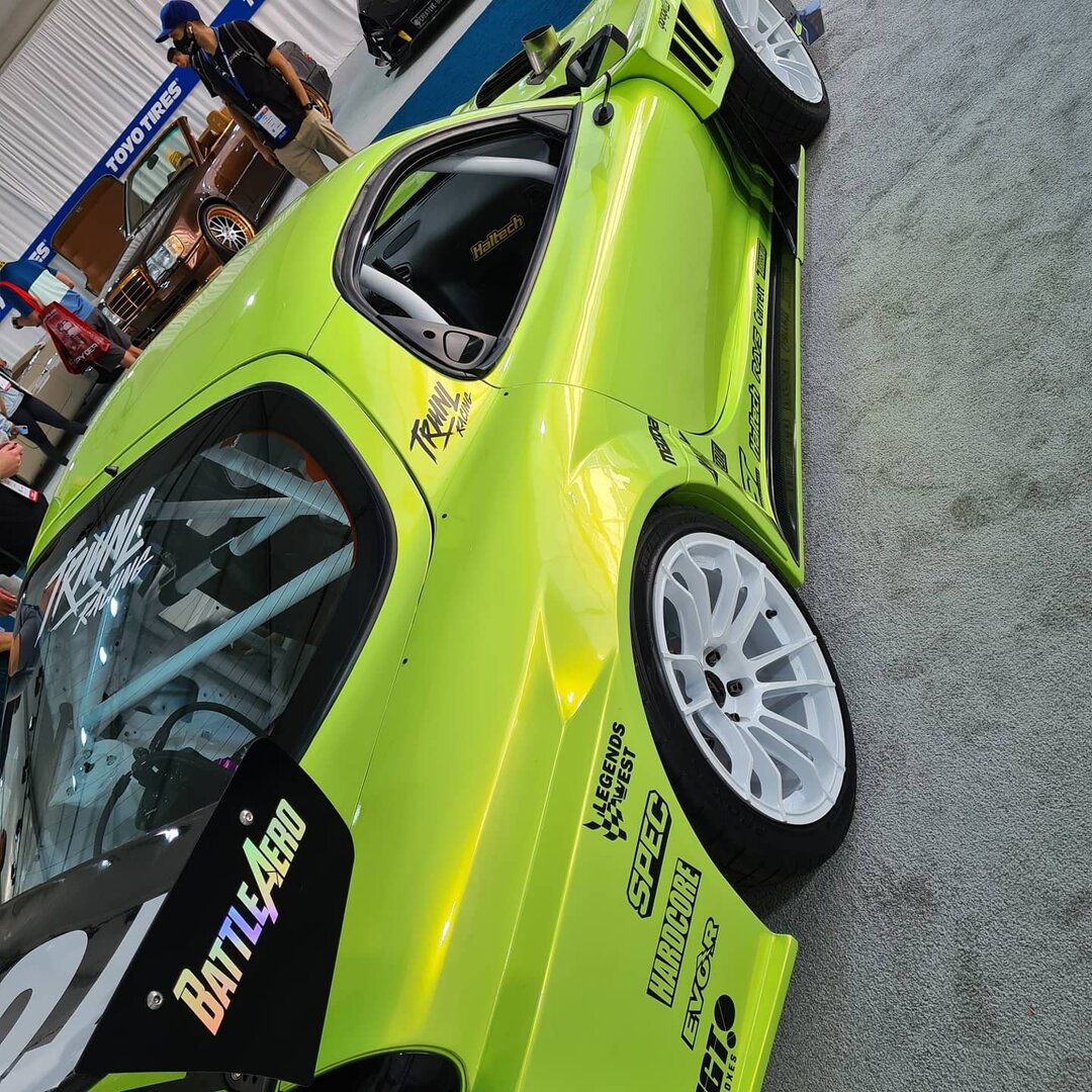

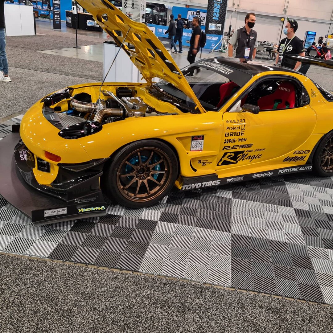

Since the last update I managed to go to SEMA show, lucky timing with being in the states with work anyway, and managed to see some absolutely epic builds, as well as a few RX7s.

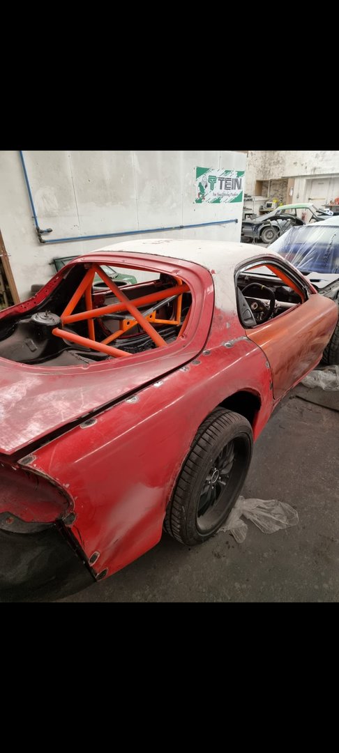

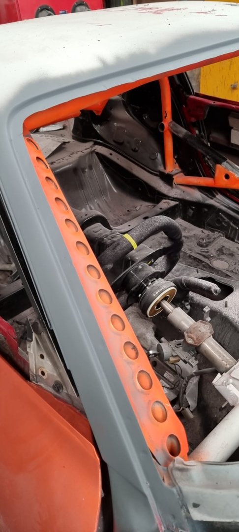

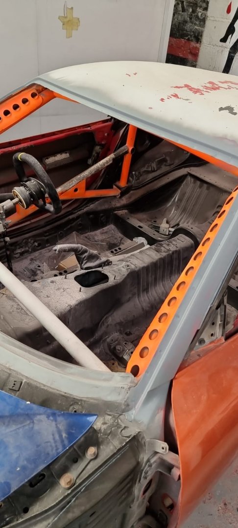

Back on to my build, I have now had the awful roll cage removed from the shell and I am currently looking to purchase a pre fab one (potentially custom cages or AST Rollcages) which will mean that by February/March, the interior, exterior and engine bay should be sprayed and looking the part! I have also had all of my TCP Magic TT kit test fitted, which has now given me an idea of how wide, aggressive and crazy this thing is going to look like next year. Only downside is that with no weight in the car and the small, narrow wheels, it looks like an off roader.
Mate looking good I've got to do the same thing as well and chop my cage out, all for the better though more safe and professional fitted
