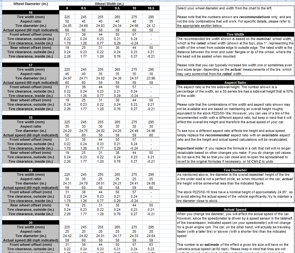

So i have this Excel spread sheet (I copied it from rx7club.com) that calculates rim to arch & suspension clearances. You can vary the diameter, width, offset
It also calculates the overall rolling diameter of different width v profile combinations. Good to keep an eye on if you want the speedo reading true.
Just can’t figure how to attach it of even if admins would be happy for me to share it. But here a screen shotView attachment 5987
Thnaks for posting this, it will prove very handy going forward
This is incredible information, sticky deserving? Does the actual excel file allow you to play with different offsets and recalculate the clearances? Can anyone confirm its accurate? The clearance calculations either inside and outside are very important.
I'm trying to work out potential new wheel specs and it's a minefield. You look at so many things others have done but add variables like wheel spacers and even the different shape of a sidewall on one tyre over another makes a difference...
