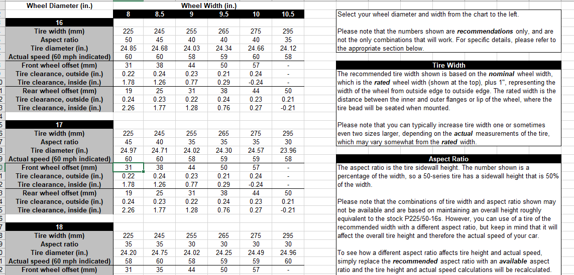

I've got this excel spread sheet specifically for the FD. You can plug in different options and check clearances.

Could you pm me the spreadsheet? Does it give limits.like if I have 18x9.5 the offset is 50 but will 35 fit,etc
it gives clearance to the outer and arch lip and inner (shock shaft i believe it is?).
