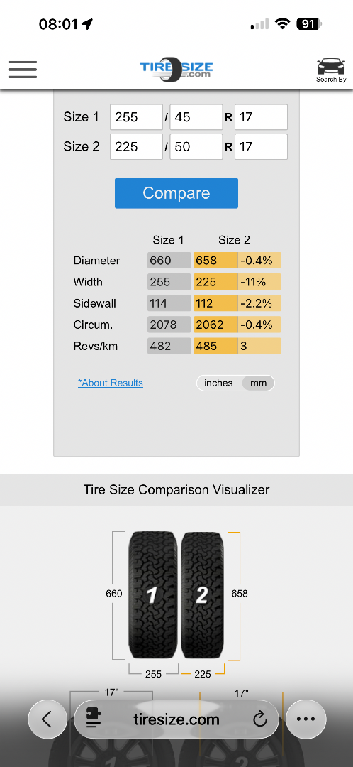

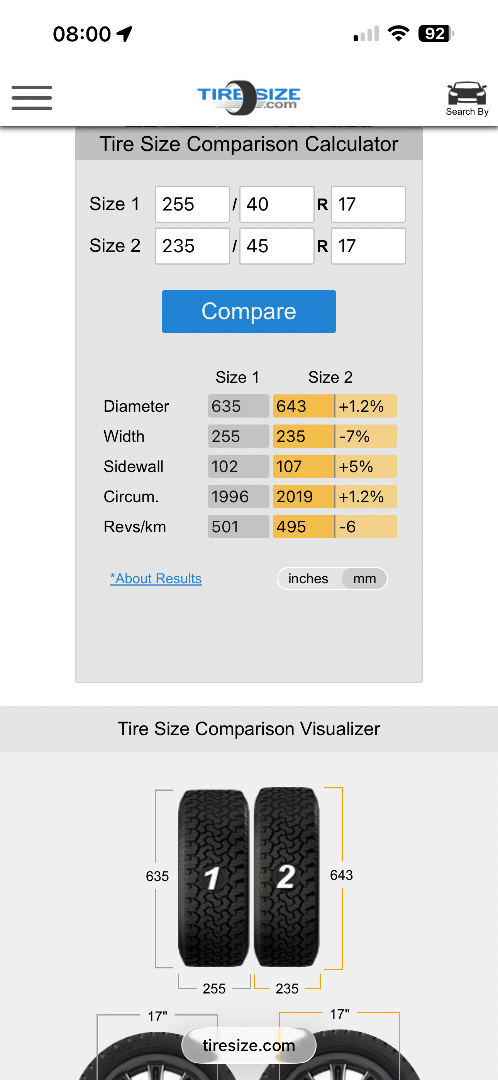

I can get ad09s in 225/50 17 and 255/45 17.
Compared to oem size. 235/45 17 255/40/17
The slightly narrower front tyre is closer in diameter to the 255.
Anyone run similar to get a decent selection of tyres?

Its 25 ish mm taller than the oem size.

Decided to stick with oem sizes. Didn’t want the hassle of informing insurance ect.
Also checked my speed display against a calibrated gps unit. Its bang on. 70 is 70. Increasing the radius would throw this out and would under read. Which is a non compliance with uk law.

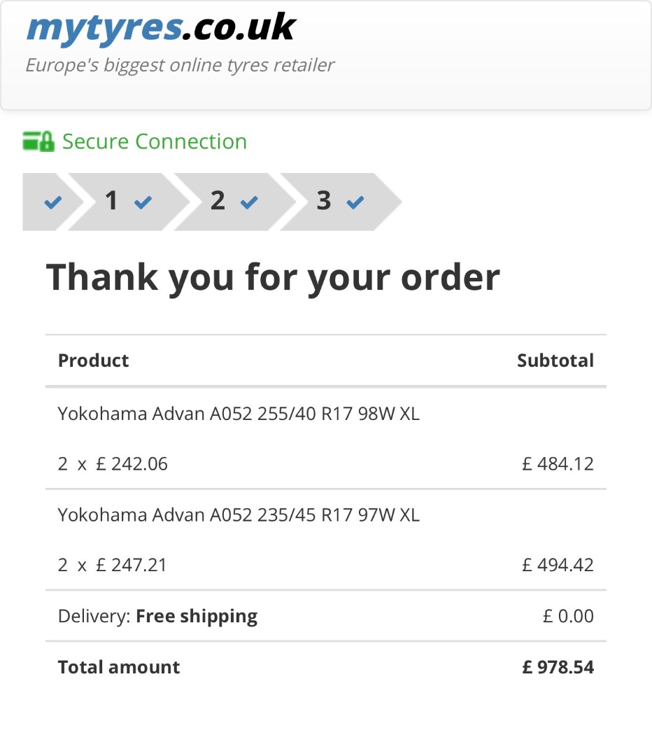

Decided to empty my wallet and gone for Yokohama advan A052.
They were fantastic on my impreza and weren’t over the top with road noise or excessive wear for a track day tyre.
Best price I could find delivered. If anyone is looking for some.

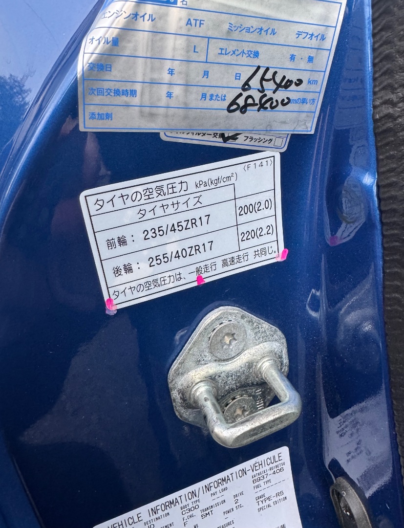

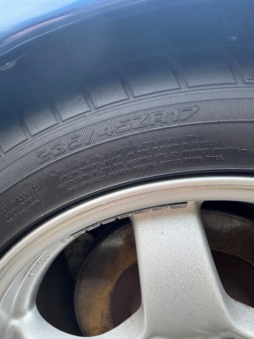

Not on a 99+ spec car. It came with 17s.
Oem sizes re 235/45/17 front and 255/40/17 rear.
No one brand top drawer brand does tyres in both sizes.
