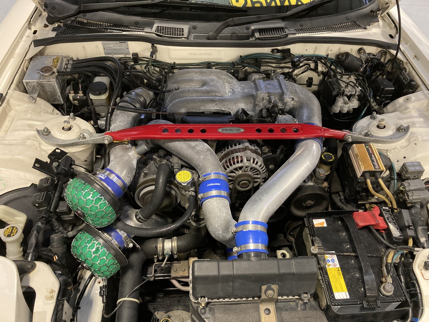

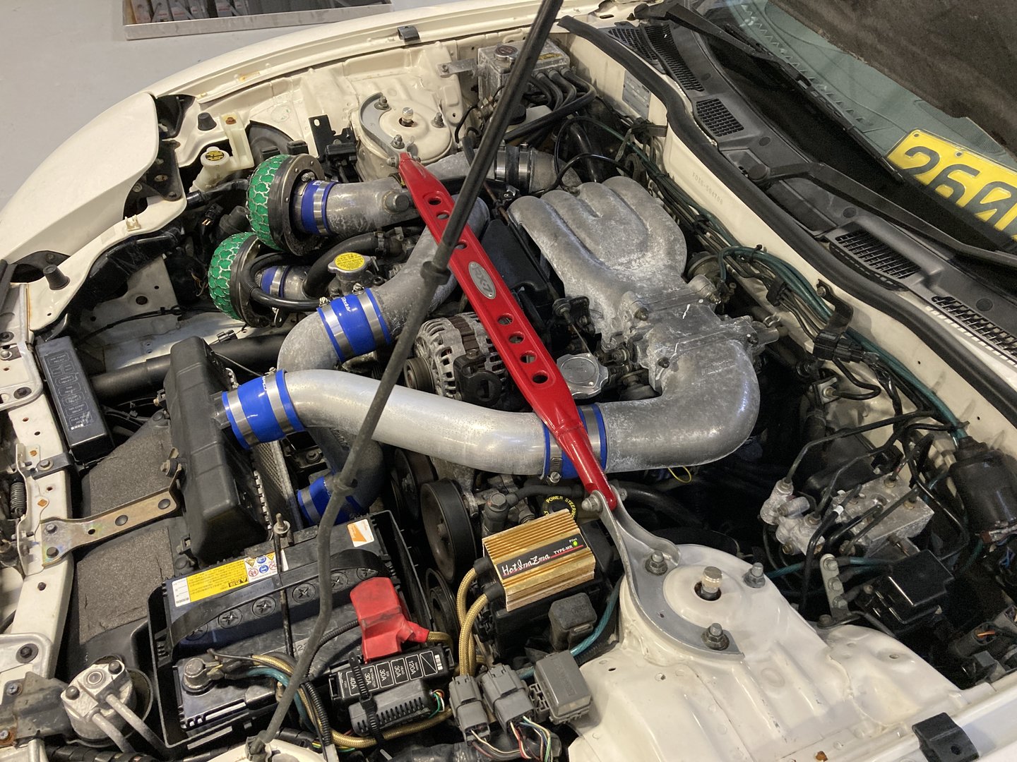

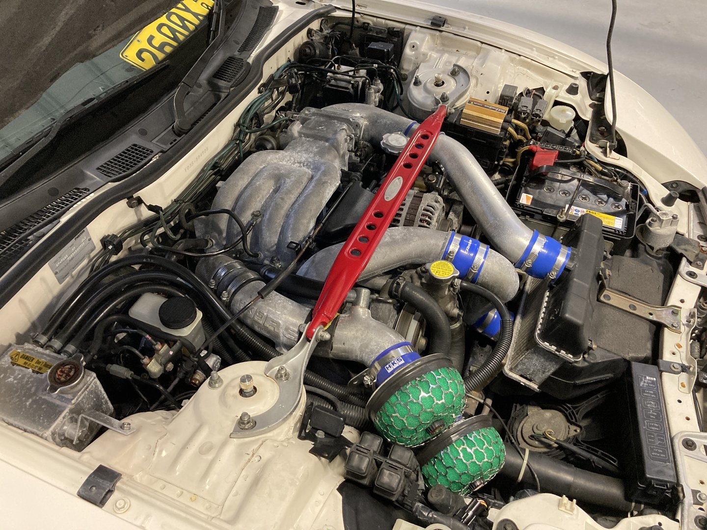

Mod list and pic of the bay would help.

Photos attached of engine bay.

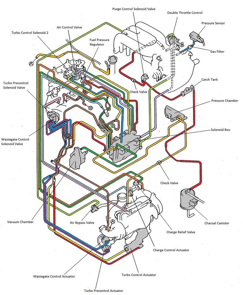

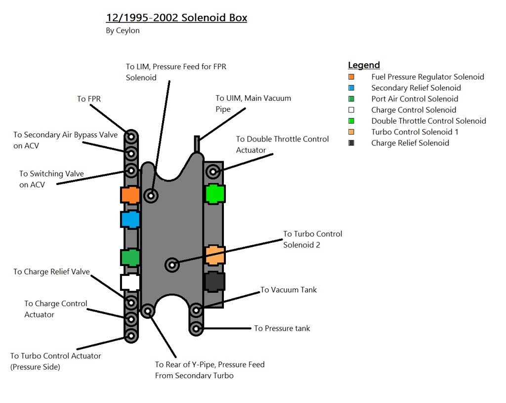

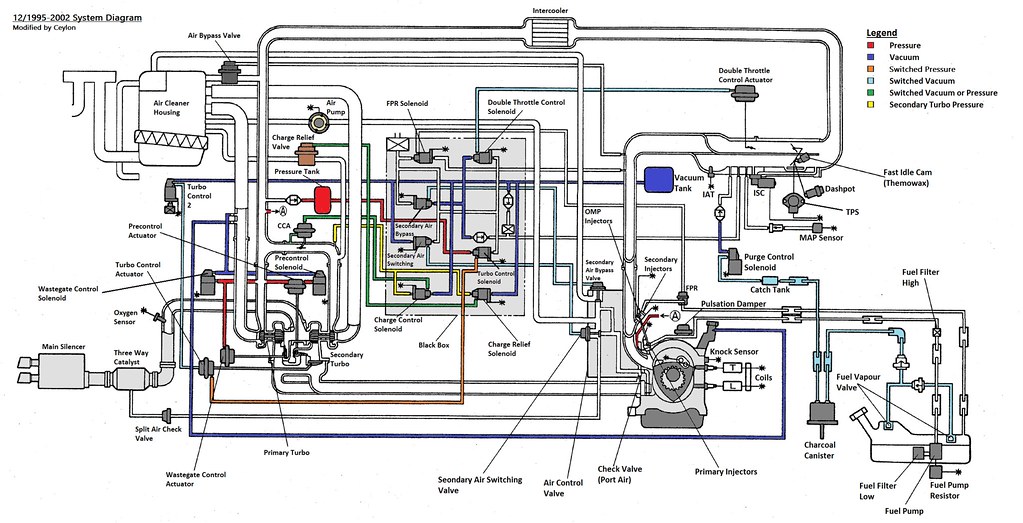

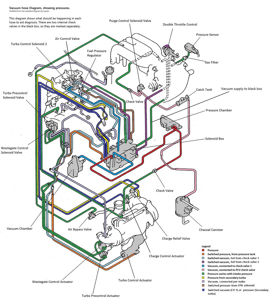

By chance would anyone have a detailed photos of the lines . connections from the wastegate control solenoid and the pre control solenoid to the small 5 line manifold. I need to ensure this is hooked up correctly.
