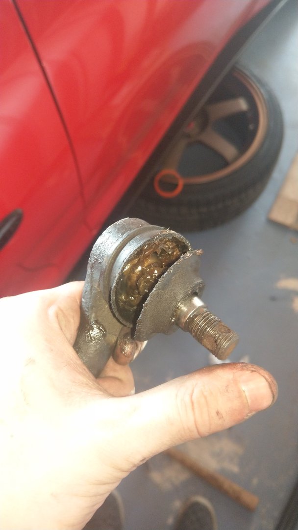

Quick question, I've just fitted the blueprint oem style outer steering tie rods today. Iv seen nothing saying that I should have pre greased them . Do they need to be?
Pictures of one of my old tie rods..i think they needed doing šŸ˜‚
Don't normally need greasing no. They come sealed for life normally.
I did buy some for my lexis that had a grease nipple in. Google told me you can keep topping the grease up and it would in theory last forever.
I have bought new ones, was wondering if u grease the new before going on was all, but by the sounds of it they don't say on the packaging to grease them, so assume that they're already done
