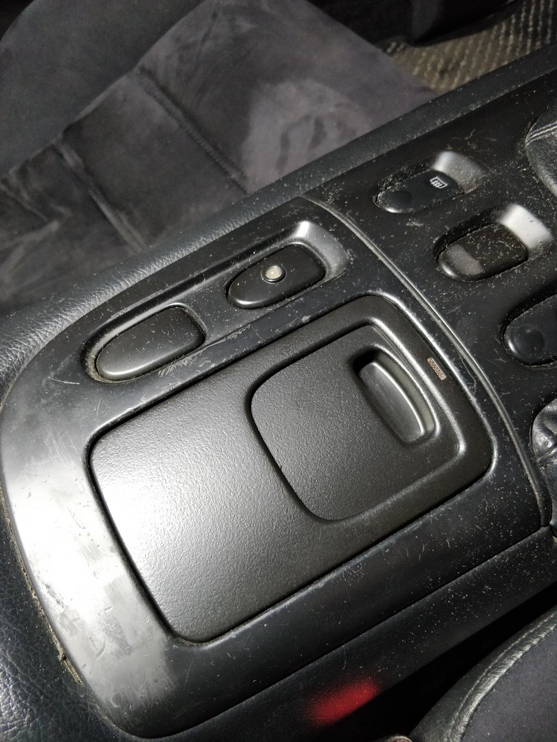

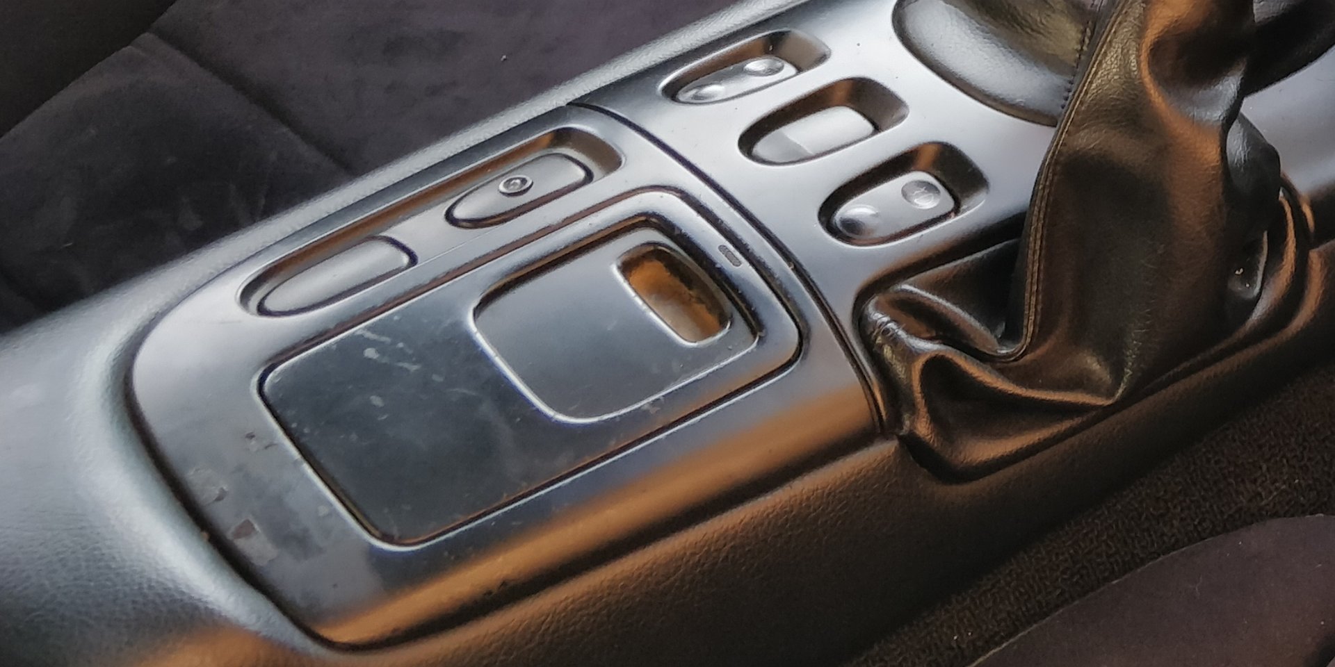

Hello,
Has anyone attempted to refurbish any interior plastics (center console, radio surrounding).
There's a few marks and scratches on my trim so I want to tidy it up.
What products have people used to try and get the OEM look? I am also interested if people have attempted the later spec grey colour.

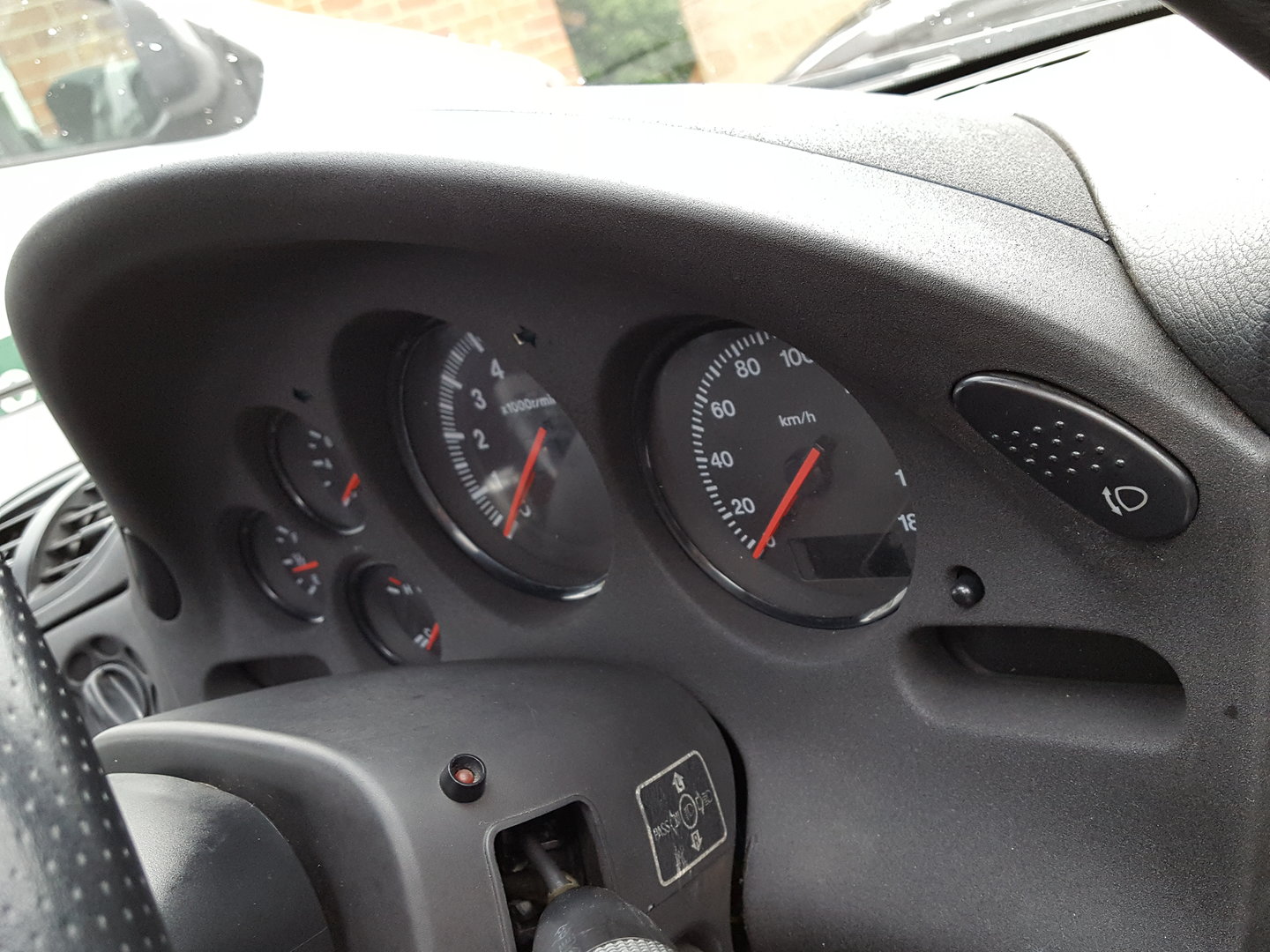

Used plasti-dip as well. Plenty of light coats. Leaves a textured finish similar to later models. Done the dome, dash, heating controls, radio surround, centre console, ashtray, and arm rests.

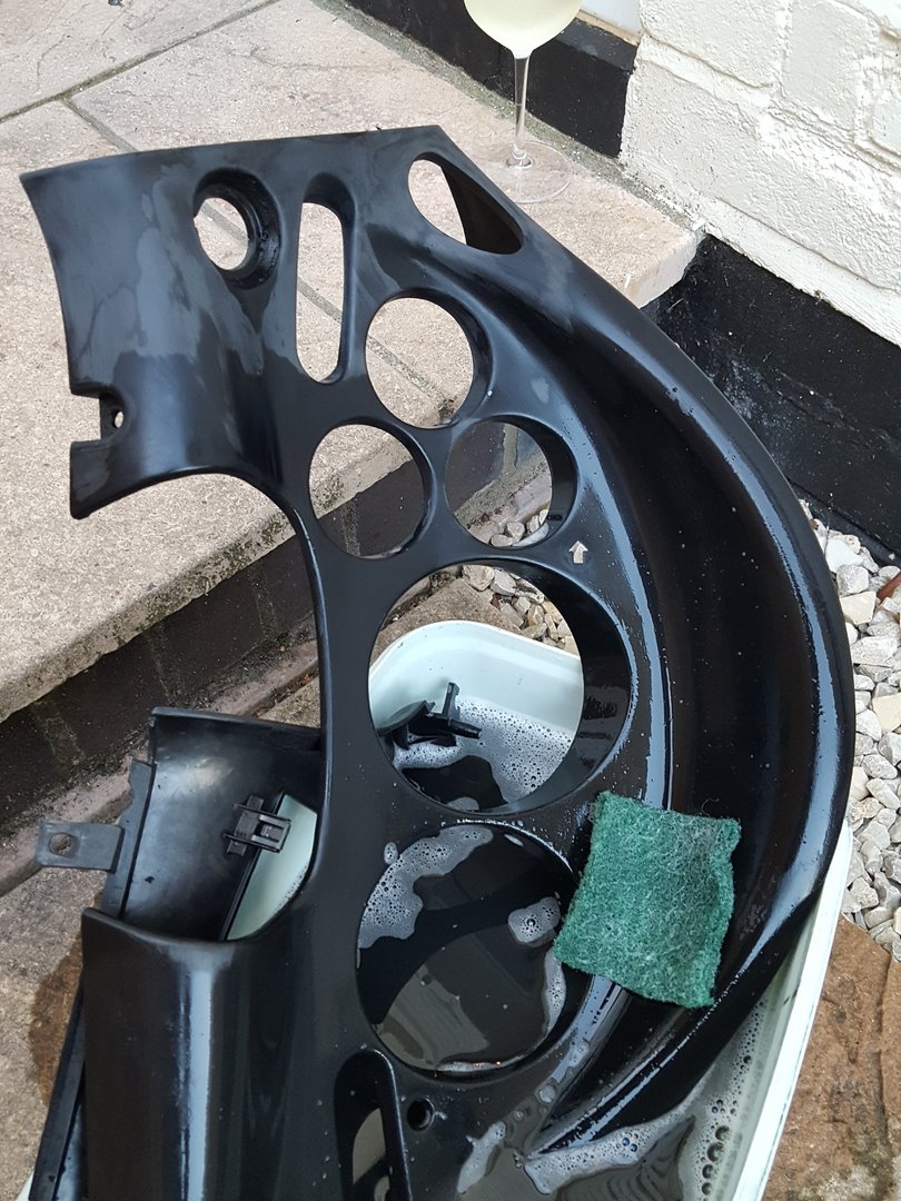

Mine need sanding

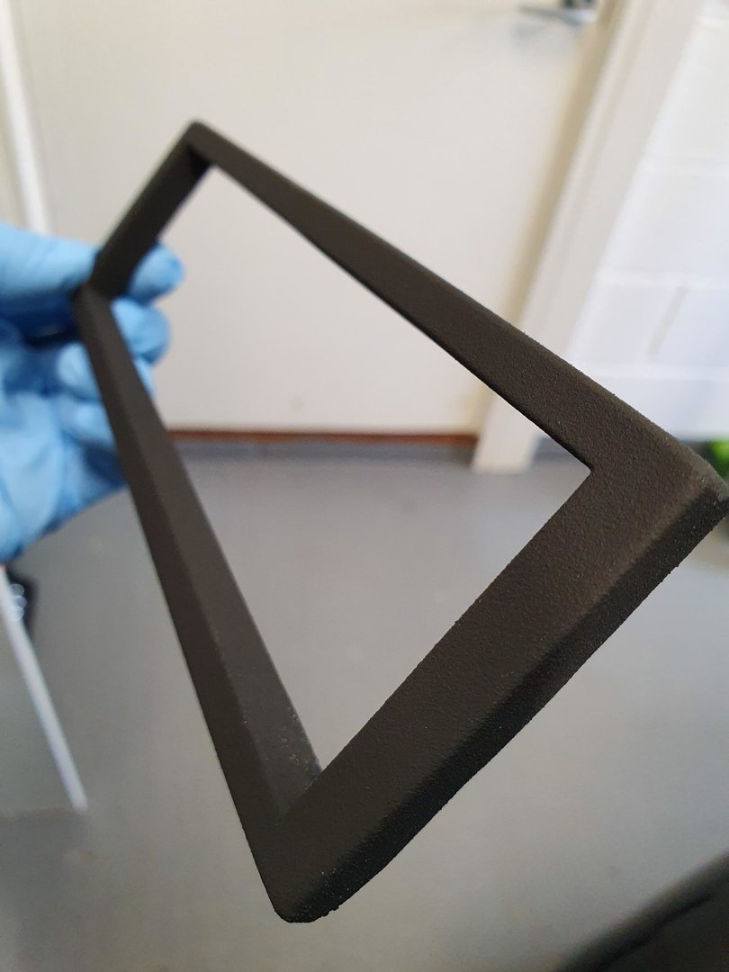

My can of plasti-dip arrived earlier so I just quickly did the ash tray and thought I'd show the results.
Pretty happy with the results as I only had 60 grit paper and wirewool.
Looks good! Decent texture to it. Does it seem like it will handle bumps/scratches etc?
although.....that bumper trim paint looks to be the ticket when it comes to endurable finishes
