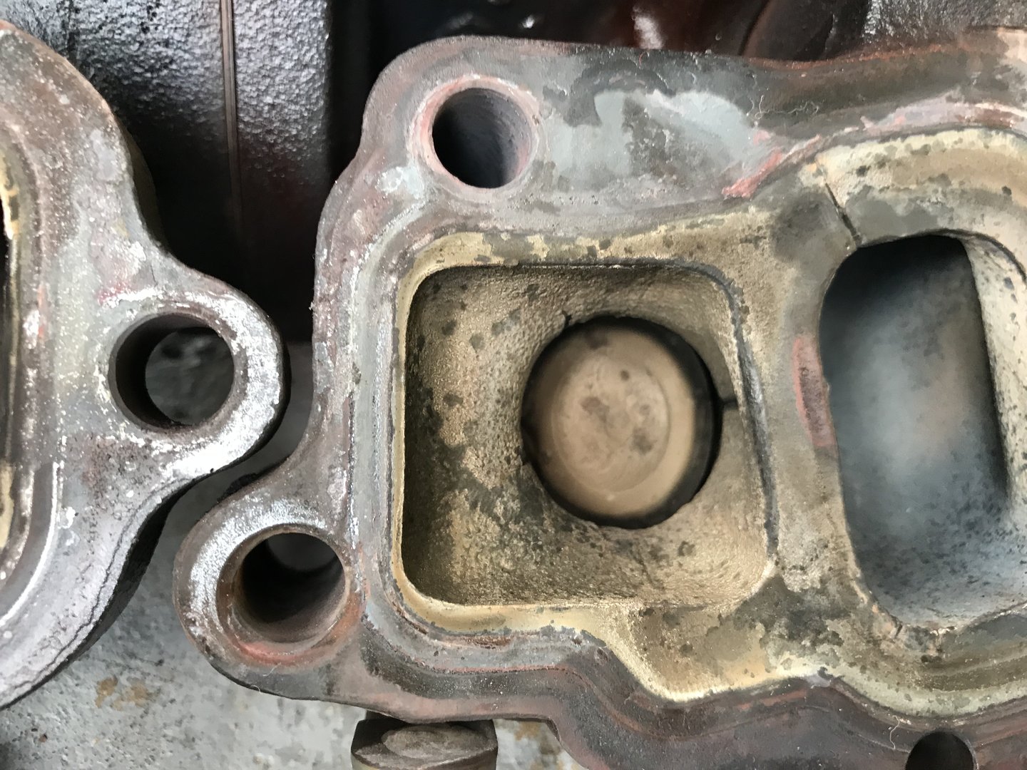

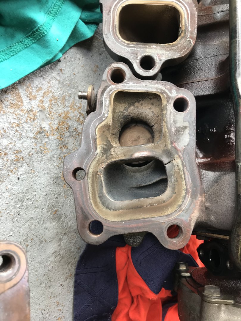

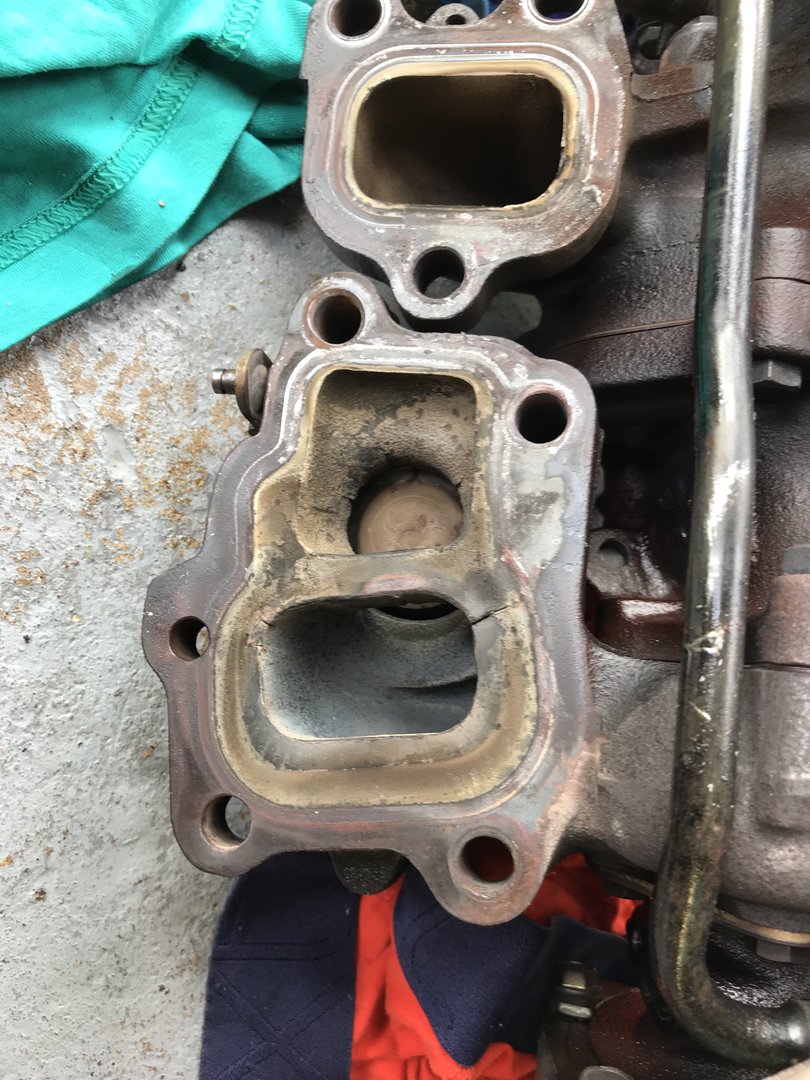

Hi guys I’ve taken the twins off trouble shooting a misfire when the second turbo is supposed to kick in it just doesn’t, anyway This is the state they are in I don’t really want to go to single turbo so need help on what options I have or if anyone has any for sale ?
Tbh they don't actually look that bad. I'd maybe try getting that crack welded up over buying another mani!

do the cracks not effect performance ? surely with the cracks there that flaps not blocking off when its supposed too and in turn the secondary turbo would be spooling more than its supposed too at the pre spool stage ? yes I do expect I have the same issue but after pressure testing and vacuum testing all the pipes to the solenoid box I wanted to see everything was mechanically ok with the turbos and flaps etc. the problem has got to be something really stupid lol but im enjoying finding out how everything works haha

Yeah you'd defo have a boost issue with cracks but as neil says, if I recall, his were absolutely dusgusting and he was boosting 18psi on his twins wasn't it neil?
Obviously now yours are off you'd defo be wanting to look at doing something about the crack you have, but personally I don't think it would create 'no secondary boost' you'd just be seeing something silly like 6psi! As I say, I'd personally look at having it welded as it's in pretty decent shape and also you have no oil leaks or shaft play which is really good!

Yea I’m going to see if I can get it welded by someone, I don’t think this is the problem with the car though. I’ve tested all the fuel side and all is ok so it’s got to be something like a boost leak as it idles rough sometimes hunting and then full throttle it starts to miss around 4K when the second turbo is supposed to come in. It’s almost like the Ecu is throwing the fuel in as there’s either too much air going in so it’s trying to compensate or there’s just no secondary turbo kicking in and the Ecu is putting fuel in as it’s thinking the turbos working but it’s not getting the air.

Those cracks wont affect performance yet, but I'd be tempted to try and weld it up if you've got the time.
Grind down into the cracks until they stop, make a V shape and weld them back up with a cast specific rod. I think when I last did some I preheated the entire hot side and cooled it all down slowly to try and avoid cracks, worked pretty well.

Yeah 17-18 psi and were still pulling hard when i removed them. Those cracks won't affect performance at all but obviously while they're off, might aswell fix it.
Your boost issue will more likely be a control issue rather than the twin pack itself. While it's off though check the actuators are working correctly as they cause secondary issues when they fail.
