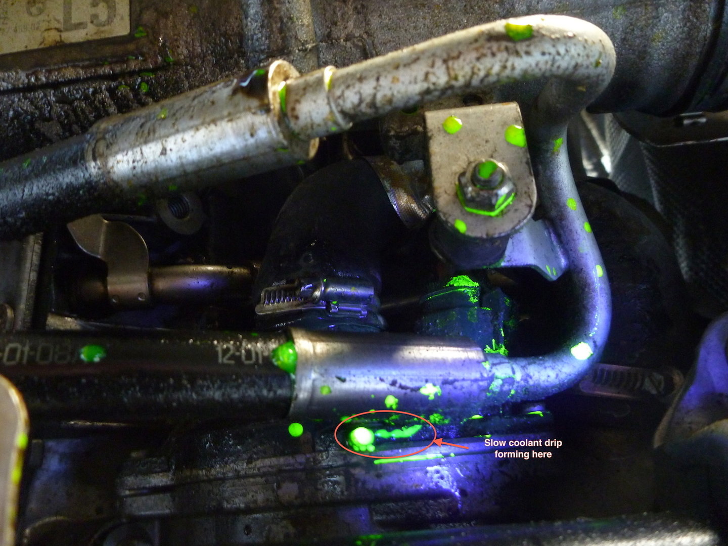

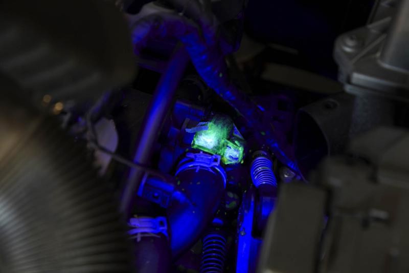

Have you tried a pressure test? you can buy UV Dye to put in coolant to identify leaks easily if your stuck

works a treat :)
I reckon gav is onto a winner there! Personally I'd buy that or even for the price of a pressure tester I'd buy one of them as they're only 20 quid or so on ebay!

Thanks guys, ive just bought some of that uv dye and im going to give that a try first .
Thanks for all the help il keep you posted with the outcome😀.
Just to recap on this, i put the uv dye in the system and no leaks were found 😟.
