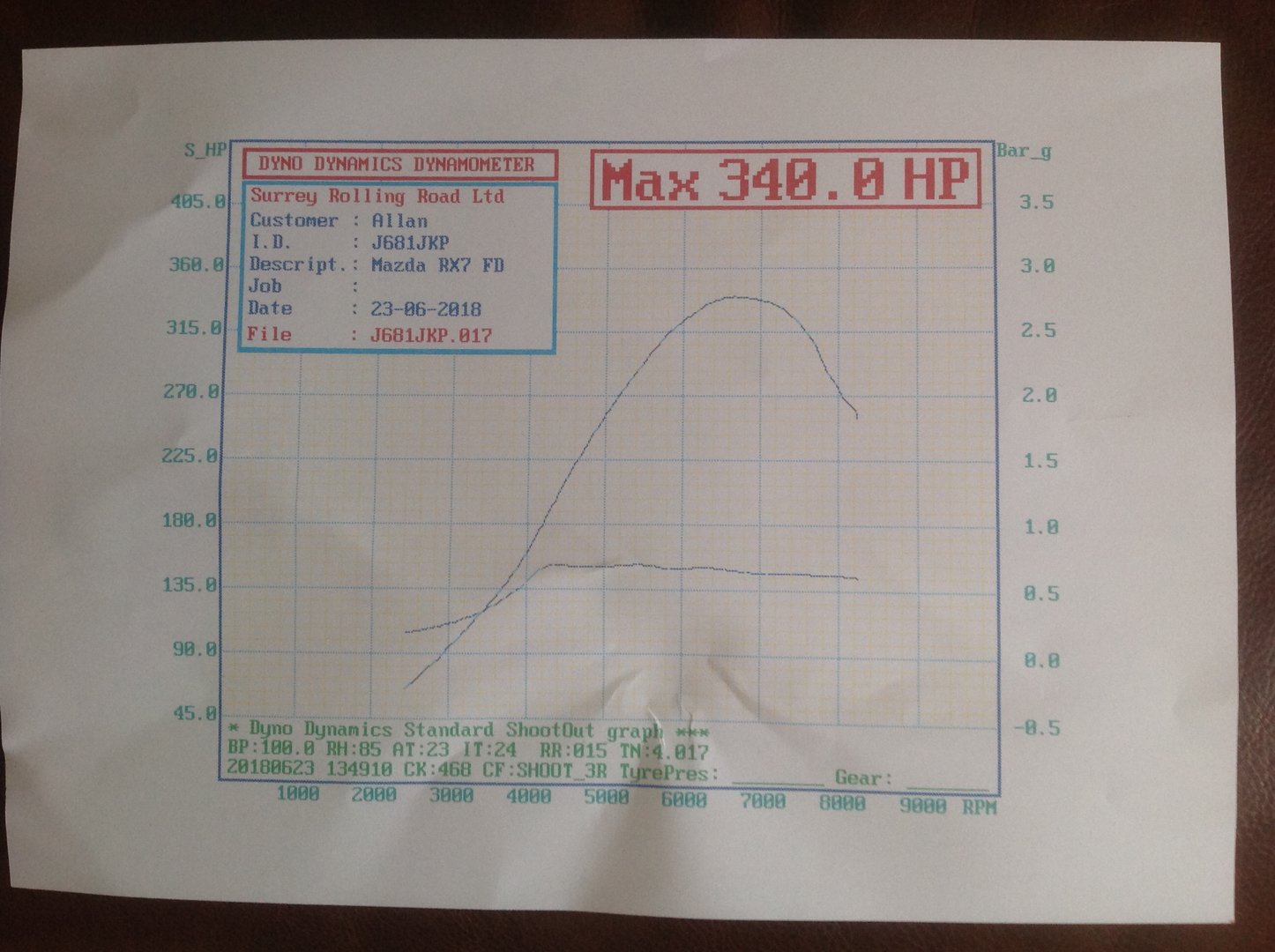

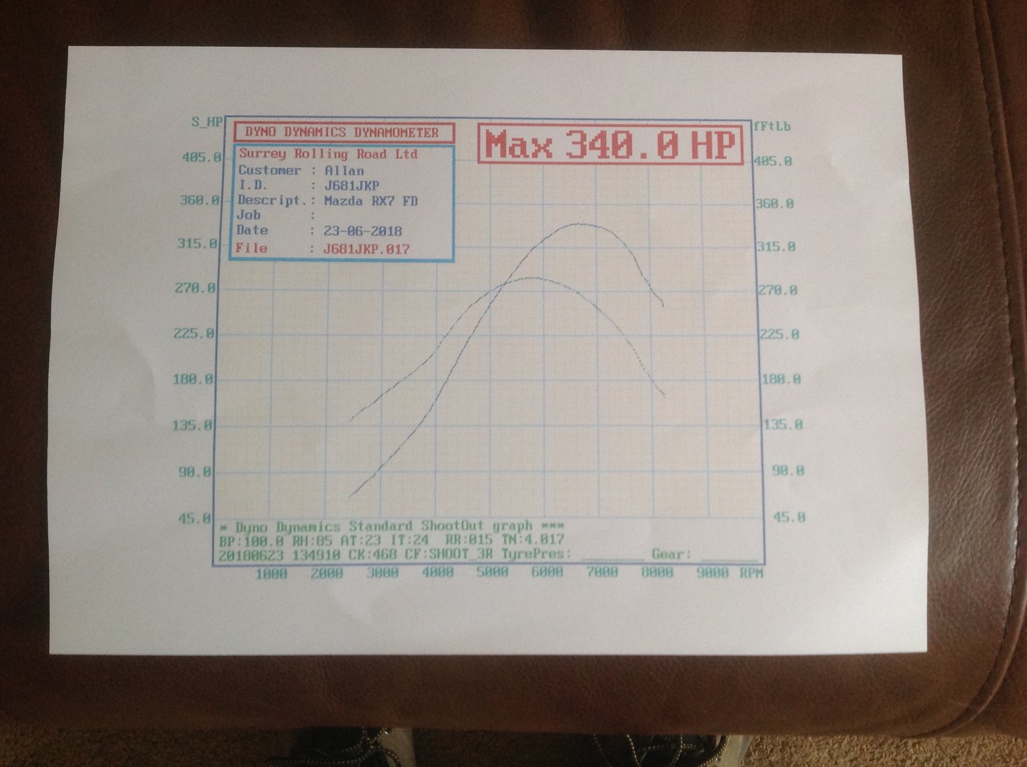

Had the 7 mapped at Surrey rolling road on Saturday to ensure she was set up correctly for a couple of track days I want to book, i am glad I did
as Marcos said she was running very lean, she feels a lot more responsive higher up in the rev range and I was very pleased with the service given
by Marcos and Mark.
Marcos has posted pics of the car on Facebook with the comments as below, I am currently very happy with the performance of the car but
will probably end up looking for more, as you do.
Mapped this small turbo To4e stock port car to day only 0.67 bar , 340 fly, no extra fuel available to up boost , owner will be back, plenty of scope for more power
Forgot print outs
