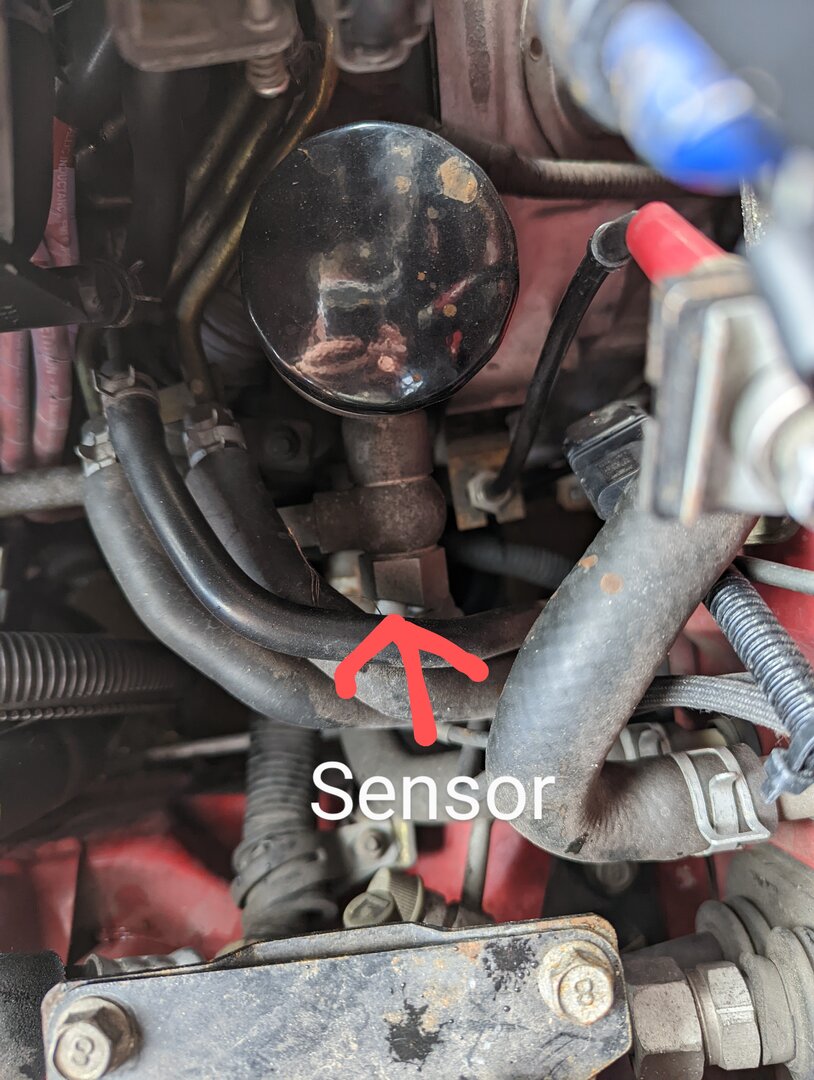

Hi All, My first post on FDOC UK!
I imported my 99'FD RX-7 last July and after a number of issues with the car and DVLA managed to get her on the road.
However, whenever I'm driving it the oil temperature is rather low. When cruising it hovers around 65 - 75 C and on the motorway sits right around 60 -65.
Driving very spiritedly i've seen around 85 - 90 C max which is still not the highest. I feel like its a little low, especially if I want to get on it when I've been cruising and wanted some opinions.
The car is running V mount and has the twin oil coolers. Its running the stock Twin turbo's in parallel rather than sequential with all flaps removed.
My questions are, what do other peoples FD's run at oil temperature wise when cruising and driving spiritedly etc.?
Should I worry that the oil temperature is quite low like this?

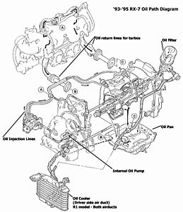

I've done some research and found that the stock FD oil thermostats open at around 60 -65 C which matches what I'm seeing.
The Rx8 supposedly has the same thermostat in the oil cooler, however this opens at around 105 C which I think is a bit excessive.
However in the states there are a few companies making thermostats which open at around 80 C. This sounds like a nice temperature.
Has anyone else looked into this or should I just stop worrying and drive the thing?
Thanks in advance
Ryan
