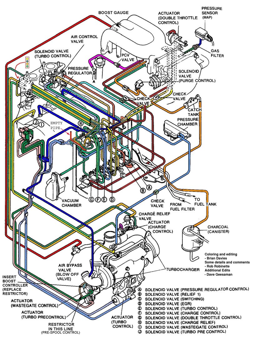

If the vaccume hose on the back of the boost sensor was connected to the wrong pipe on the rats nest could this cause it?

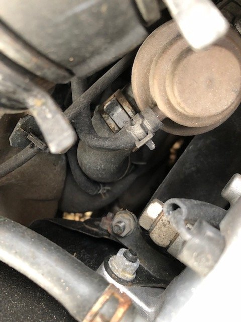

We did a little bit of investigation yesterday and found one of the vaccume pipes disconnected from the side of the throttle body.
I’m sure there was another pipe with no hose connected also.
We will do a bit of digging and look.
Has anyone else had this issue?
Spark plugs, ht leads. Is it stinking of fuel more than usual. Hunting idle could be a vacuum leak from anyone of the vac pipes
Wrong hose on the map sensor could certainly be your problem. Tbh this sounds like a culmination of issues

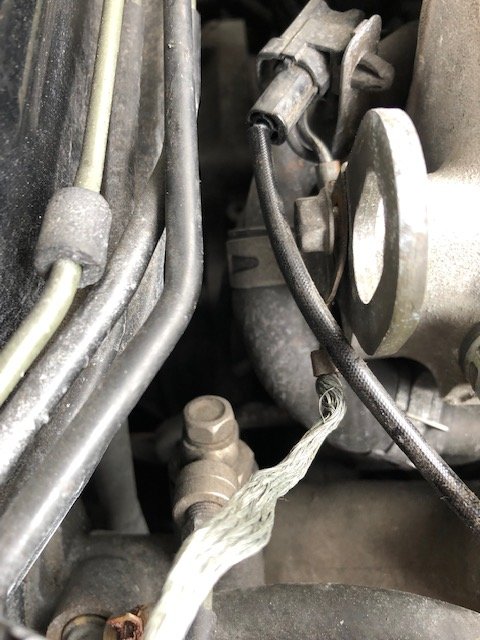

On the Car SOS show Hurleys doing a pressure test, when the vehicle went to Car SOS it didn't Hunt or have any idle issues, its come back really lumpy and with the issues, we also found one of the HT leads not connected correctly and on valve pipe from the rats nest disconnected. the engine earth at the top of the engine near the lift mount and the fire wall was also not correctly tightened, we have sorted this.

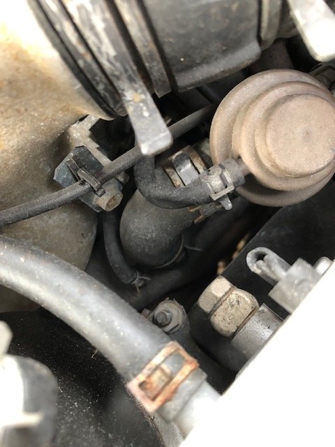

looking into at the Y pipe we have found this pipe crushed and brittle this will be replaced ASAP but what does it do?

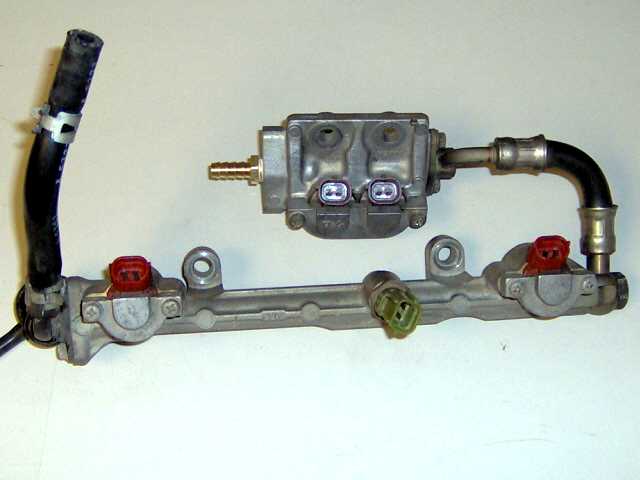

can anyone tell me where the fuel thermosensor is?
we are getting all the vacuum pipe replaced Monday.
Cool diagnostics tool.
Fuel thermosensor is in the fuel rail under the UIM, green backed connector. Have you checked if the idle screws are all set properly? Is the TPS in range?
fuel thermostat sits in the secondary fuel rail green plug

just a quick question. is the water sensor the same as the fuel sensor?
I've called mazda and they said the have the water one but can't find the fuel version?
Will have a look at the part numbers tomorrow for you
Yes, exactly the same. Also interchangable with the Supra temp sensor.
