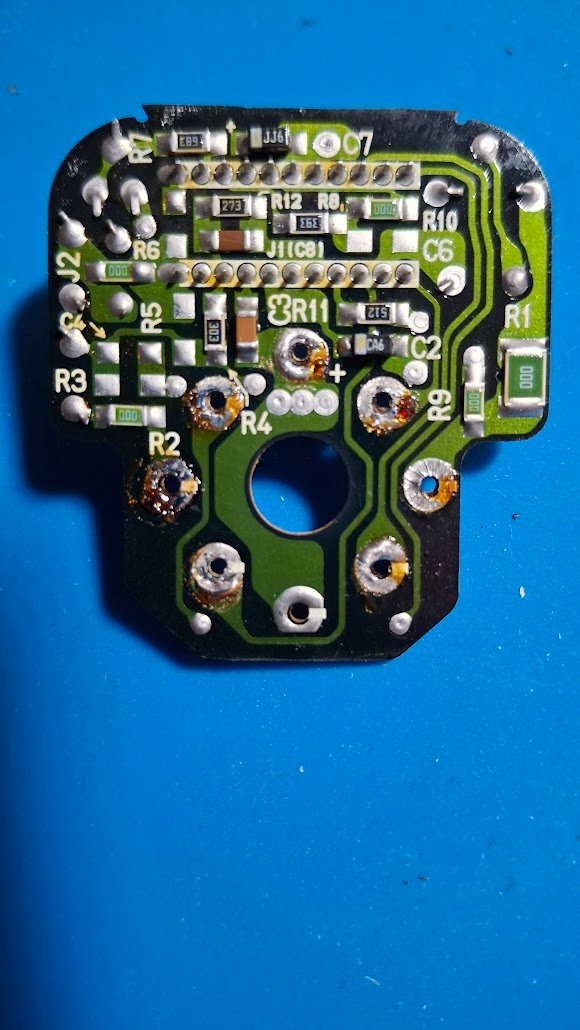

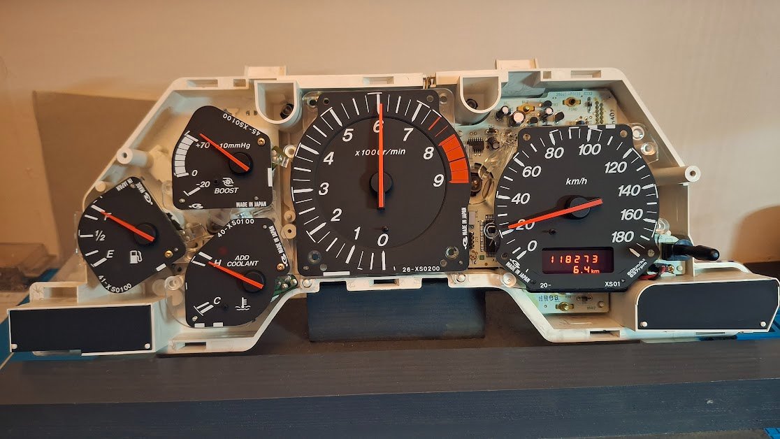

Wow, it worked! Picture of cluster on test rig where I soaked tested the tacho at 6k rpm for a few hours, plus a pic of a tacho PCB for reference.

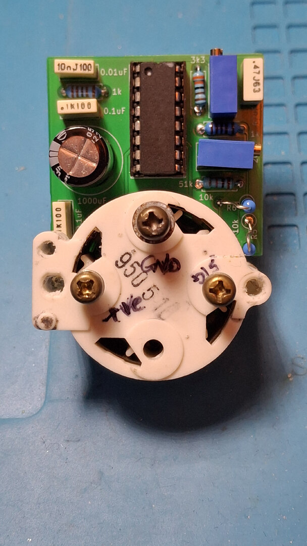

However, I now have a fully tested prototype circuit to replace the entire tacho PCB. It works brilliantly, using all new components. I'm currently at the stage of laying out and designing a suitable PCB to fit on the back of the tacho gauge, before getting a batch made. I have already invested in the components needed to make up the 10 boards, having seen reports of so many tachos fail with similar symptoms.
Realistically, it will probably take me until late January to have the first PCB constucted and fully tested. Watch this space.

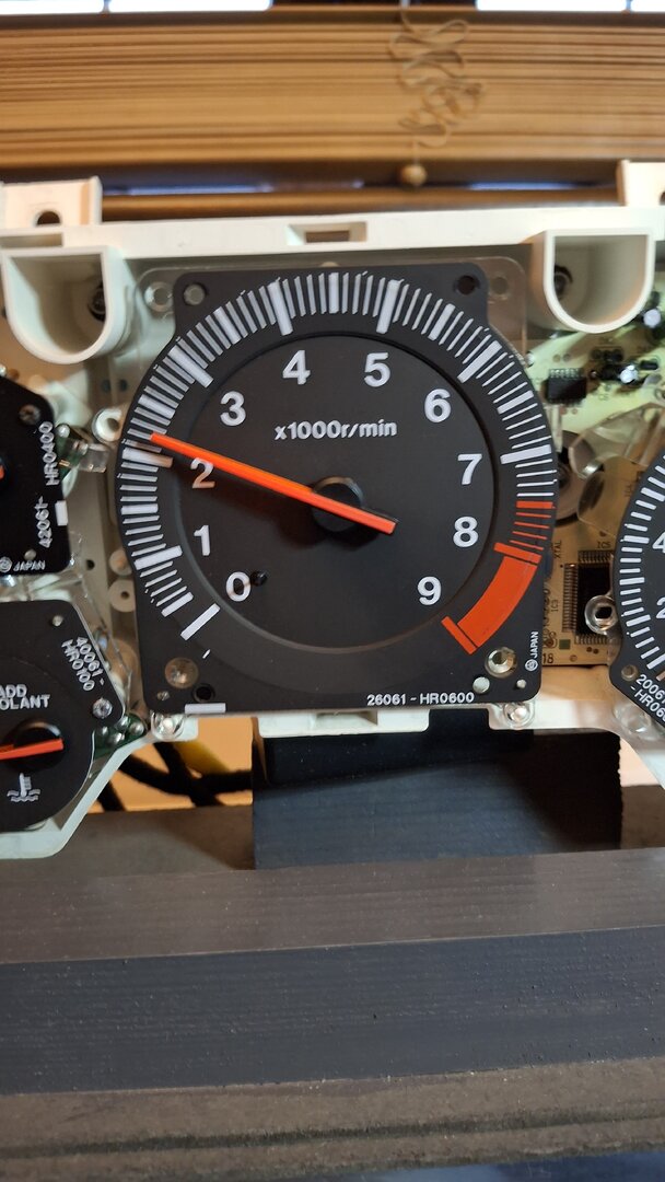

First pre-production replacement tacho PCB completed, benchtested and installed in a cluster. I'm very happy with the operation on the bench and also in a cluster on my test box - calibration is excellent across the full rev range, well within 5%.
I have 2 customers lined up to do some testing in their cars. Once I'm happy that all is well in those 2 cars I will offer these out to anyone interested. It'll probably be on the basis of ship me your complete cluster and I will replace, calibrate and return. Including return postage, I'm expecting to offer this service for £185. Excluding my pre-production PCB and those committed to test in their cars, I have 7 sets of PCB's and components available. I can easily get more PCB's and components if there is demand. Please post up in here if you are interested, so I can gauge demand.

The first cluster with my replacement tacho PCB design is now back in the customer's FD with the feedback,
"Cluster all back in and working perfectly, thanks again"
The cluster arrived with me on a Saturday, repaired same day, shipped back Monday, back with customer on Tuesday! I can't promise I can always achieve that timescale, but demonstrates what can be achieved :)
