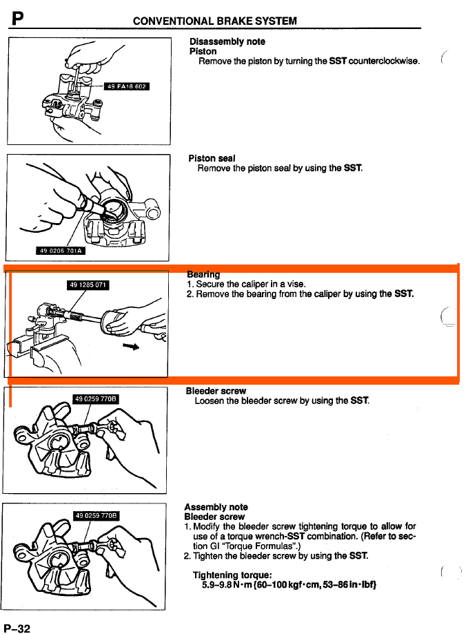

Hi all, been trying to rebuild my rear calipers since one of them had seized. When I removed the handbrake assembly and got everything out I found that the bearing was broken. The field service manuals say to replace it but it doesn't seem like most do. I've ordered a couple replacement bearings but I can't figure out how to get them out.
Anyone got any ideas?
