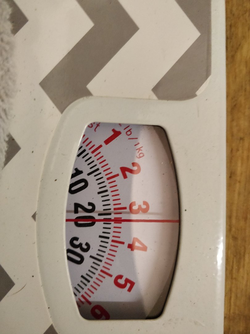

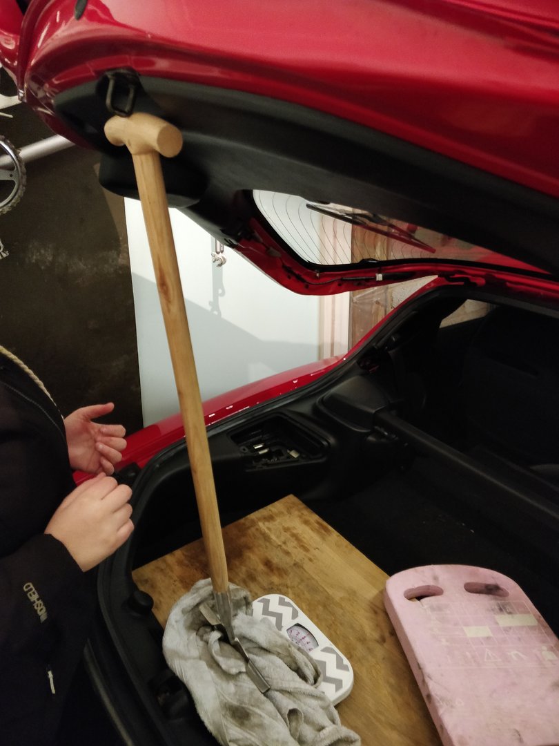

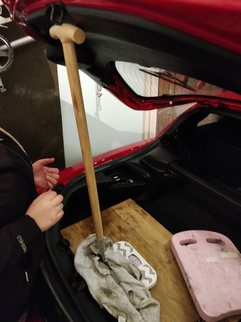

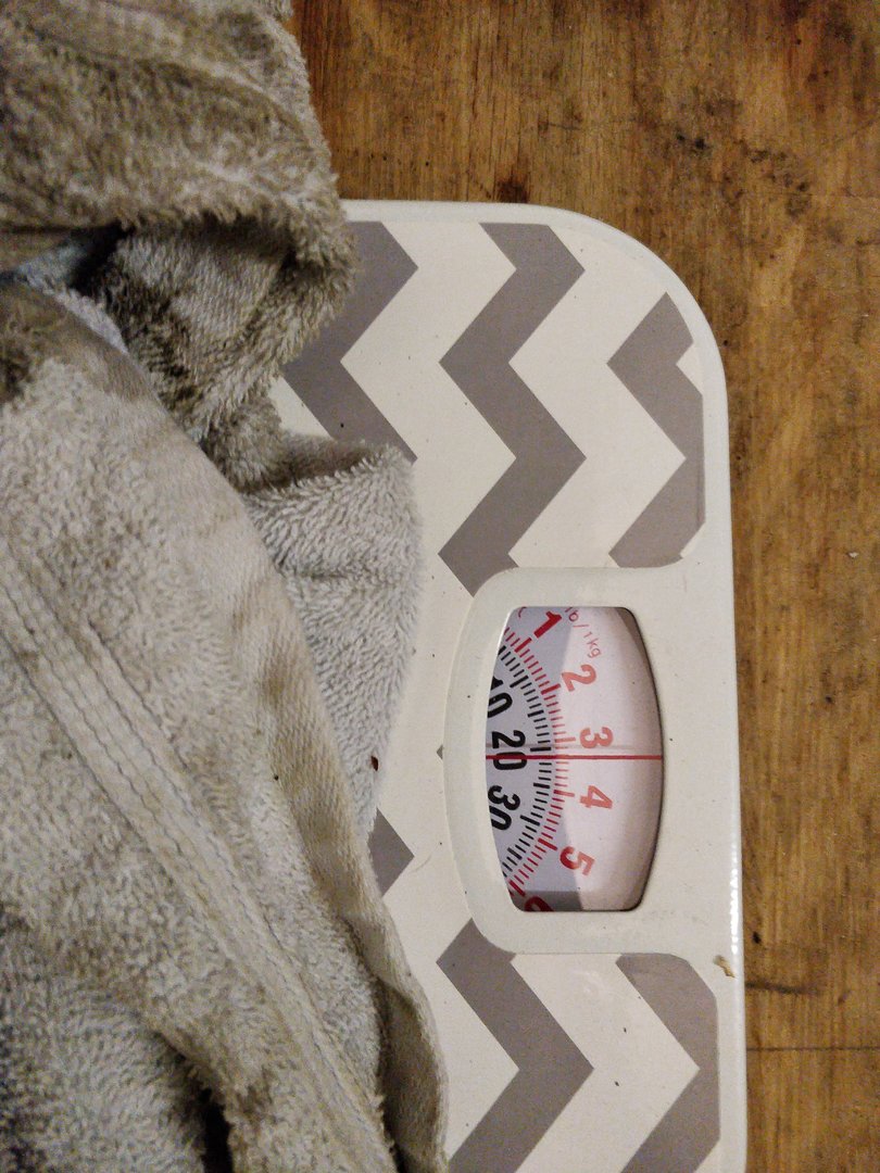

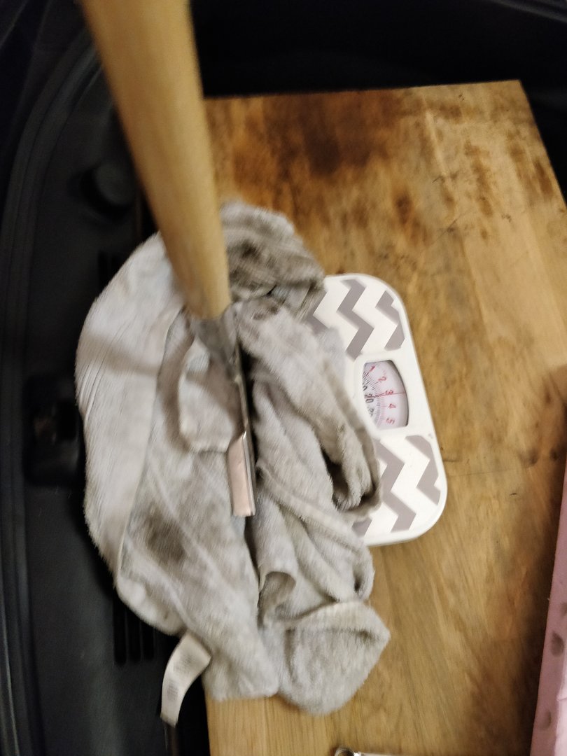

So SGS asked me to weigh the boot lid but this is the best I could come up with, anyone got an idea if this is close.....
