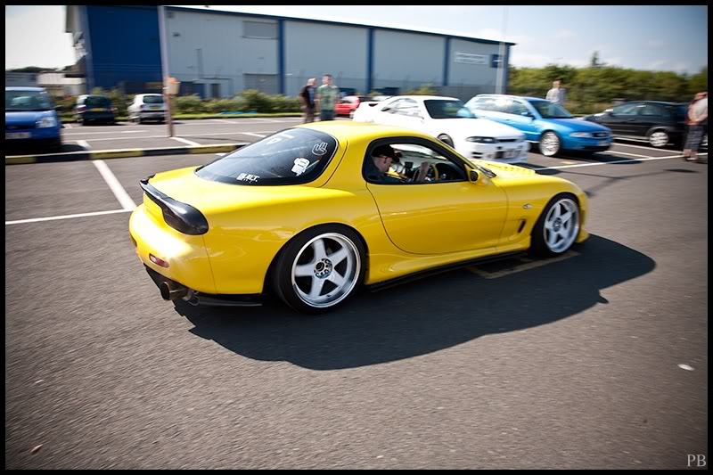

Was imported as a well specced, single td06 turbo conversion. I bought it in 2007 and looked like this
12 years later. 3 engines and many different custom modifications and variations it Is now in its last stages of completion of the current changes.

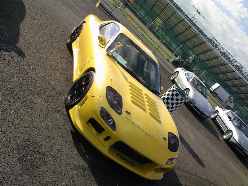

Custom 99 spec front bumper
Custom headlights
Concept 7 bonnet
Concept 7 front wings
Feed side steps
Chargespeed rear over fenders
Stock rear bumper
Stock roof spoiler
Concept 7 ducktail low boot spoiler
Custom headlights
Concept 7 bonnet
Feed side steps
Stock rear bumper
Stock roof spoiler

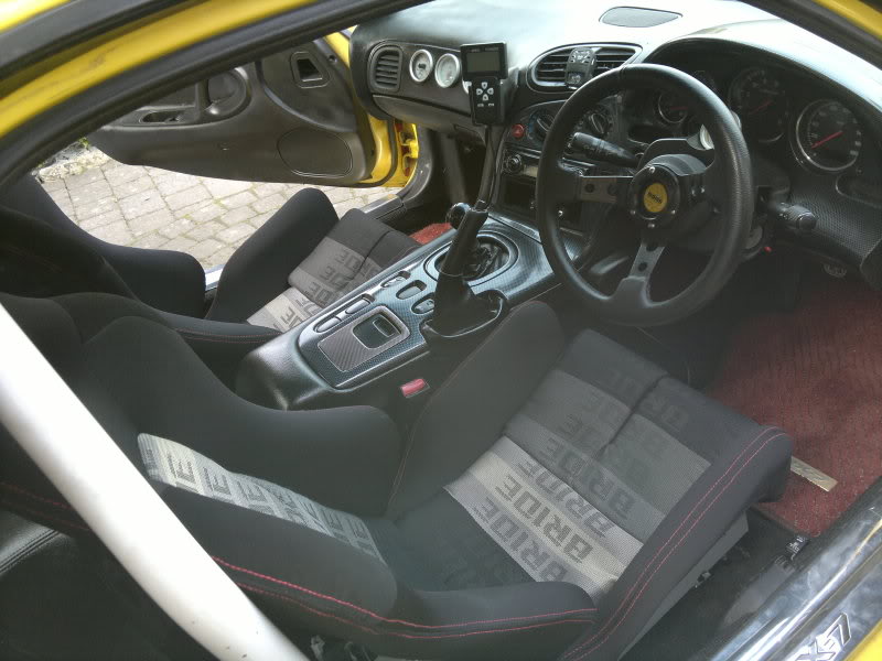

Custom Alcantara dash, centre console and door cards
Custom rear seat box for battery enclosure and some wiring looms.
Custom interior wiring loom for
Speedhut gauges
Link ecu
Tablet mounted in hivac panel connected to ecu
Custom air fuel ratio display in centre dash air vent
Stereo removed and an amp wired in with bluetooth for phone connection and music
Wireless phone charging
Custom centre console panel and door trims
Most of Heater system removed apart from on the windscreen which I have a button for in the hivac panel. along with buttons for low, medium and high boost, hazards, fuel pump, power steering, heater and rear fog.
Bride gias low max reclining seats
Momo suade wheel with quick release
Speedhut gauges
Link ecu

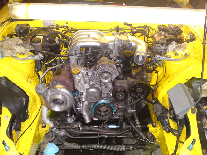

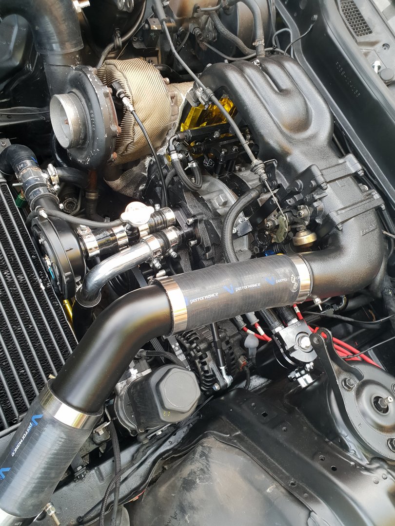

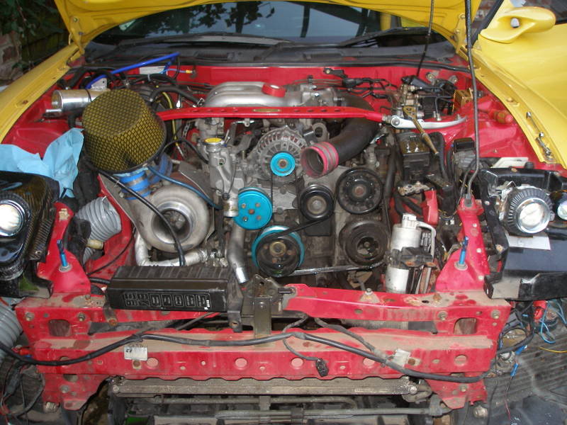

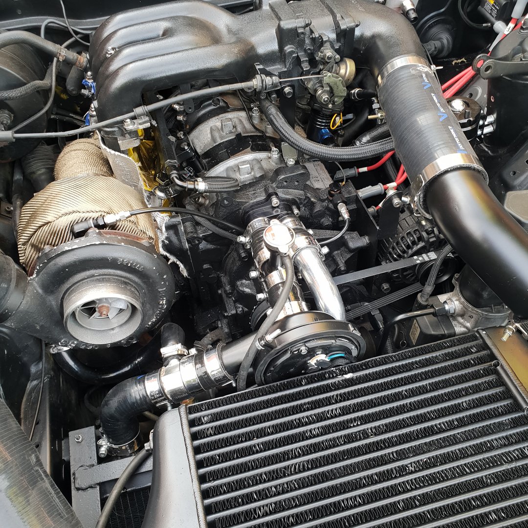

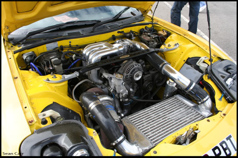

Under the Bonnet

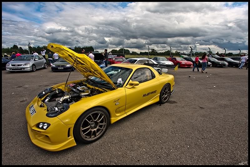

Complete rewire and aftermartket fuse and relay box relocated in the glovebox.
Large street port 13b rew
SCR apex seals
HD water seals
The rest is finished off with stock seals from what I remember. Would need to check with builder - oldone racing
Light flywheel
Twin plate clutch
Stock gearbox with re-amemiya short shift
Dm motorsport fuel rails
Bosch 750cc and 1650cc
Walbro 450 fuel pump
Custom v mount setup
Greddy t4 exhaust manifold
Borg Warner s366 turbo
Aem smart coils
FFE hall sensor kit
Electric water pump
Electric power steering
Custom oil cooler lines
SCR apex seals
HD water seals
Light flywheel
Twin plate clutch
Aem smart coils
FFE hall sensor kit
Electric water pump

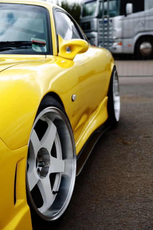

Suspension/Wheels/Brakes
Kazz 1.5 way diff
Diff brace
Kei office coilovers
All suspension arms stripped, blasted, painted green and super pro bushes fitted.
Custom heim jointed drop links
10j et12 rota gtr-d front and 12j et-5
ABS removed
Stock (to be evo brembo's) with 356mm discs
Diff brace
ABS removed
