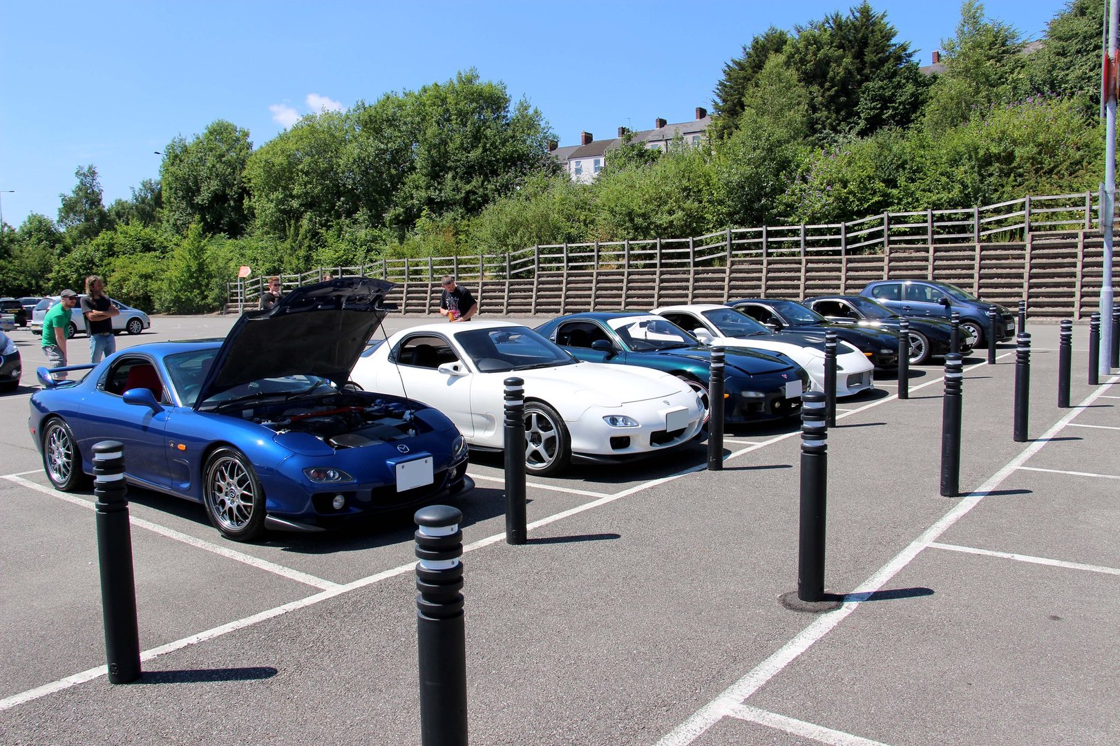

General Information
Probably my favourite of the four FD's I've owned. Modded to be an easy to drive, fun road car, retaining all creature comforts.
Exterior
Standard late bumper, splitter, fog lights and spoiler.
Spirit R type A rims with 15mm spacers.
Spirit R emblems.
All lighting converted to LED.
Full, all panels off and glass out respray in original colour (Innocent blue mica).
Interior
Spirit R carbon-kevlar tilting Recaro bucket seats. Fitted with custom ESH red covers with grey double overstitching, side protectors and memory foam cushions.
Spirit R steering wheel, handbrake, gaiters, gearknob, cluster, knee pad and passenger foot rest.
Levy Corp aluminium accelerator pedal and drivers footrest.
Oem optional boot mat, luggage strap, parcel shelf, padded storage centre arm rest and sill protectors.
MX-5 chrome handbrake button.
Floorpan covered in SilentCoat sound deadening.
Comfort 3 flash indicators.
17" oem Enkei spare.
Under the Bonnet
TGS super twin back box.
Exedy stage 1 clutch.
Sakebomb braided clutch line.
2KW starter motor.
Drop-in K&N filter.
AEM 320lph pump with uprated wiring.
Suspension/Wheels/Brakes
Underside fully stripped and covered with epoxy mastic.
All fixings plated in coloured zinc or chrome.
All cavities wax injected.
Ohlins DFV coilovers with 11k spring rate.
Super pro poly bushes.
J-Auto pillow balls.
Diff rebuilt with new bearings, 4.44 ring and pinion set and an RX-8 r3 vented cover.
Gearbox rebuilt with new bearings, syncros and a .719 5th gear to counter the low ratio diff on cruise.
Spirit R brakes.
Sakebomb braided lines.
All wheel bearings and disc back plates etc replaced with new oem.
