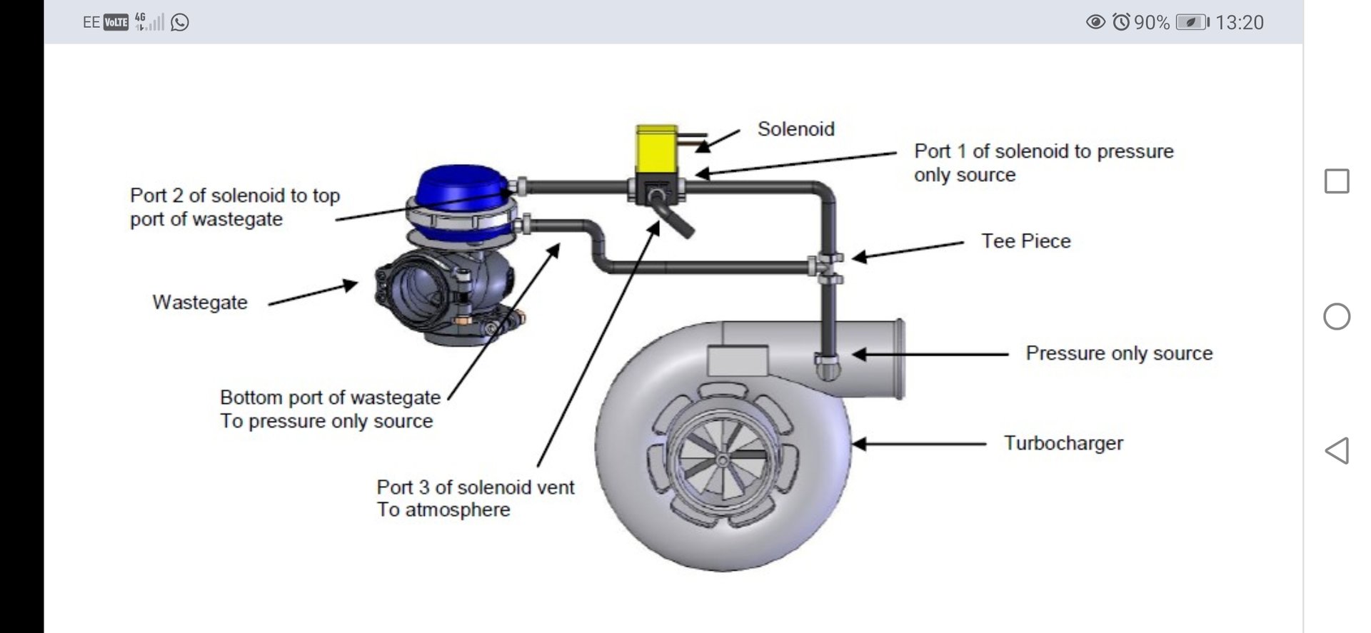

Hi guys, just wondering how those of you running external wastegates have plumbed the boost lines on a 3 port solenoid. There's a couple of ways to do it I just want to know what works best for the application.
Ive plumbed mine this way

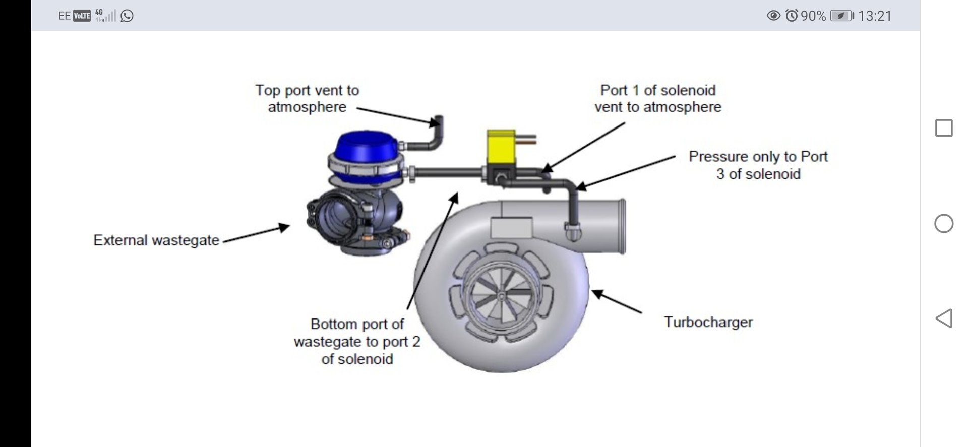

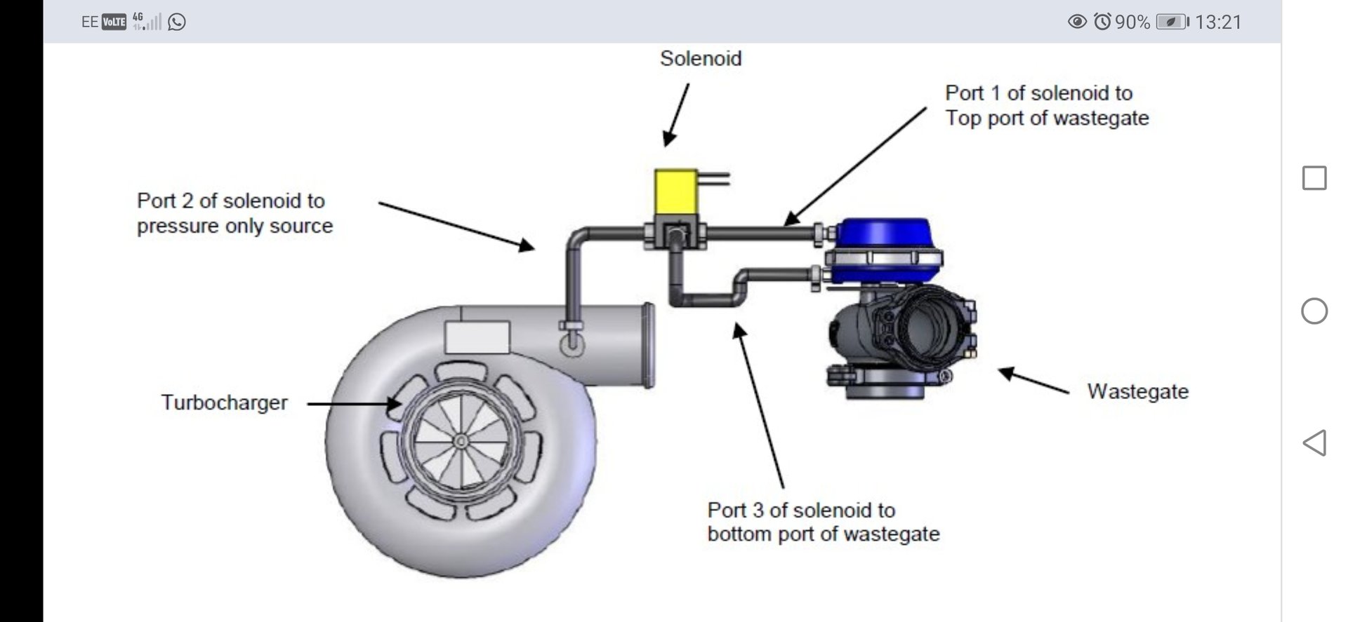

but there's two other ways. These are off the turbosmart website.
any advice appreciated.

This is the way mine is plumbed, absolutely no boost control issues with a Mac 3 port solenoid
