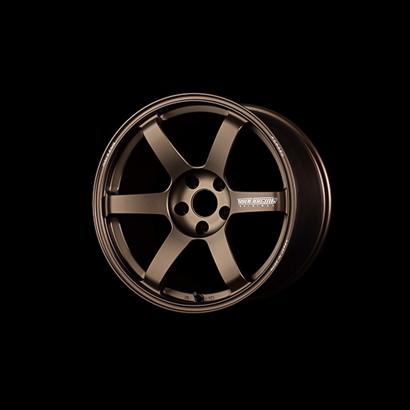

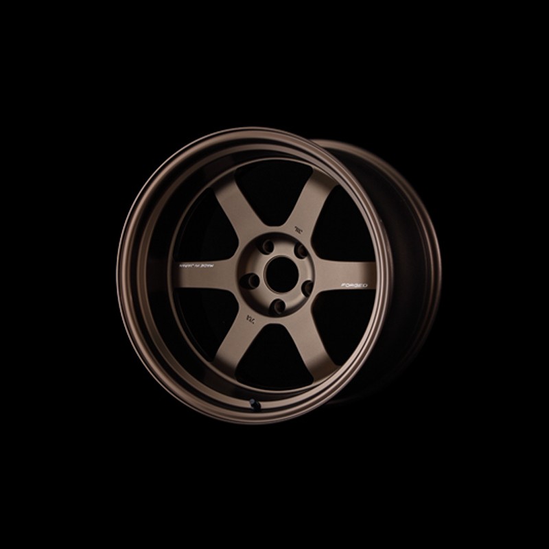

Right I need some help with fitment I've currently got some xxr 551 wheels which are 18x 9.75 et36 I believe Im Wanting to fit some te37s on the front in 18x9.5 et 22 I've also got feed arches in the rear I want to fit some te37 v mk2s in 18x10 et25 I've already rolled my arches and have around 15-20 mm gap does any have an idea if they will fit Ive done the calculations on will it fit and I think they will just need an opinion or should I just do normal te37s all round
If you use Willtheyfit.com and then go out and use a tape measure you should get a good idea for fitment.
Currently if you are running 18x10 et36 and then move to a 18x10.5 et25 then the wheel will stick out 17mm more
I've fitted an 10.5 ET15 rear with 265 at the rear - should be alright if you've got an aggressive roll and arent too low
