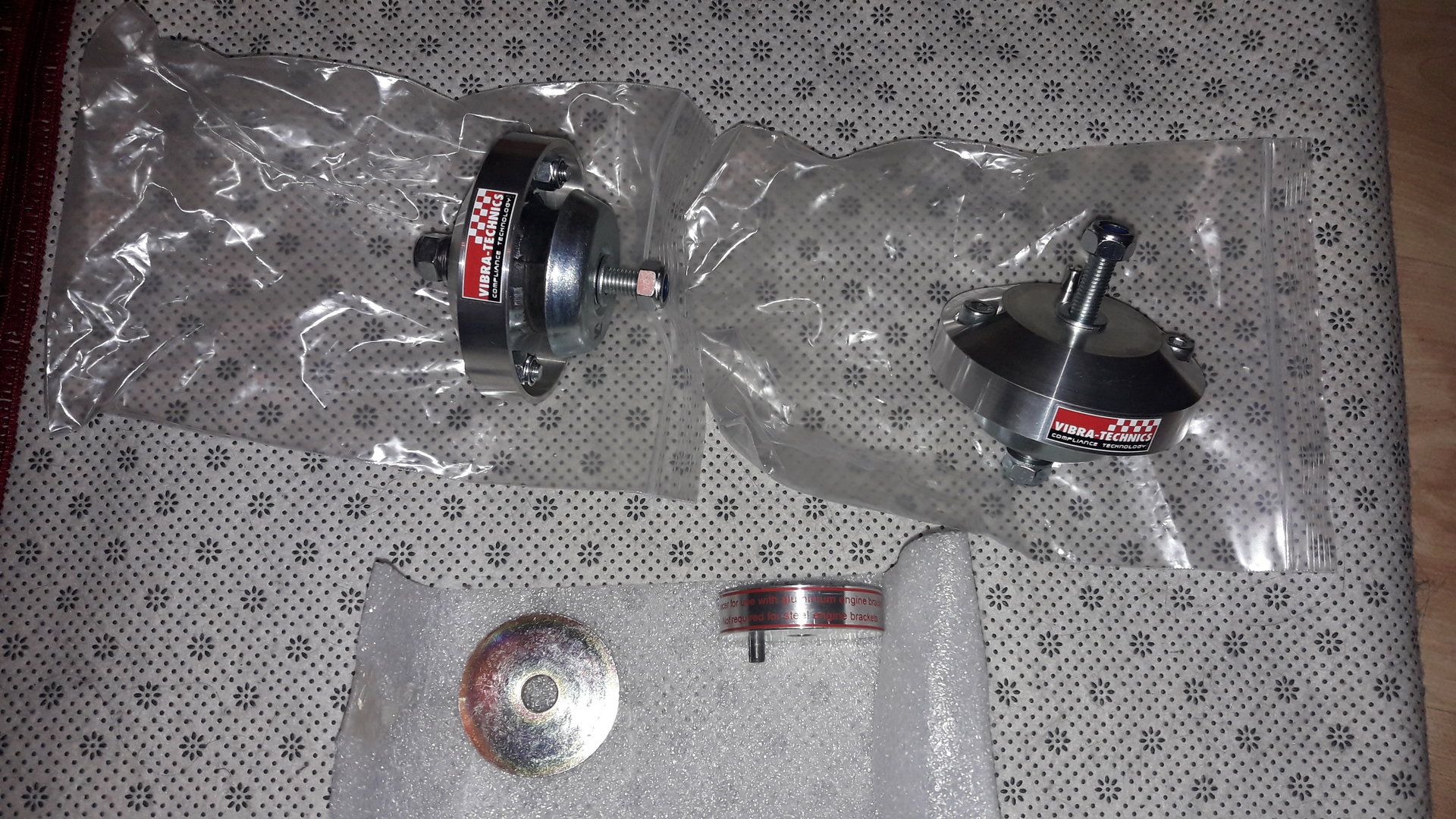

What mounts to do fit in replacement?

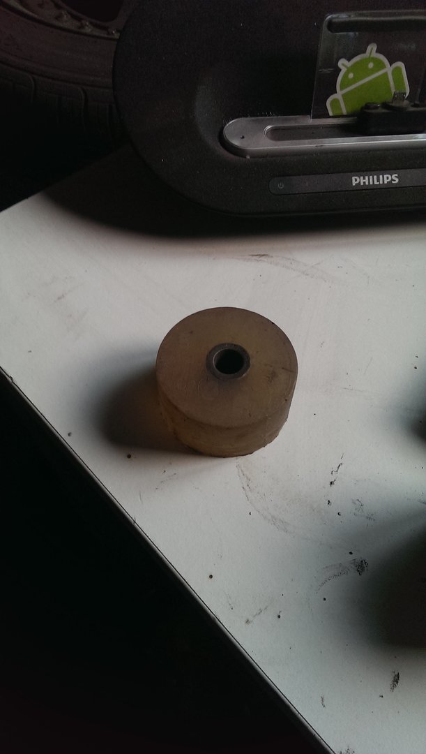

I used the poly landrover ones nas recommended. They are very good
I shelled out for the vibratechnic ones but they were defective (lots of play) and the company didn't honour it.
