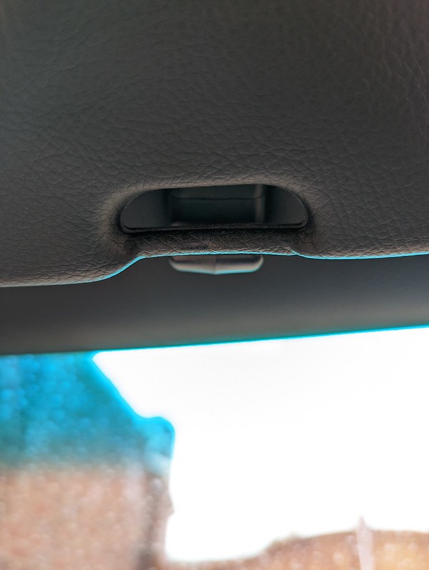

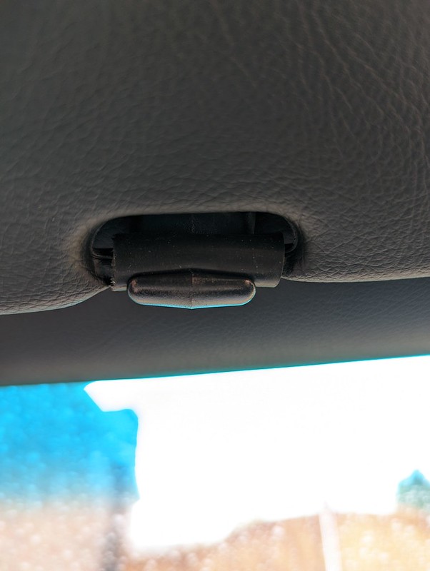

If anyone searches for this and wants a bit of an engineering workaround this is what I did.
I purchased some of this https://www.amazon.co.uk/gp/product/B0B15NPKJD/ref=ppx_yo_dt_b_asin_title_o00_s00?ie=UTF8&psc=1
If that link decides to break, 6mm internal diameter, 2.5mm wall thickness black silicone vaccum hose. Cut it to 34mm and slice down the length of it. Slide over sunvisor barrel and hey presto. Sunvisor clips in nicely, and swivels.
Before:
After
After fitting, I didn't have any to hand but you can always pop a few drops of superglue into the slice just to secure it.
