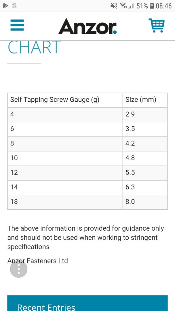

Caine_1989 Well-known member Joined Apr 11, 2018 Messages 613 Aug 23, 2018 #3 Sorry should of said that i bought the 8g ones theres a gauge to mm chart if it helps

Paulm Well-known member Joined Jan 23, 2018 Messages 1,006 Sep 6, 2018 #6 I alsp bought rhe 8g ones, seem a bit small so got the 10 x 16mm, these seem bang on
