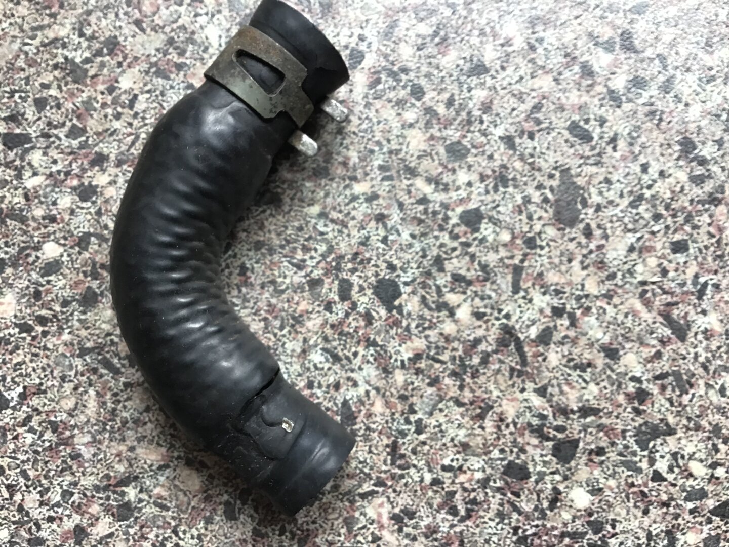

Any ideas where I can get the small formed elbow that goes from under the Throttle body , to the back of the throttle body ,
Would Mazda still carry it ? Mine split and decided to Jet wash the top of the engine lol
N3A113681A
In terms of mazda carrying it - email your local dealer that reference if thats the correct pipe to see if they have it

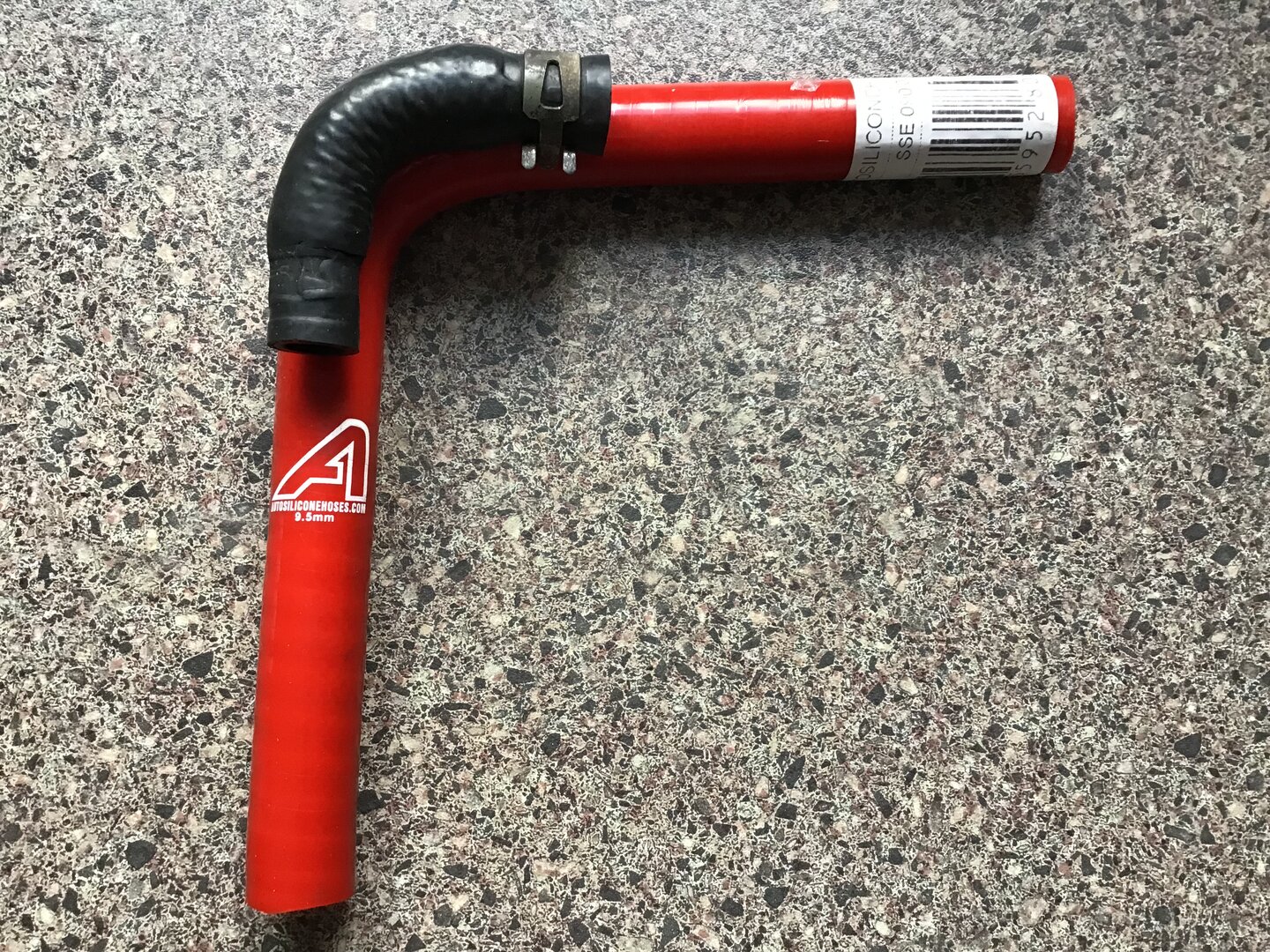

Sorted , less than a tenner, will cut quite a bit longer than the old one as well, wish I had done it years ago, could of easily cost me the engine when it split 🤔
Ahh you’ve reminded me I was going to put a post up about this I changed this one and the one from the filler neck at the front using cut down versions of these.
I went with the more OEM rubber hose.
RRH090010-ASH
