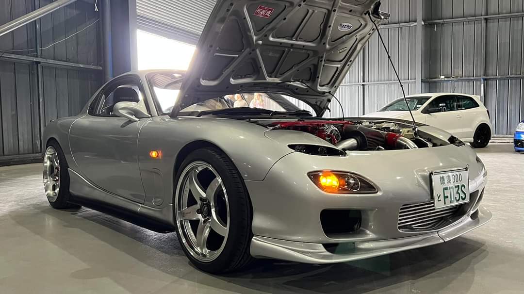

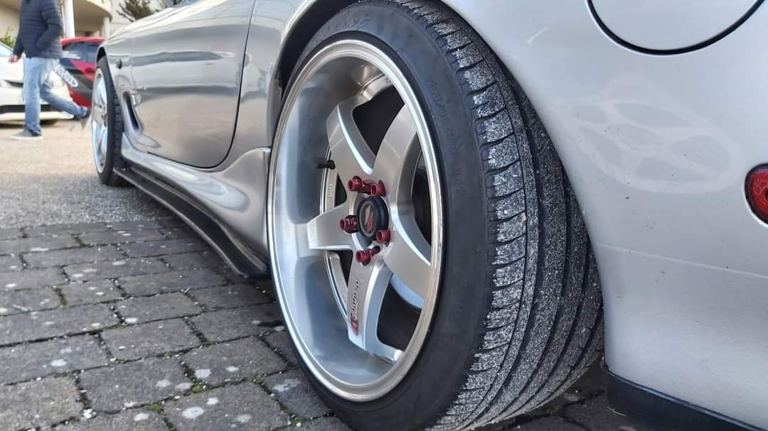

Hey guys,
I need to replace all my tyres and have a staggered setup
Front 18x8.5 with 20mm spacers (current tyre 225/40/R18)
Rear 18x10 with 25mm spacers (current tyre 255/35/R18)
Rear arches slightly rolled
Tyres are Nankang NS-20's and the rear are somewhat stretched.
My question is can you great people recommend a good value all weather (no track use) for a few spirited drives.
Also the best fit (was thinking 265 on the rear)?
Maybe a bit more rubber on the front (could I stretch to 235)?
Sorry if I've put too much info in, just wanted to make sure everything was included 🙂

Sorry @AndyD1969 for partially jumping your thread, I’m in a similar boat and can’t seem to make my mind up 😂 my new alloys are strangely square 9j +20 et 18” the tyres the previous owner ran were
235/40/18 fronts were a bit stretched not sure about it really prefer proper fitment
255/35/18
