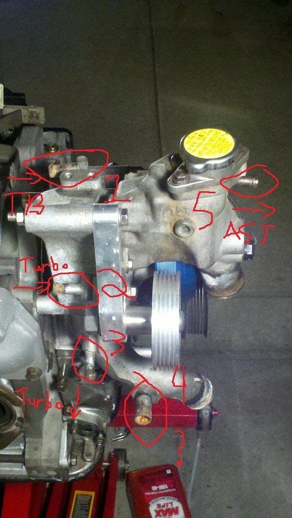

I cant decide if i am just having a brain fart or i really am missing something.
I'm pretty sure i've got the AST piped up correctly. pipe from outlet 5 in photo to middle of AST, pipe from bottom of AST to outlet on bottom of radiator.
i'm stuck with where i need to plumb outlet 3 in photo to as i've got a single turbo.
Outlet 2 in blanked off
outlets 1 and 4 go to hardlines
What am i missing?
Plum 3 to your turbo if its water cooled, if not blank off.
Awesome cheers both.
Any reason not to loop 3 into 2?
You can loop them if you want but it usually looks cleaner to blank both off. Also depending on your turbo placement you might not have much room. From a operational perspective it makes no difference either way.
