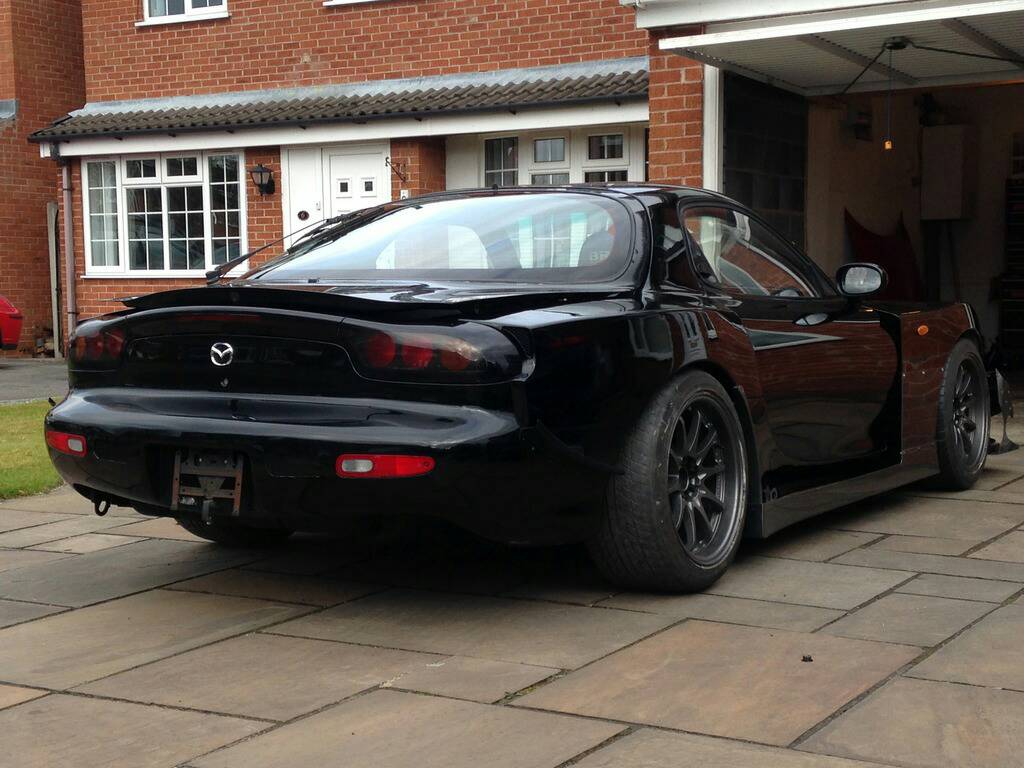

Who ever purchased the old raptor car had them fitted, 17" as well let me see if I can find a picture for you.
Cool, thanks. They look pretty good. Not sure if i would be able to get the same dish on stock arches. You remember what width and offset they are?

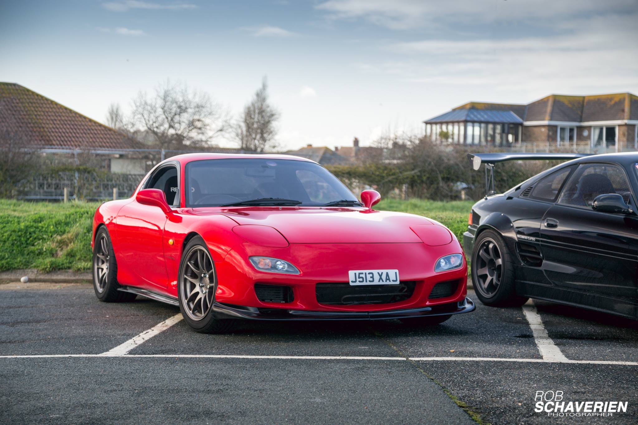

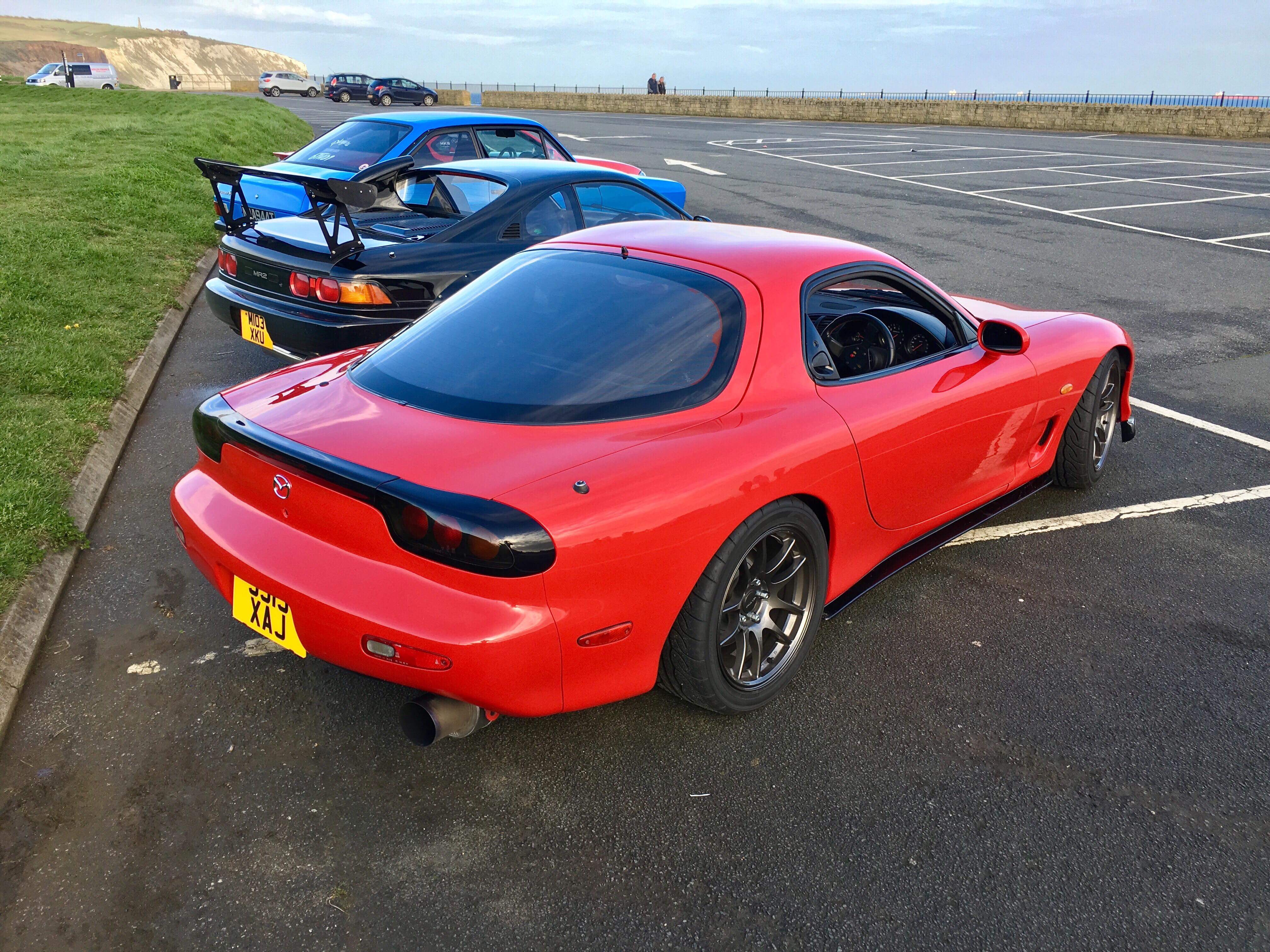

I know they arent the wheels youre asking for but these are similar fitment with slightly rolled arches.
17x9 et35 all round with a 4mm spacer front and rear
Also I have 17 x 9.5 et20 rear and 17 x 9 at et25 front on standard arches. Different wheels but no fitment issues

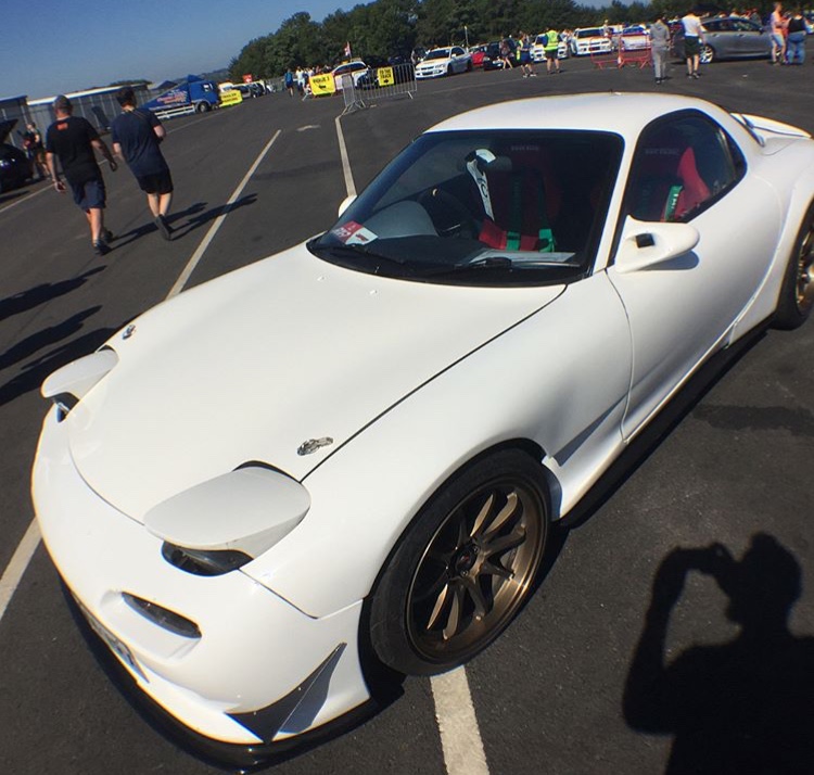

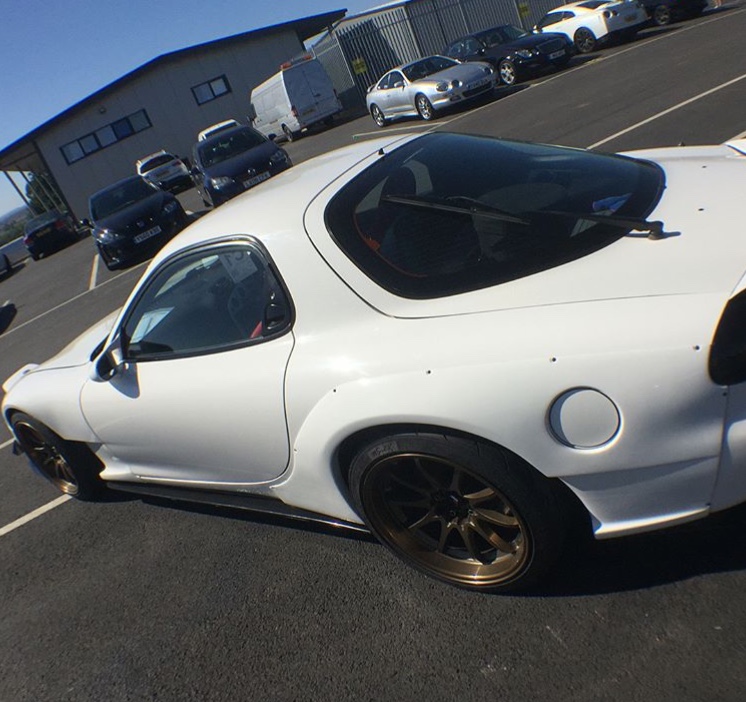

Here are mt jr5’s in 9.5x18” front and 10.5x18” rear
