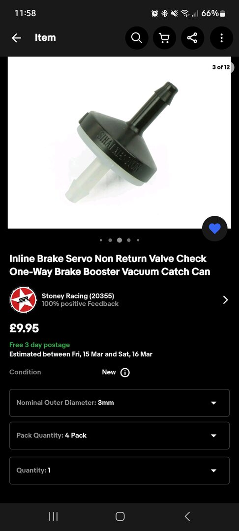

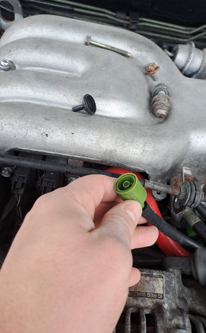

While working on the car yesterday noticed this was split in half, seen people recomend viton check valves but i cant seem to find any for sale or at any kind of reasonable price.
anyone have any other recommendations?.

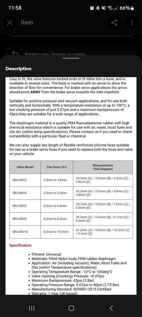

I found these online would they work?
Thanks
