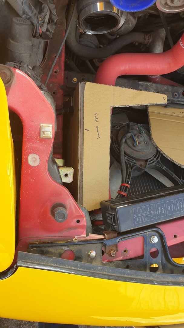

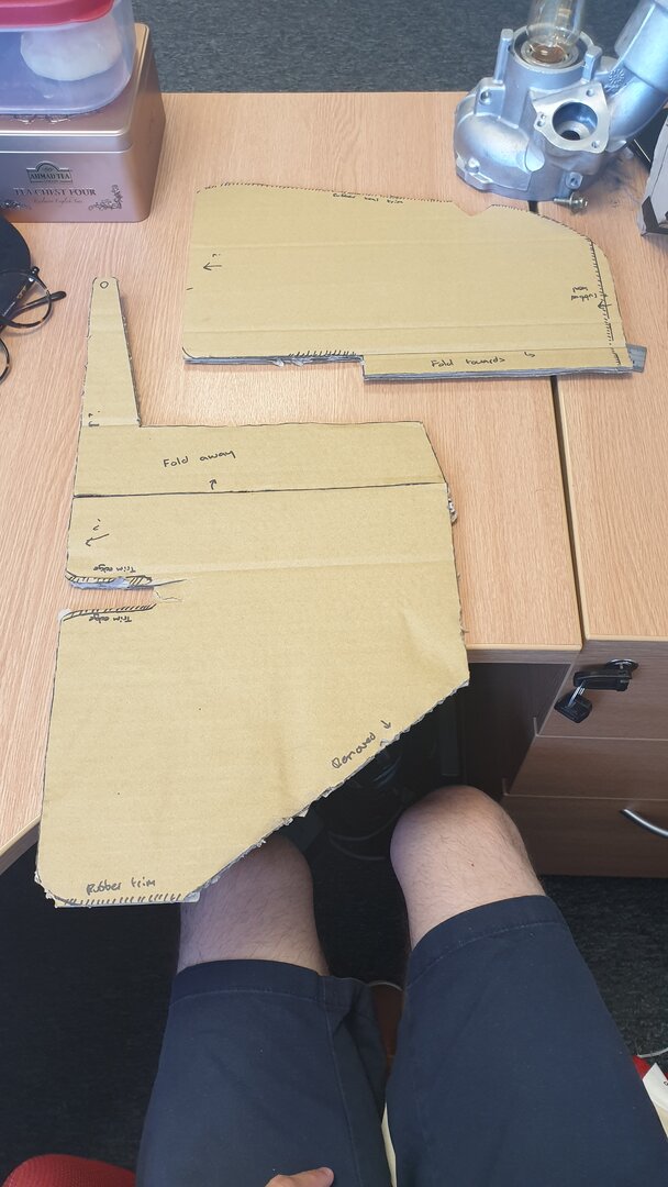

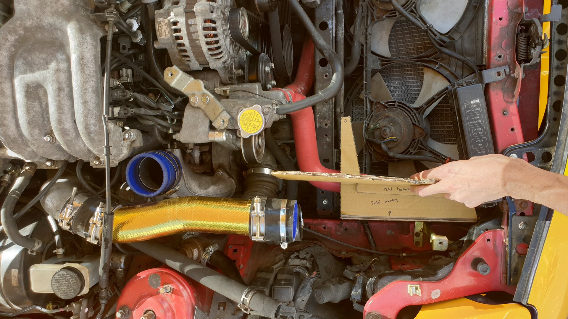

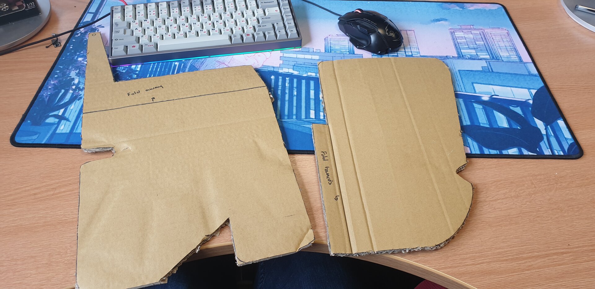

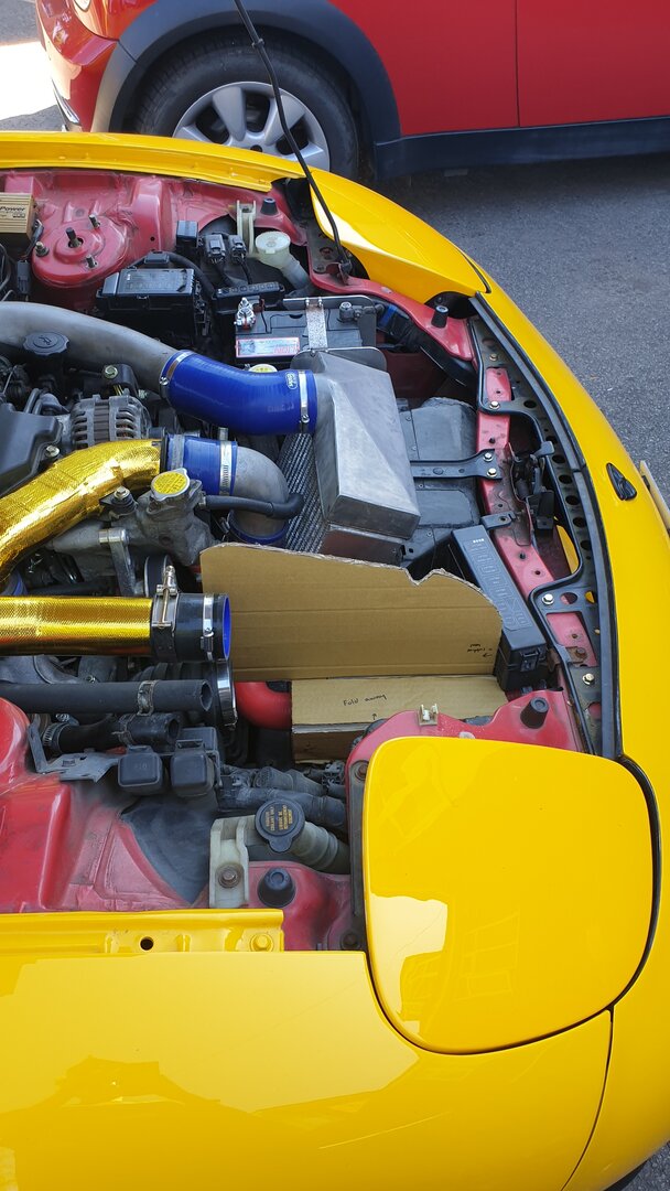

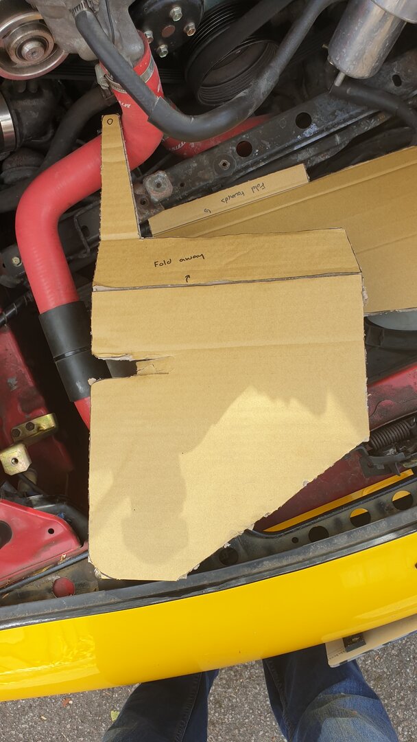

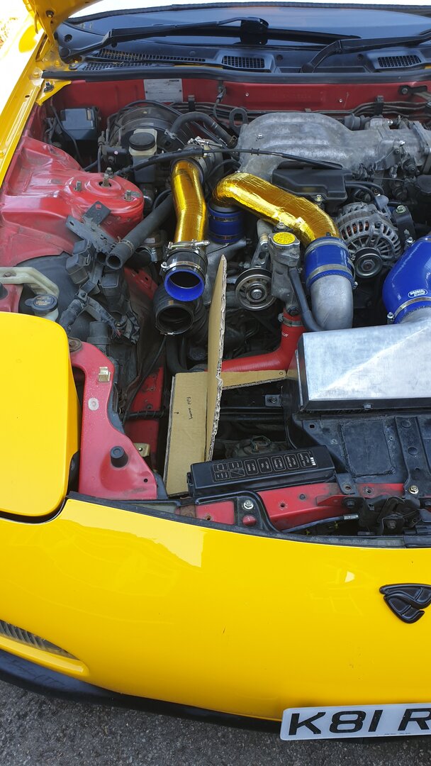

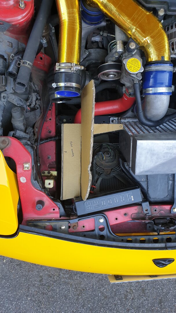

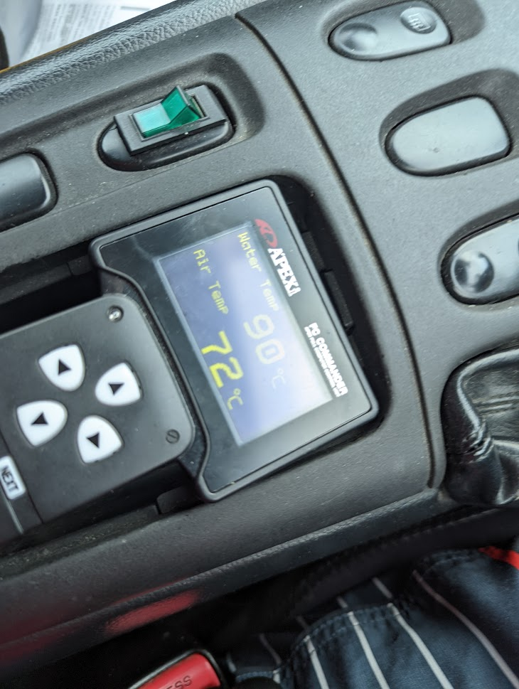

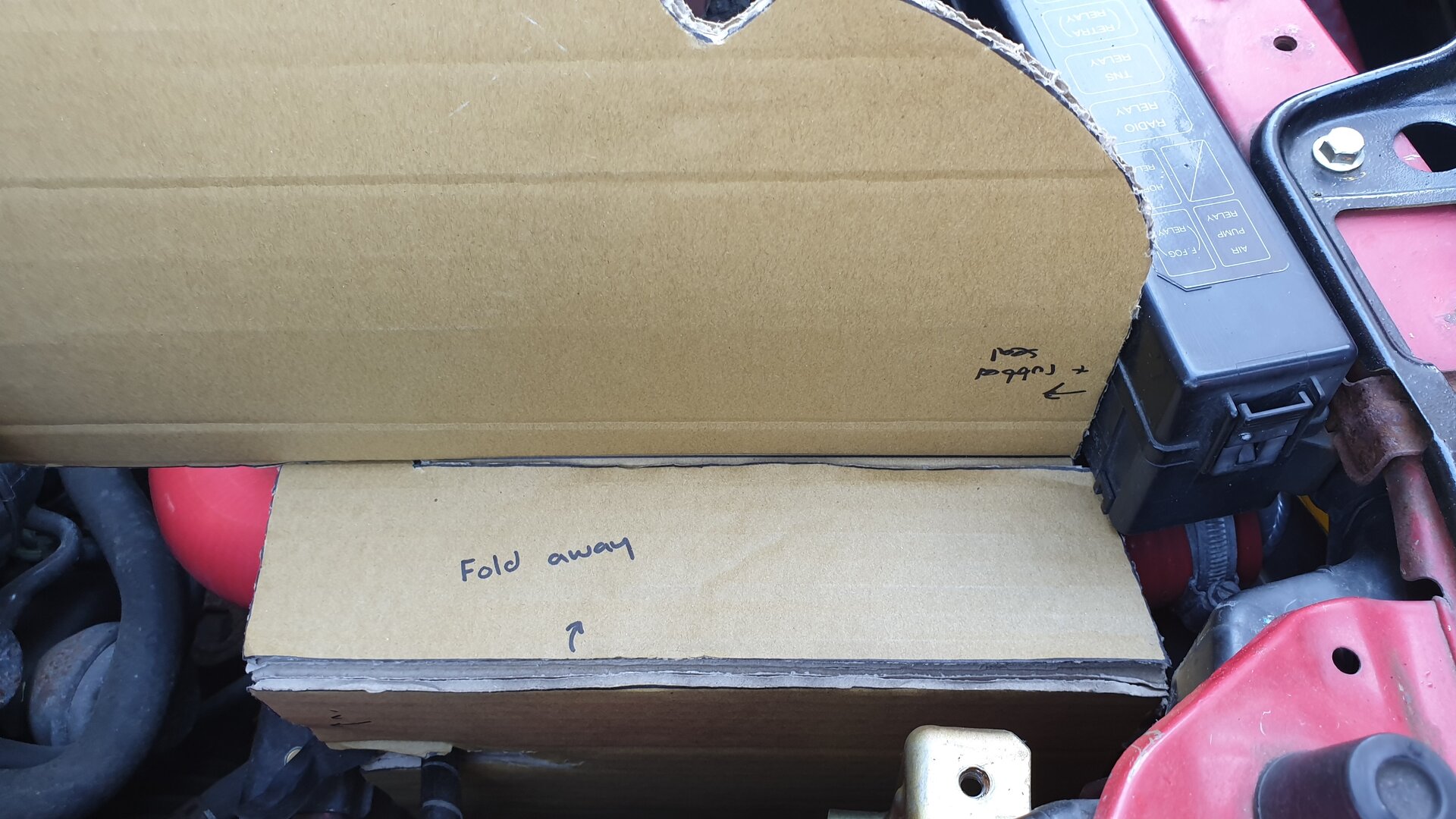

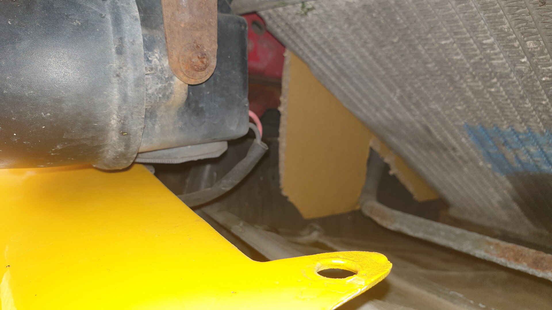

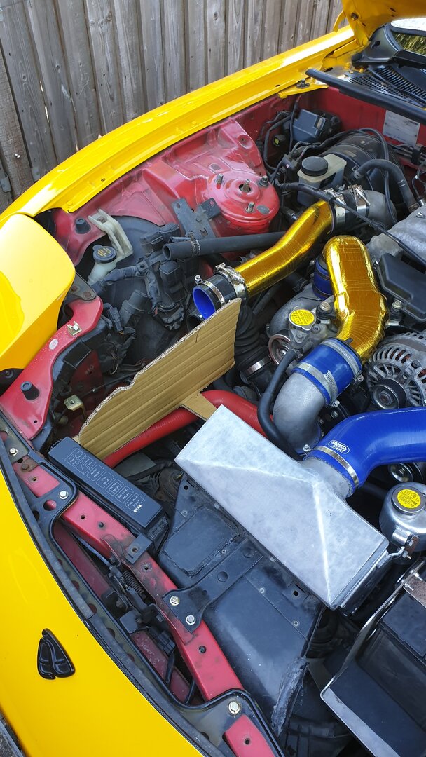

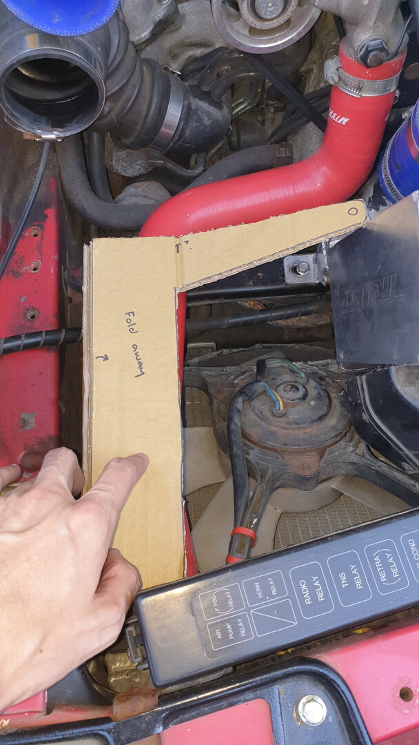

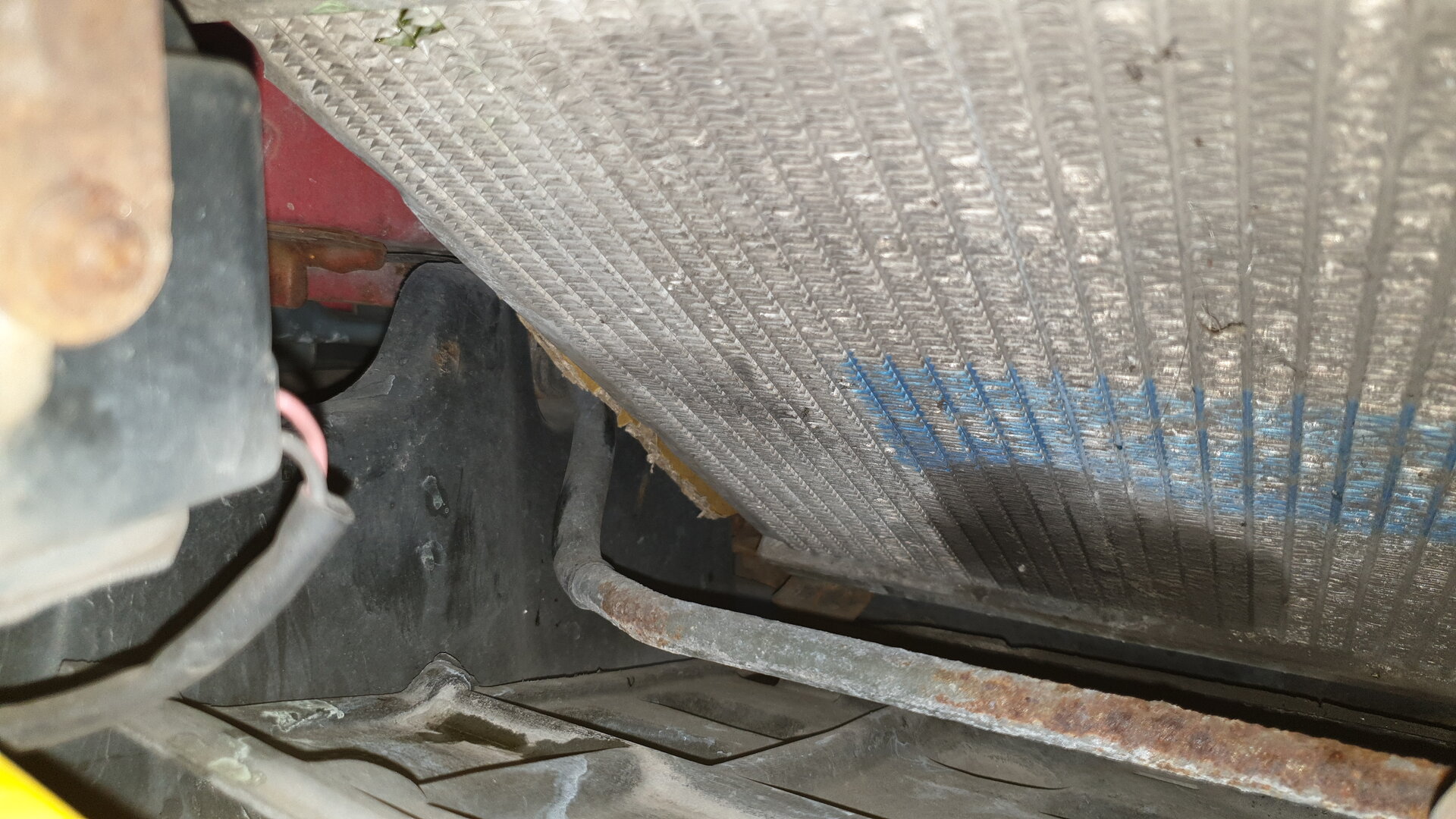

Installed and tested. Same cruise temperatures as the ARC box (really limited by the IC setup), but I feel like when stopped at lights the intake temps heat up slower and recover faster due to the separation. The seal fits really well against the fuse box and bonnet so I'm happy with the adjustments I made. Probably cost me £30 overall!
