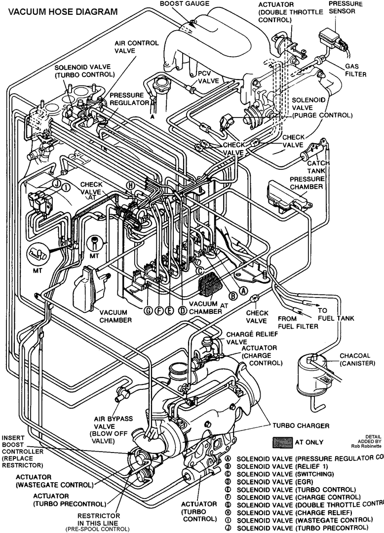

I checked for leaks by vaping into the UIM via the brake servo vac line, no obvious leak there.
The troubleshooting continues
