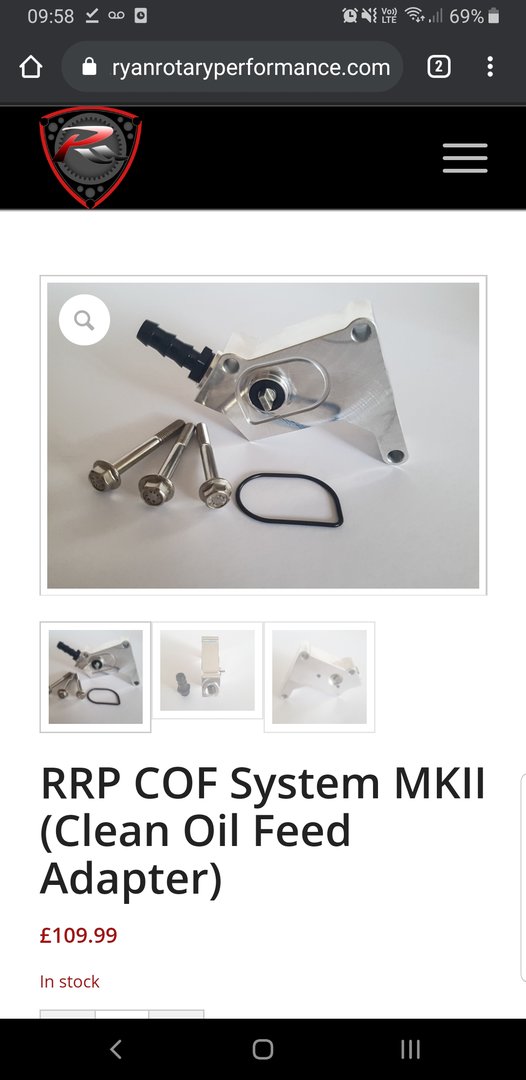

Hi all.
Looking at fitting a Ryan Rotary oil metering pump kit.
1. Will it suit stock twin turbo? Is there enough room for the sand
2. Will it suit the 13b-REW motor??
Have a read here, https://www.rotaryaviation.com/store/p6/Oil_Metering_Pump_Adapters.html
It always seemed to making sure the tank had enough head height to guarantee supply (plus you will want a level alarm too)
Shaun
Hi Shaun,
I know about the rotary aviation pump, I'm just fed up of paying the import duty for US.
I personally like the idea of it, with a level sensor and regular maintenance I don't think it will be anymore of a hindrance that the stock item.
I was just making sure the one pictured is the right shape for a Twin 13BREW and would actually fit in the space available.
Cheers
Not sure if the Renesis and REW OMP bolt pattern is the same, have you emailed Ryan Rotary?
