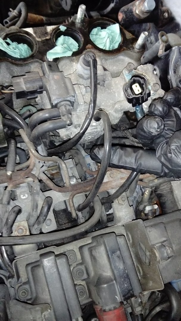

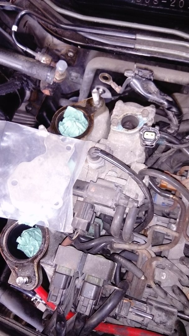

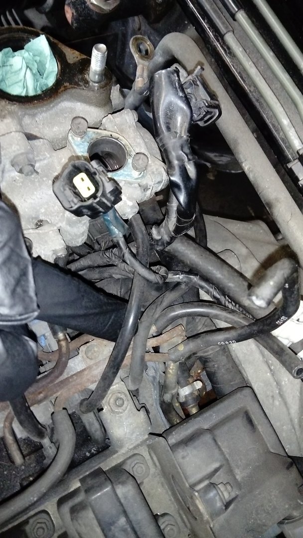

Hi all, I have a few questions regarding air pump system removal. I've got the blanking kit and see that you remove a unit thats on the side of the LIM
Once removed I am left with a sensor? And 2 vacuum hoses. What should I do with these. I will be running an apexi PFC ecu if this matters?
Tia
Just plug the vaccuum lines so no leaks.
And bin the sensor (assuming your talking about the one mounted to the air pump thing).

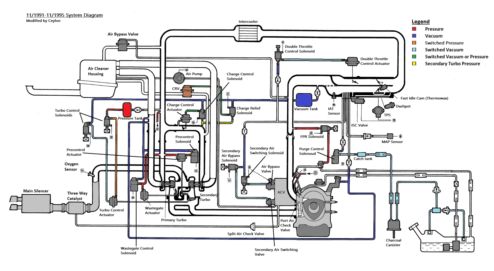

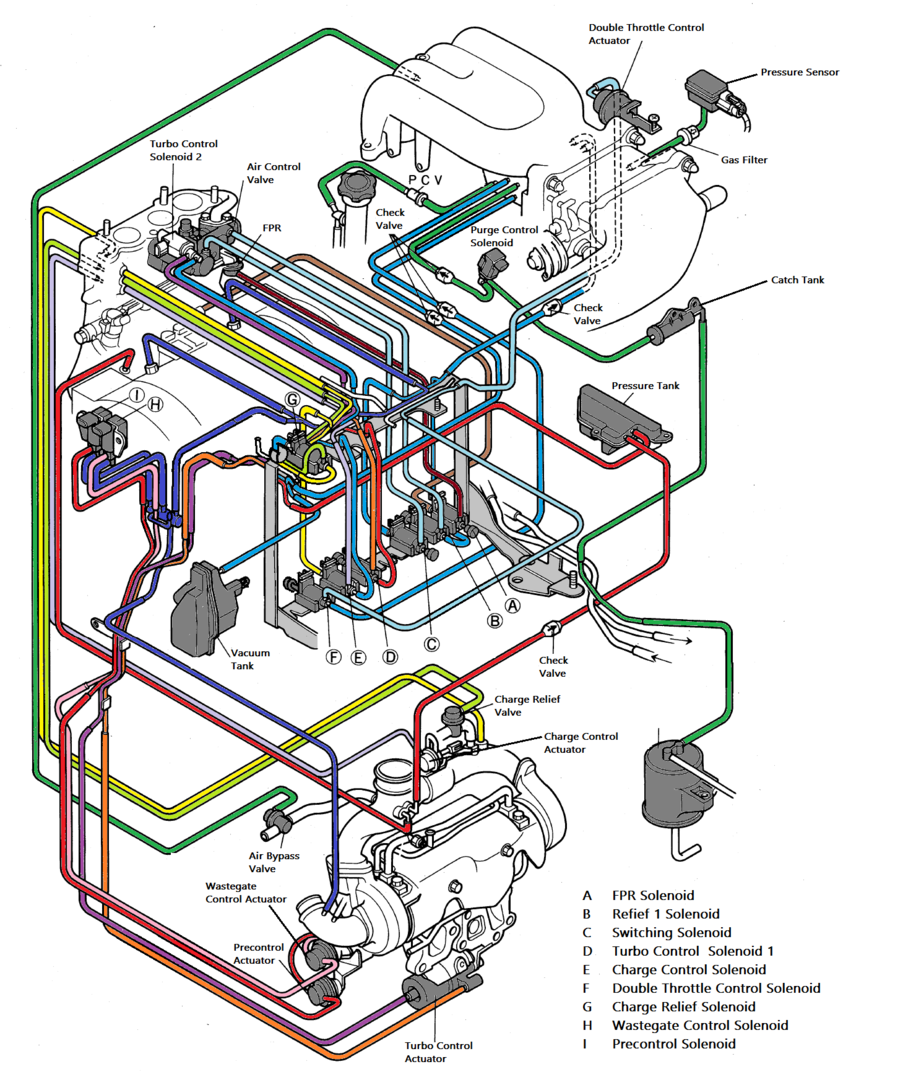

You can also lose the two solenoids, associated vac hose and check valve (y).
You'll need to retain the turbo control 2 solenoid that is currently bolted to the ACV, relocate it somewhere nearby or mount it in the rack.

Thanks guys! Ill make a little bracket up for the turbo control 2 solenoid in that case. Those diagrams will definitely come in handy , cheers (y)
