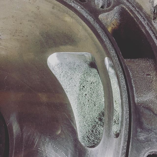

13brew half bridge ported

I have dipped to the darkside. Ive also half bridged my rex. Cant wait to hear it brap.
